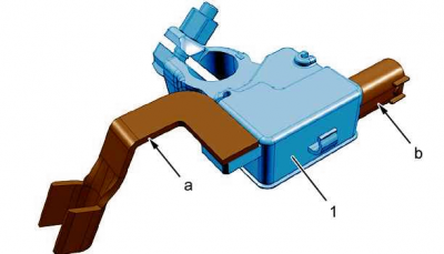

Your Economy mode is something you'll have to live with, as unlike earlier C5s the time before Economy Mode engages is controlled by the BSI from information it received from a little unit you have called the Battery Charge Status Unit attached to the negative battery terminal.
This little device monitors the charge in the battery, the temperature and can trigger the LIN to 'poll' the battery at certain intervals when the car is asleep to determine charge levels. All this info will determine how long you can operate equipment without the engine running.
The C5 and especially the X7 with Hydraulic suspension is very battery power hungry, with some systems actively monitoring the car even when it is shut down.
A tip also for you - if you ever charge the battery, it is recommended that it is charged on the vehicle - but make sure that you attach the negative charging lead BEFORE the Battery Charge Status Unit, not directly onto the negative terminal. This is so the unit knows it is being charged and can factor that into any data it sends the BSI.
Here;s a few pics of this magic unit:
Always attach the battery charger negative clamp to 'a' on the Battery Charge Status Unit when charging. | Here it is on the Battery. (and that's copper grease by the way not rust ) |
