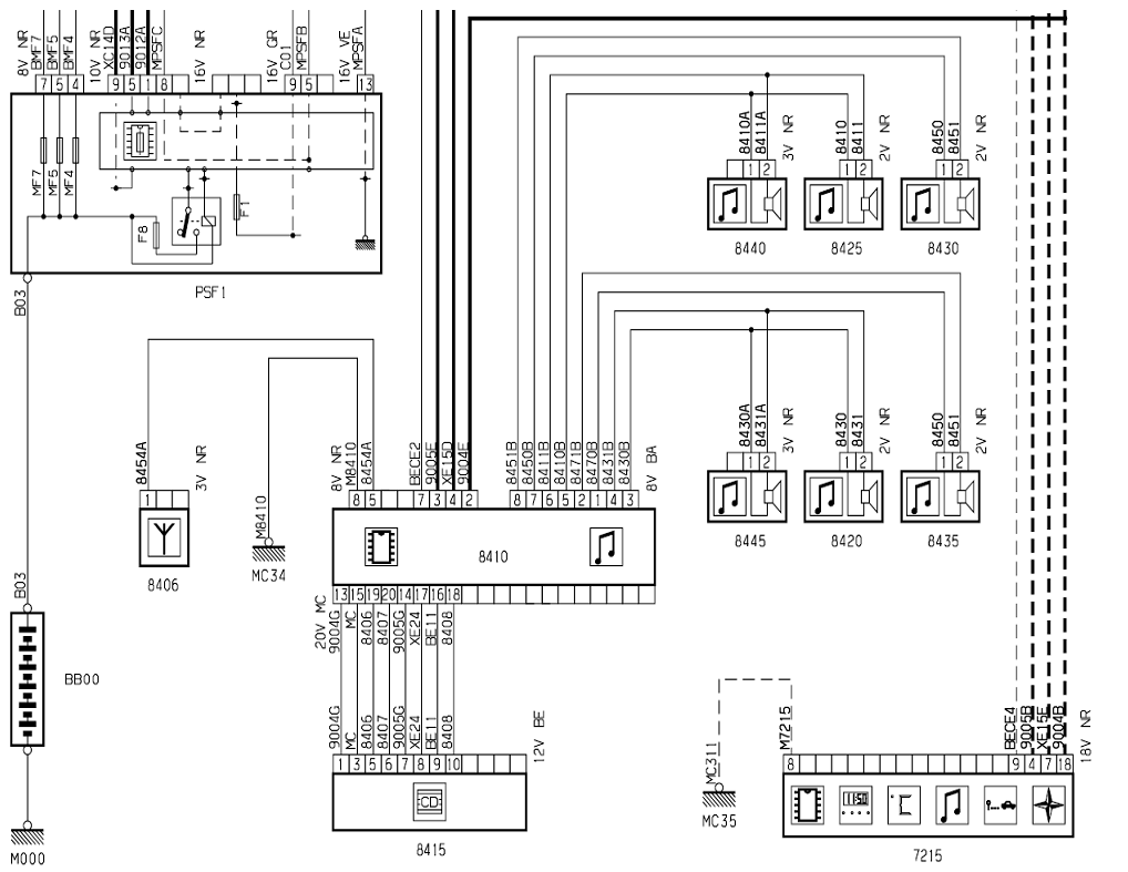

Not much help here I'm afraid Jonathan - it's actually an RD3 unit you have not an RD4 which came out on the MK II.
On the diagram, 8410 is the Head Unit. Ignore the lower connection to the CD - you don't have that option. But the the top connections don't show a lot, just the speaker connections and the main connection are the wires 9005E (VAN Data Bus B) and 9004E (VAN Data Bus), with the BECE2 being the power and XE15D a mystery.
The multifunction screen actually is in charge of most of the info including turning the radio on and off apparently.
This is the only diagram I have
