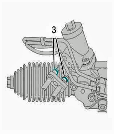

Unclamp the steering pipes near the valve.

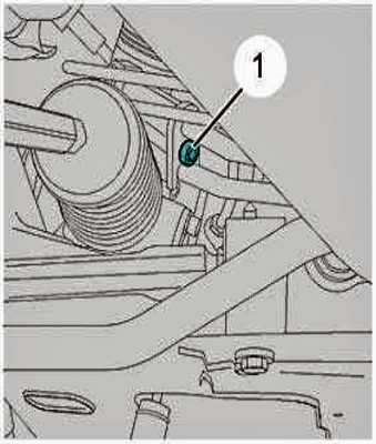

Remove bolts (1 ).

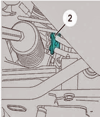

Using a lever, move aside the clamp ( 2 ) from the valve.
CAUTION: Take care not to damage the valve.
Direct the pipes into a container.
Turn the steering from lock to lock in each direction.
Wait for the oil to finish draining.
Refilling: Power steering hydraulic system
CAUTION: Work with care to avoid the entry of contaminating particles.

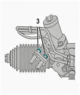

Refit the new seals ( 3 ).

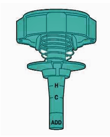

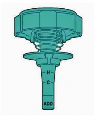

Top up the power steering reservoir level to the mark ( c ) on the cap.
With the engine not running, turn the steering slowly from lock to lock in both directions ( Approximately 10 times) .

Level: Power steering hydraulic system
(H): Maximum level ( Hot) .
(C): Maximum level ( Cold) .
(ADD): Level minimum.
The oil level must be checked/topped up with the engine off.

Initial Draining
Draining of the power steering hydraulic circuit must be carried out with the engine switched off.
Open the filler cap.
Remove bolts (1 ).
