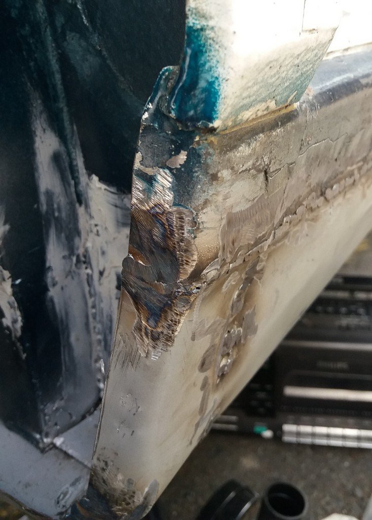

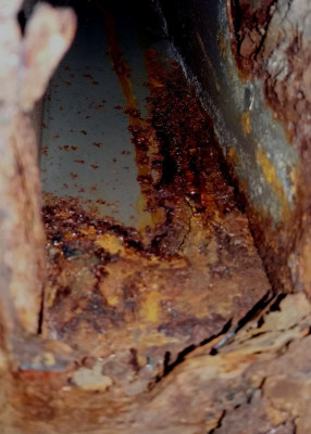

Meanwhile, its a lot worse than I thought, which is incredibly frustrating, I've made measurements from 'Zero Points' that are now useless and cut down my replacement section (that's going to have to be welded back to its original size). I might even have to chop out some of the inner cill.
Its all possible and I've got all the repair sections, but suddenly the job's got a whole lot bigger; should've known really.
Perhaps one of the Admins can change the title of this to 'Welding Blog' or similar, might need moving elsewhere on the boards, too

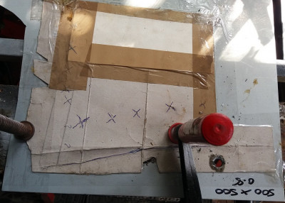

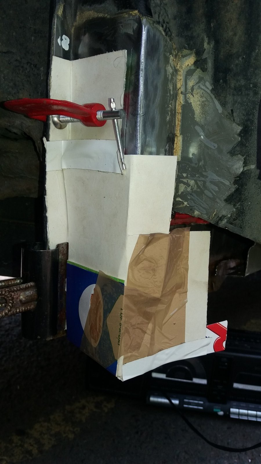

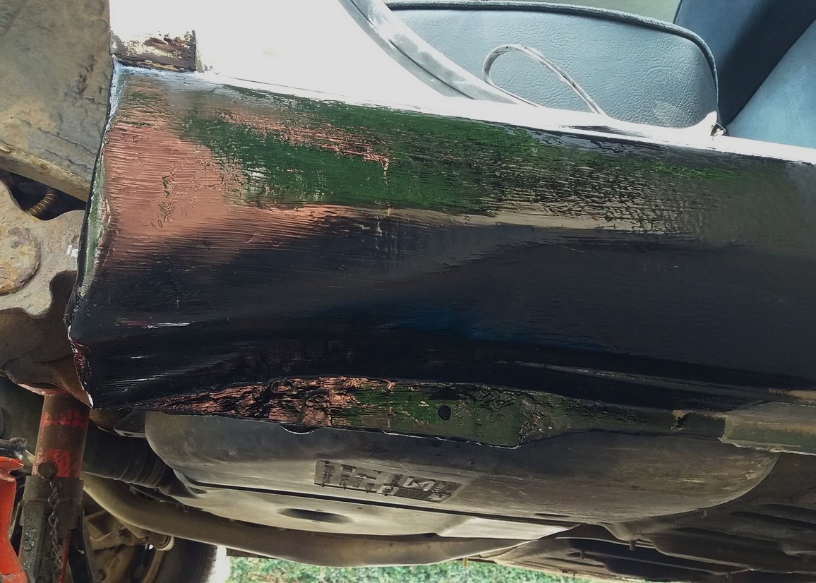

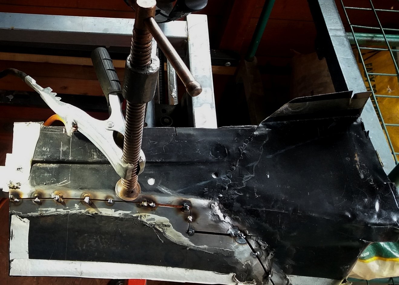

After a day off from it yesterday, things are going better.

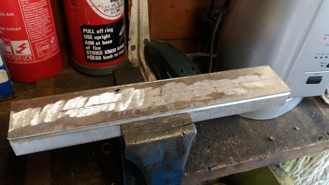

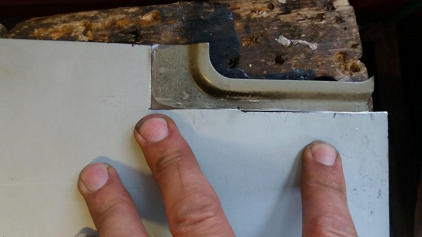

I've cut myself a new Heat-Sink, from what had once been a shower cubicle
and then having spent ages cleaning up the edges of the now too small replacement Outer Cill, always a long-winded & laborious task; welding it back together went pretty well, despite the enormous 1.3mm chasm which represents the loss in cutting.
Obviously, I shall be 'joining the Dots' for a continuous seam weld at a later point; but I'm happy with that for now. It'll need shortening in length and a lower flange adding at a future point.

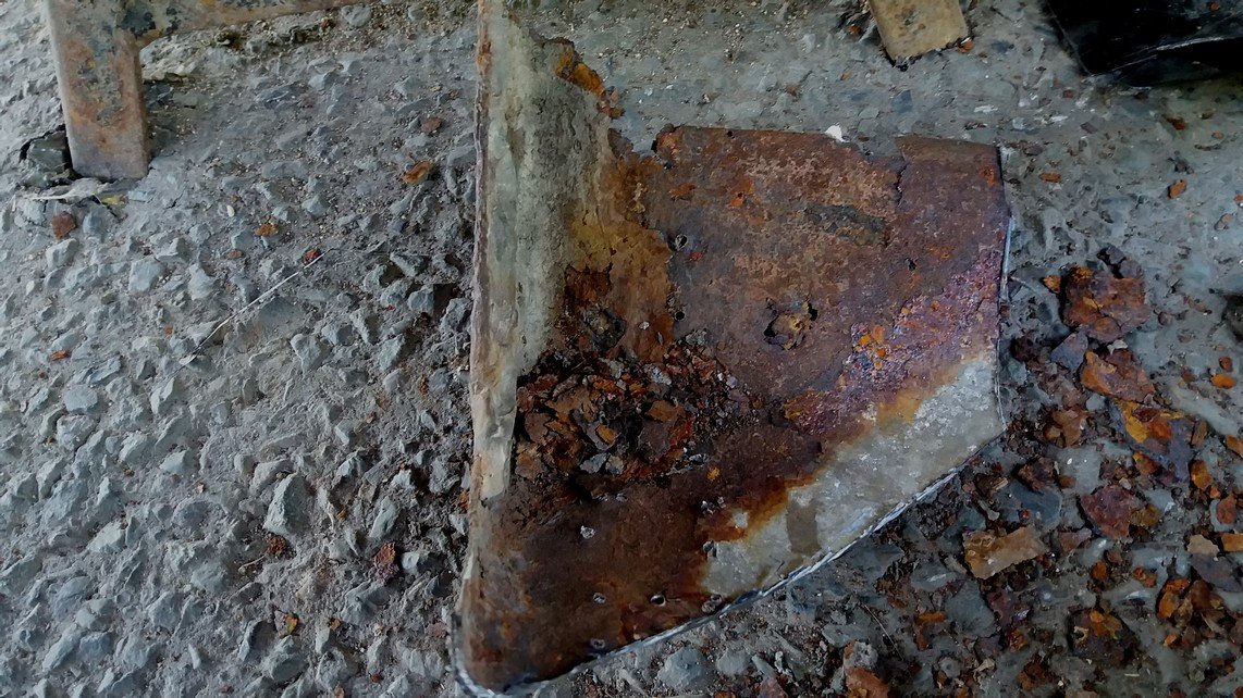

I moved on to cutting off more of the forward section of outer cill. Thankfully I only needed to remove a further 50mm approx to get to good sub-structure, and also cutting a further similar amount from the top (no pic).

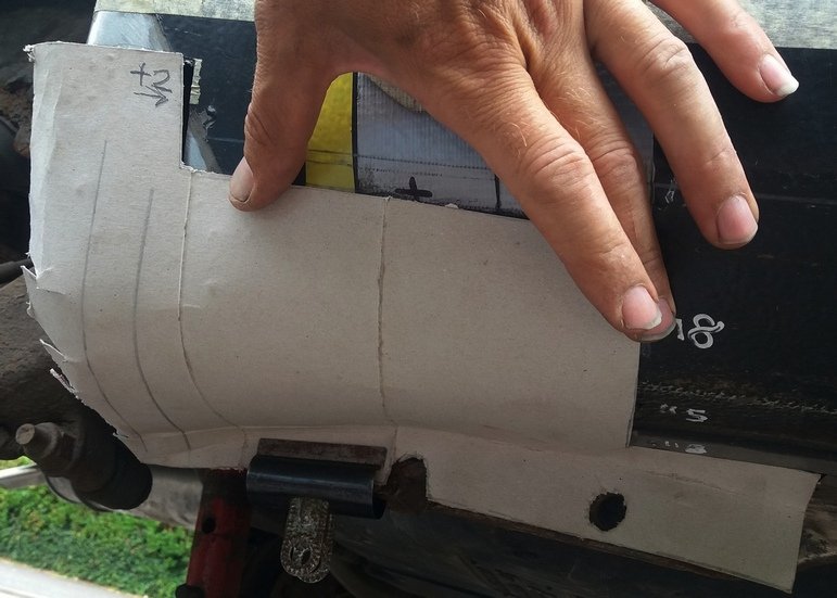

A Cardboard Template to represent the Outer has been made while the sub-structure's in place, but most of that will be going tomorrow.

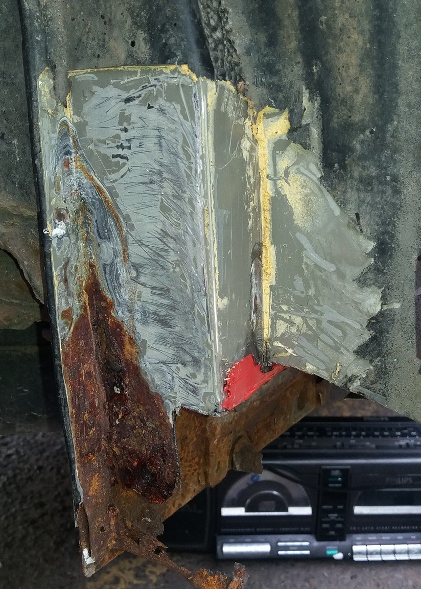

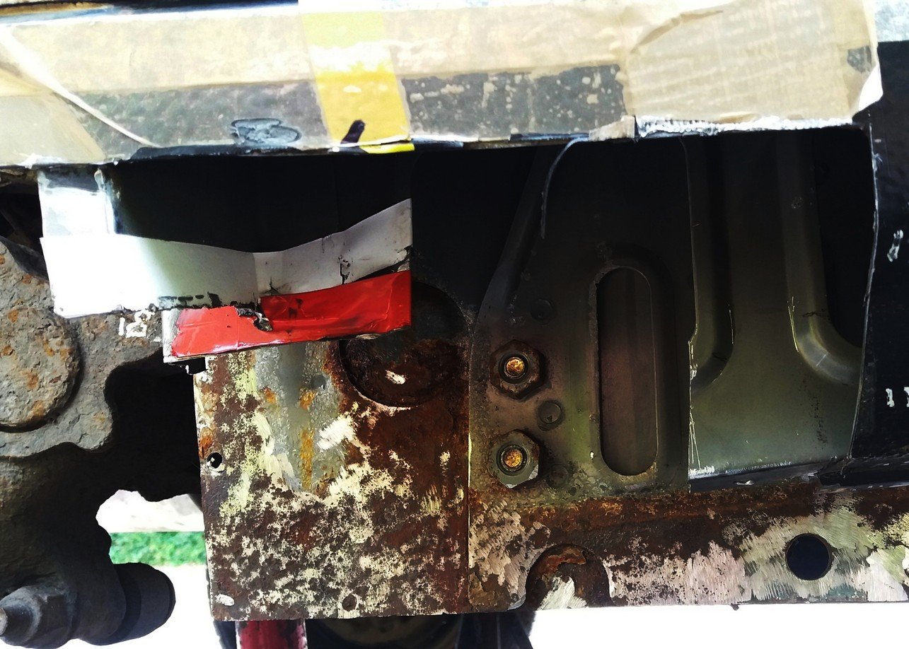

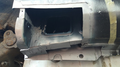

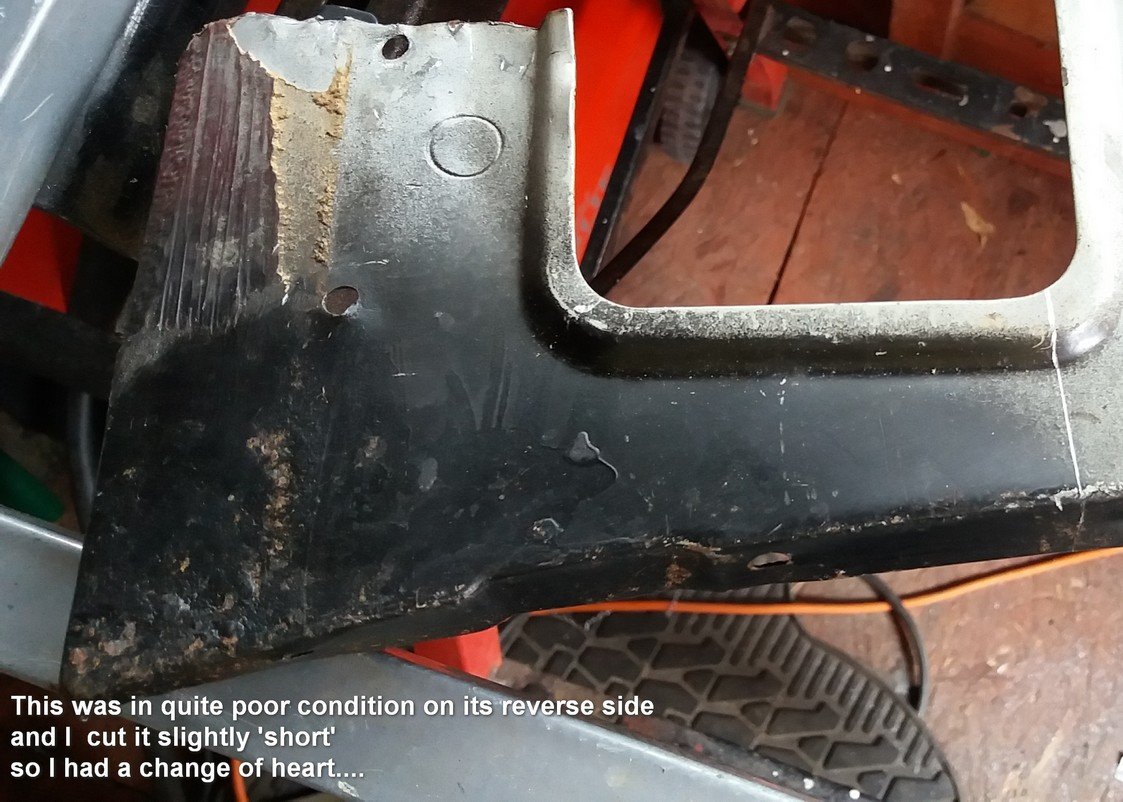

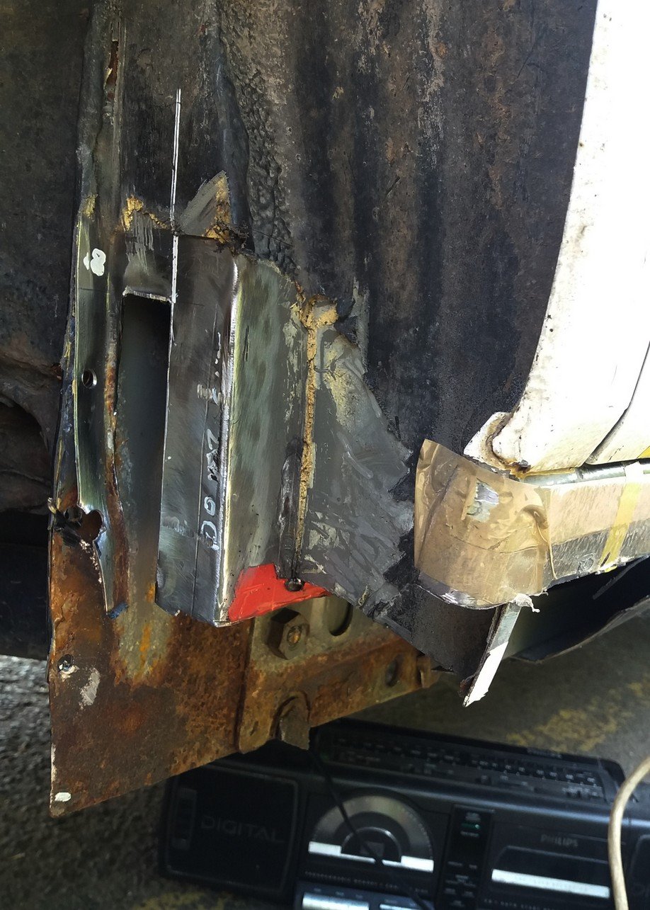

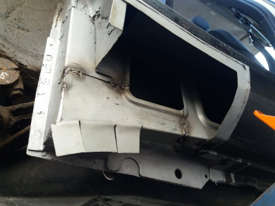

so its all change since the last posts.
The idea of using an Outer Cill comprised of at least three different pieces of metal, with a welded 'chasm' that simply can't be as little as the 1.3mm I suggested in the previous post, seemed faintly ridiculous, for the sake of a 'Step' in the panel....
...thankfully, after just a short period of experimentation its clear that the step can easily be removed from the tail end of the good outer cill, where it will meet the new metal; and this therefore permits the use of a simple piece of 0.9 galv sheet
I don't actually have a sufficiently large piece of steel as yet, but that'll probably arrive tomorrow; but the hole where the Cardboard Template for the Outer Cill has been enlarged.

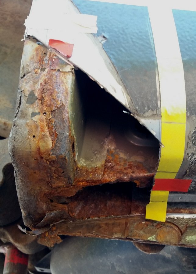

There's been quite a lot of 'making and enlarging of templates', as the extent of the rot requires; which has been the source of some irritation but I'm mindful that when I did the opposite side 18months ago, I had a much more relaxed approach to templates and zero points, and paid dearly for it; hopefully not going there again.
Templates have been made for 'the one I made earlier' Curved piece, the Sub-structure and the Inner Wheelarch section, all of which have been now been chopped out, so the grounds are pretty much ready for welding.
I did consider removing the Inner section, which would expose the Fuel Tank and Brake Pipes to view. I have a spare section, but that feels like going too far and my spare section isn't perfect either, so I've cleaned it up and bar a further pass or two with my various rust removal rotary tools, it'll be staying like that.
I've also so far got away with leaving the fuel tank in situ, and its likely that with appropriate protection I can leave it be, so that's played a part in my decision too.
I noted that the date thingummy on the Fuel Tank is in line with other parts on the car, albeit a little later, its stamped 1995, Week 27; where other fittings are generally labelled Jun 95, so it would appear to have been manufactured in early July, I'd guess the factory wouldn't want too many 16 Gallon fuel tanks taking up space so they'd be more likely than an Instrument panel, for instance, to be fitted promptly following manufacture. It was reg'd in Dec that year.
Less pleasingly, I note that once again the Brake Compensator Spring has fallen out of its housing and is dangling uselessly, a fiddly thing to refit, but I found last time that cable ties at either end of it will assist
and that the 'Turret' over the rear suspension bump stop is in desperate need of attention from my welder. I shall see how keen I'm feeling when its all back together.
Timescale is going well so far, we're up to about 6/7 days work and over half way, so that's reasonably satisfying too.
Oh... and for the first time in my ownership, its now on Axle Stands front & rear. I was a touch concerned about putting excessive load on the nearly new NSF front tyre while it was on just one stand, hence the stands
...and apologies fort the quality of the fourth pic, it was a bit over-exposed and my 'corrections' with Faststone haven't made it a thing of beauty.
Hard to believe all this palaver over what started out as a tiny patch of rust in the Wheelarch and some bubbling on the tail end of the Outer Cill.

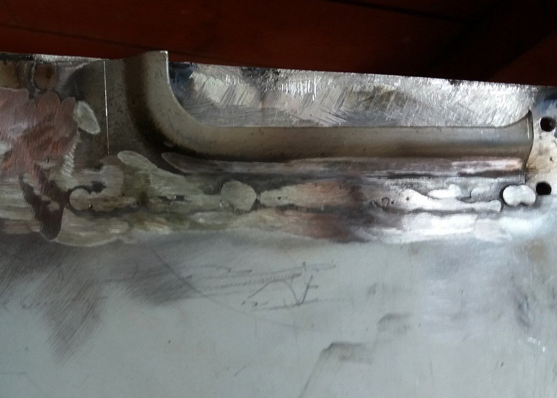

The metal turned up by post before I ran out of bits & pieces to get on with

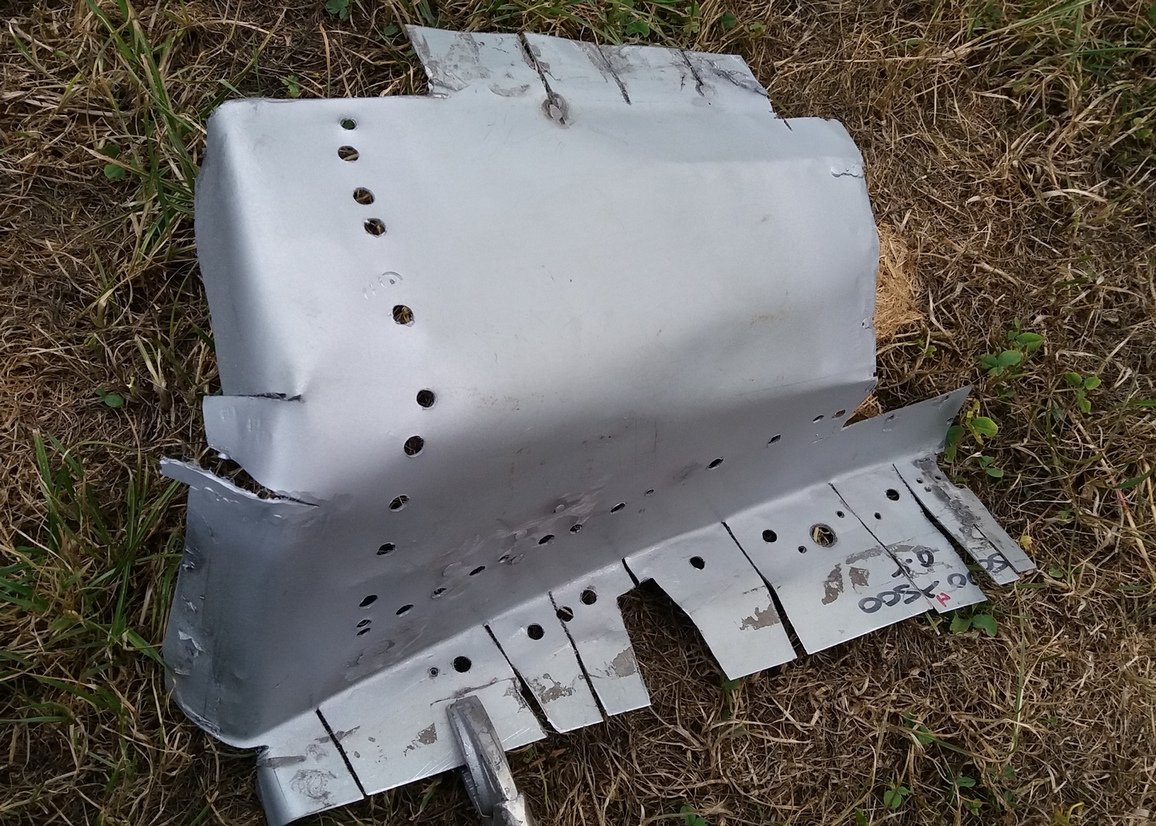

The first and most complicated of the panels has been made to template and fits really well
...and the second panel is well underway.
Would've preferred it rather less hot today, but you can't have it all.
I'm feeling like I'm 'on the Home Straight now' and feeling well happy about it. Projected maybe 4-5 days work remaining and a total spend of about £50, which includes a number of small tools / consumables, Gas, Wire and Metal. A couple of celebratory Beers this evening and a day off from it tomorrow!

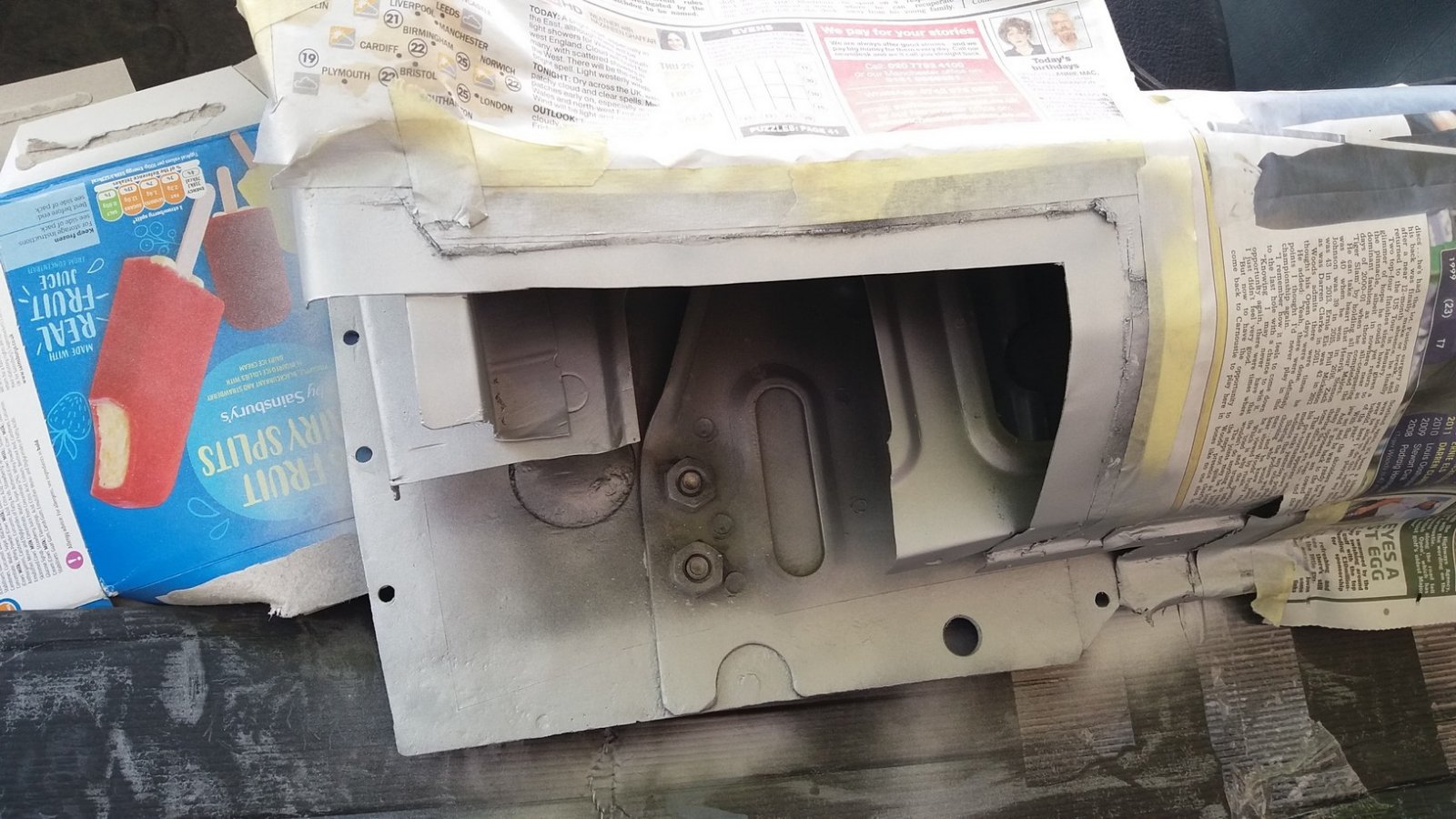

well, so much for the day off. I was up a little earlier than usual, the weather felt cool and the forecast was for today not to be as hot as the next few days, so the day off has been 'shunted' to Sunday.

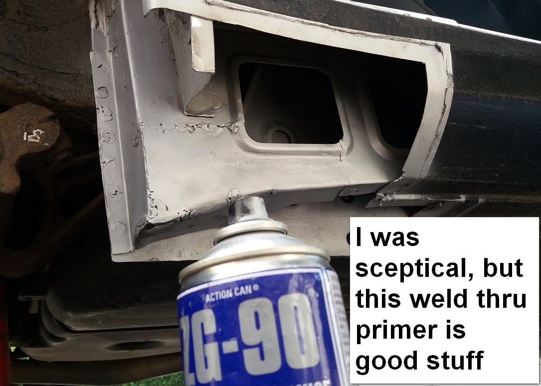

I've remade the sub-structure to a good standard, having changed my mind about using the secondhand bit that I've had a while
The Inner Wheelarch section is made & ready to go
The less than wonderful inner cill has been cleaned up to a reasonable standard and Kurusted where I won't be wanting to weld it
All the joints have been cleaned both sides and painted with XC-90 Weld Thru paint
And the Outer Cill section is well on its way.
Next up is temporary fixings

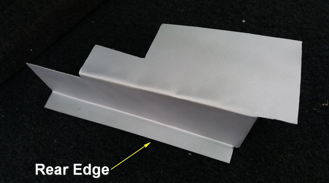

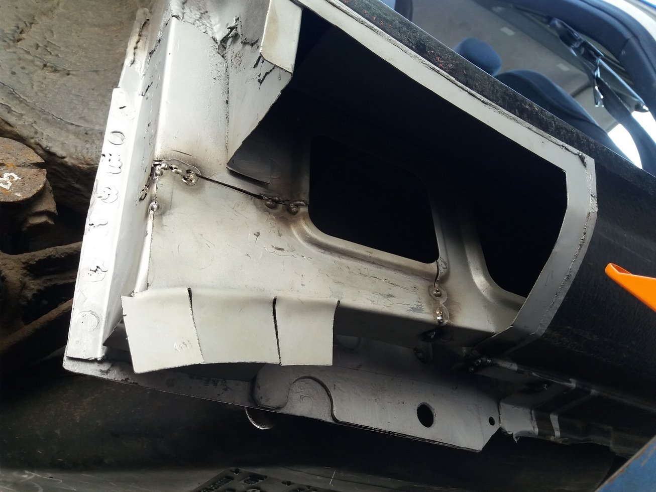

Inner wheelarch section in place (except for the non-standard 'return' on the bottom) and Sub-Structure tacked in place at the top, the fold at the bottom's not right yet.
The original sub-structure had a fold in it at the rear, but saw no reason to keep this, hence cutting it off more or less flush with the wheelarch section

Sometimes there are strange 'kinks' in the hidden metalwork of a car to help eliminate unforeseen harmonics.

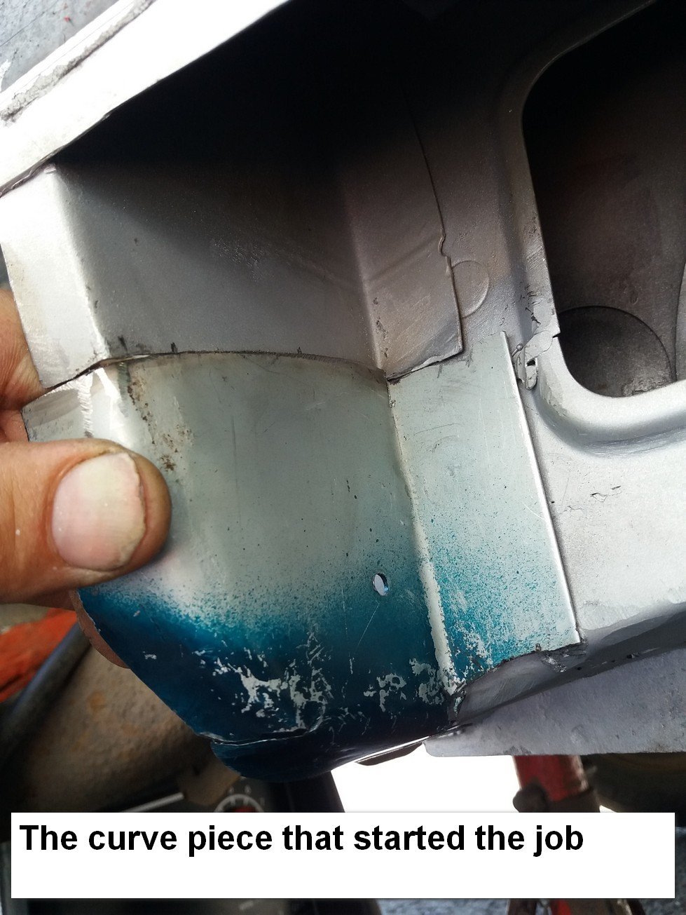

Some progress today anyway though, sub-structure welded in properly and bent to curve
and the curve piece this thread started with cut to size to fit.
There's always a 'compromise' when cutting metal to template, between trusting your template, cutting it 'tight' and risking ruining it and faffing at length filing and grinding; I tend to go for the latter.

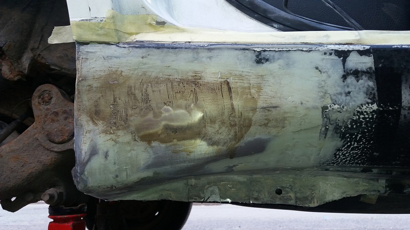

Re: Curved Metal Fabrication and Welding Blog
Job's a Good-Un, at last

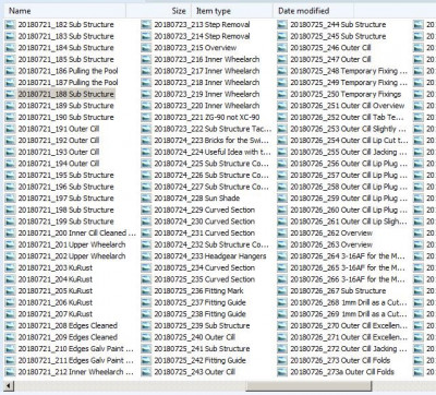

Haven taken a little over 300 photos in the end, I really could've made more of an effort to photograph the fitted Outer Cill before I slapped first some Waxoyl / Hammerite compound on it, which is what the brown mark is.
...but I didn't. I was just keen to be getting on and finished.

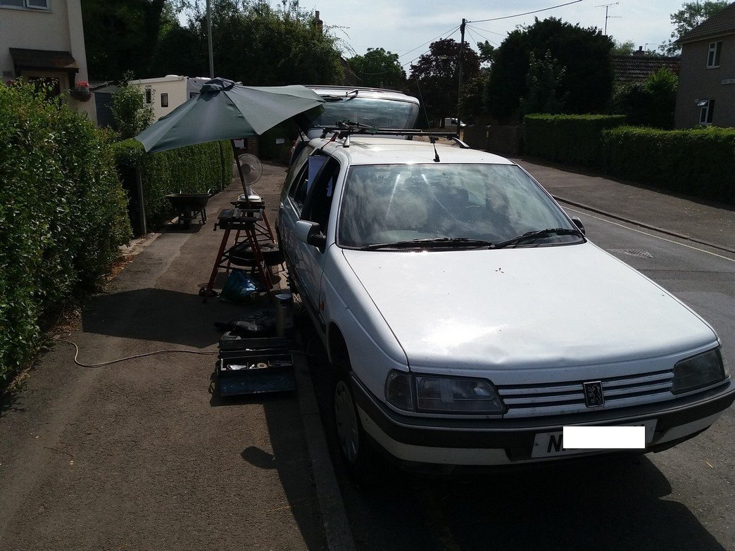

All of it done in the street, using a makeshift screen for some processes, eg welding.
