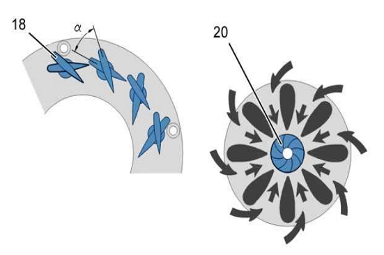

Operation at Low Speed
At low engine speed the kinetic energy of the exhaust gases is weak . The variable geometry turbocharger increases the kinetic energy of the exhaust gases by decreasing the section through which the exhaust gases must pass.
Furthermore the mobile fins ( 18) in the closed position precisely direct the exhaust gases onto the exhaust turbine (20).
With these two conditions the rotation speed of the exhaust turbine is accelerated at low engine speed.

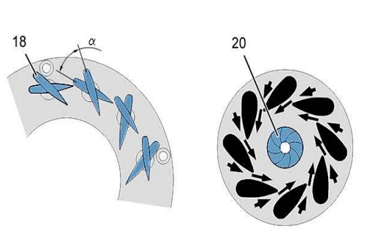

Operation at High Speed
At high engine speed the kinetic energy of the exhaust gases is strong . The variable geometry turbocharger decreases the kinetic energy of the exhaust gases by increasing the section through which the exhaust gases can pass.
Furthermore the mobile fins ( 18) in the open position direct the exhaust gases onto the exhaust turbine (20) in a less direct manner.
With these two conditions the rotation speed of the exhaust turbine is reduced at high engine speed.

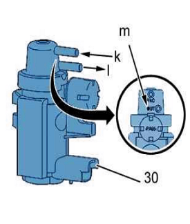

Here's the Turbocharging pressure regulation solenoid valve:
Role
The regulating electrovalve controls the boost pressure waste gate.
Role of the boost pressure regulating electrovalve:
  • Regulate the boost pressure
  • To limit the boost pressure
Regulation of the boost pressure is progressive and is controlled by mapping (injection ECU).
(30) Electrical connector.
  • k: Pressure drop inlet for the vacuum pump.
  • l: "user" outlet.
  • m: White marking.
N.B. : The white marking indicates the outlet aperture for the turbocharger regulation control.
The solenoid control is an OCR (Opening Cyclical Ratio) type control.
The proportional electrovalve controlled by an OCR voltage is connected to the following components:
  • Atmospheric pressure
  • Vacuum supplied by the vacuum pump
The pressure supplied by the electrovalve is included between the atmospheric pressure and the vacuum pump vacuum.

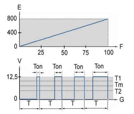

Electrical special features
Features of the OCR signal:
  • Supply voltage: 12.5 Volts
  • Frequency: 140 Hz
  • Fixed period: 7 ms
  • Resistance at 20 °C : 15.5 ± 0.7 ohms
  • Maximum vacuum: 800 mbars
Open Cycle Ratio (OCR)
  • E: Depression in m.bar.
  • F: Open cycle ratio (OCR) (in %).
  • G: Time (ms).
  • V: Voltage In volts.
  • T: Fixed period 7 ms or 140 Hz.
  • Ton: Variable time.
The open cycle ratio (OCR) is determined by the ratio of the variable time ( Ton) to the fixed period (T).
% OCR = (Ton/T) x 100.
The mean voltage (Tm) supplies the turbo pressure regulation electrovalve.
  • The greater the OCR percentage, the higher the mean voltage (T1).
  • The smaller the OCR percentage, the lower the mean voltage (T2).
Variable voltage control (OCR):
  • Full supply (maximum OCR) = Maximum vacuum (800 mbars)
  • No supply (minimum OCR) = No vacuum (atmospheric pressure)
Role
  • l: "user" outlet.
  • m: White marking.
  • Frequency: 140 Hz
  • G: Time (ms).
