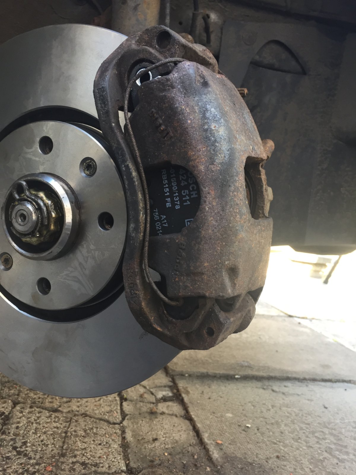

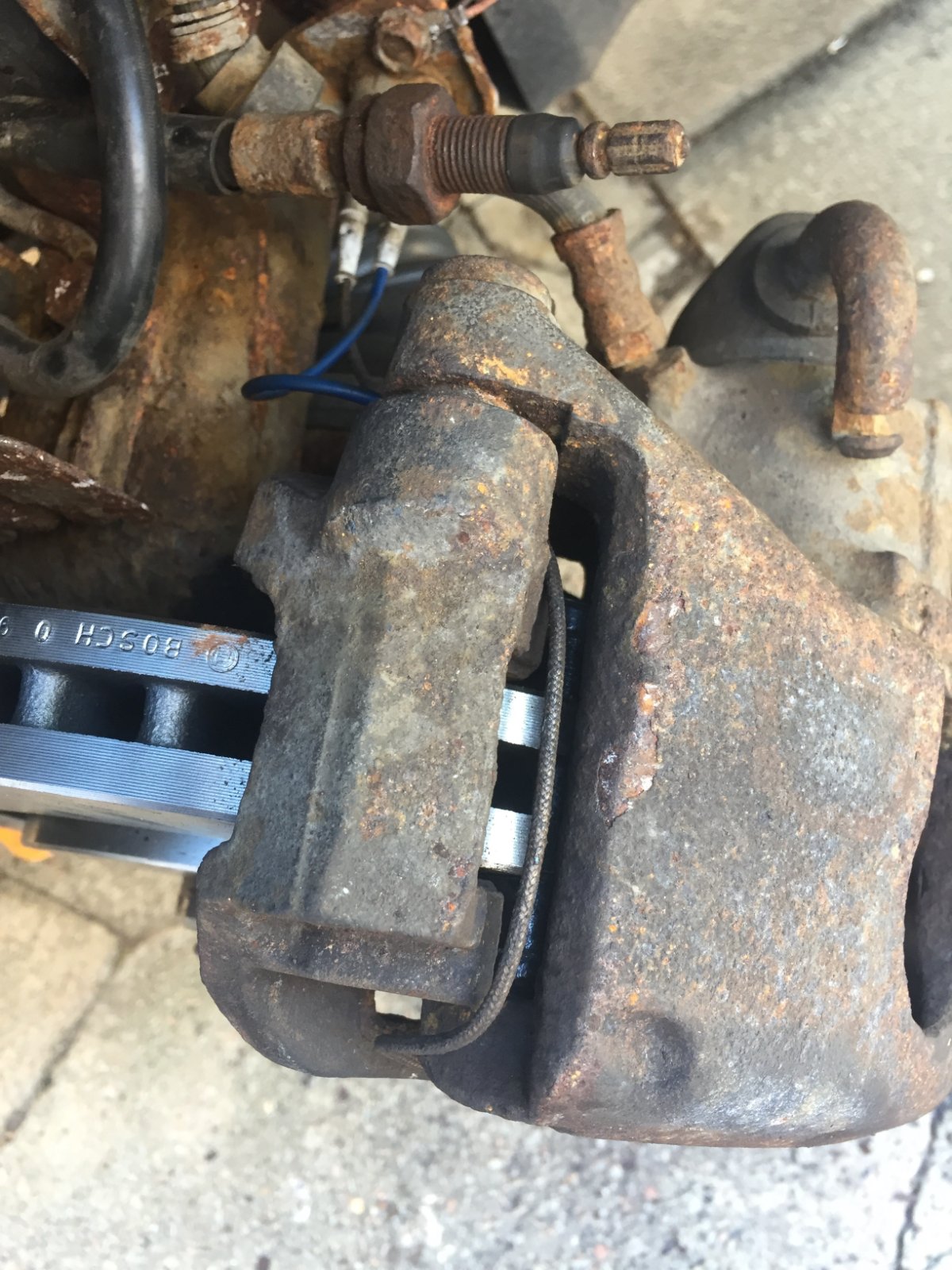

Ok guys, help me out here...
The Bosch pads have wear wires supplied for both pads - but I've never seen a wire fitted to the outer pad on any Xantia V6 and I can't figure out how to route it!
The only way it seems to reach is as shown in the pictures below, however I'm not happy with that as it could get wedged under the caliper finger, or rub on the disc where it passes at the top, and there is enough slack that it may rub against the wheel as well.
So is there a trick to this, or does everyone just leave them out ? I'm going to leave the outer wire out for now but I'll keep it for future use if I can figure it out or someone can explain it to me...

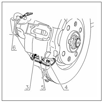

Re: Xantia V6 front discs/pads advice needed
I think the wire(s) might be number 5 below:
As shown above, they go downwards, and through a loop/hole in the casting, then around under the cylinder, through the loop of the bleed nipple cap, then through a sleeve with the inner wear indicator cable and up to the connector.

xantia_v6 wrote: 30 Jun 2018, 17:29 As shown above, they go downwards, and through a loop/hole in the casting, then around under the cylinder, through the loop of the bleed nipple cap, then through a sleeve with the inner wear indicator cable and up to the connector.
Are you sure the above image is for the 283mm version of the brakes ? On my old 2.0i with smaller brakes the pad wires did indeed both loop through the bleed nipple cap, however the inner pad wire definitely does not reach the bleed nipple cap on this. The wire is too short and even if it was longer it would lead an awkward sharp route.
Also the only hole in the casting at the bottom the wire might go through is in the part that flips up - which means the wire would have to be disconnected at the pad end to flip up the caliper, which doesn't seem right. Also once it passes through the hole there is nothing to support it on the other side so that it doesn't get snarled up.
I'm pretty sure the pad wire routing is different for the smaller and large version Xantia brakes.
Anyway, I've left the outer pad wire off - the original pads weren't fitted with one anyway.

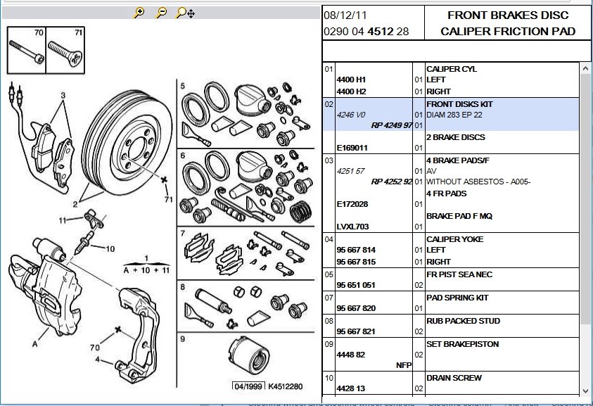

The diagram I posted was for a V6 Xantia. It was the only one I could find no matter how I configured the Xantia - it's a generic picture
The parts diagram shows a routing for the wires, but I don't know if that makes it relevant.
