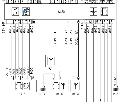

| 8404 is the other aerial |

This is what is coming up with RNEG option:

Re: RT6 FM2?
Can you please clarify? I am not good with reading schematis. And didn't 308 come with RT6?
- x 6957
Re: RT6 FM2?
The 308 came with many options like most other PSA vehicles and the RT6 was one of them from a certain year. In this diagram it more or less shares the same connections for MyWay (RNEG) as it does for eMyWay (RT6).
This is not exact as all the diagrams are different depending on options, build date, and other specs - so I normally need a VIN for this reason as it can raise more questions - so use this as an example only.
The blue aerial is for the GPS, the White Aerial is for AM / FM1 and the Grey aerial is for FM2.
I can't give you a diagram for your car as is won't have come with these options so the electrical diagram won't be relevant. The 308 one here is a sample only and won't be exact as it is for MyWay probably, but was just to show you the separate aerial connections.

Re: RT6 FM2?
So, my initial assumption is correct, two antennas exist? Also, would it be possible to see in the diagrams which is negative which positive input for this 8404? I'm thinking to just order the module from eBay and try it.
- x 6957
Re: RT6 FM2?
All the original 2 Aerial, GPS and GSM connections (4 in total) from your original RT3 went directly to the aerial base on the roof of the car.
So on the RT6 you won’t have a GSM aerial, just the 2 Radio and GPS connections. So have you first tried changing them both to active in PP2000 to see if that will make any difference?
In the above diagram 8501 is the Blue GPS connector, then you have 3 others for radio, 2 going to 8404 and one in 8406. I can’t tell you from this where they are powered from as it doesn’t show this.

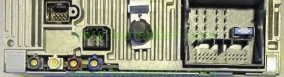

Does your 307 have two antennas that feed the diversity module, then from that a single antenna feed to the headunit?
Also, would you mind telling me the part number of the CAN2004 RT6?

Re: RT6 FM2?
I don't have diversity module at all. If I did, than I would not have this problem. I would just take out the module, and feed two coaxial cables directly to RT6, which now does the diversity job. I don't have the part number which you can find on the service box, I bought RT6 used, screen was new. I can take a picture of the top side if that can help you.

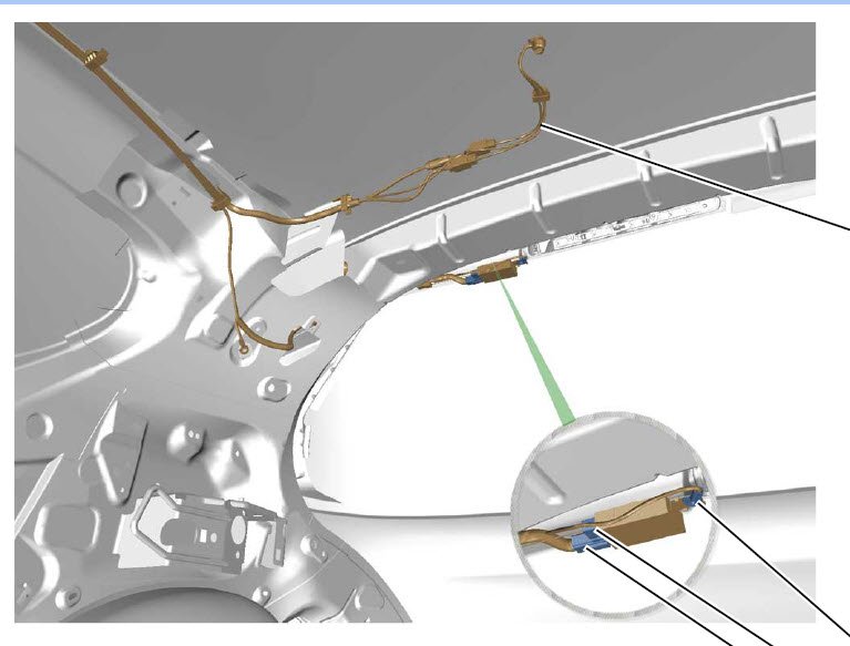

I found this in schematics, what do you think about the location, is this in the tailgate?
- x 6957
Re: RT6 FM2?
So far as I can tell, the aerials can be:
Roof mounted
Rear Tailgate (screen printed)
Rear Quarterlight (screen printed)
A wire through the Rear Spoiler / Tailgate
Roof mounted

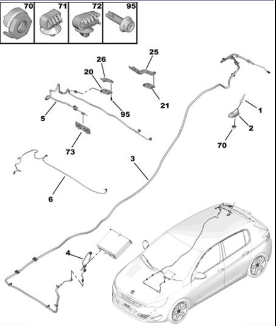

mara- wrote: 09 Jun 2018, 12:47 Just checked today with multi-meter, and FM1 and FM2 are feeding 12v, so they are currently powering the same antenna, so basically, splitter is not doing anything, since radio is receiving signal either with FM1 or FM2 plugged in, so I definitely need the second antenna. My best bet is to find someone with 308 and see if this amplifier plugged to anything else except coaxial.
I'm assuming that is from a 308.
These are the aerials on the later 308 as far as I can see and there are a large number of options even for the stubby roof aerial dependant upon equipment of course.
| 20 is the AM-FM1 Aerial Amp 21 is the FM2 Aerial Amp 25 is the TV Aerial Amp Support for FM2 26 is the TV Aerial Amp Support for AM-FM And of course the wire (1) and the base (2) are also different depending on options! |
