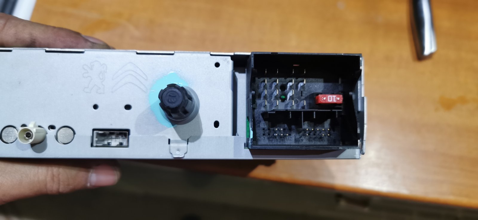

PERFECT! I used Your experience and solve the same problem! TNX!!!Med_tech3 wrote: 14 Aug 2021, 13:11 Hi Marc. This morning I tried it again. I lauched diagbox and told it I had a DS3. It asked for the VIN. After putting it the VIN from the C3 it then gave me a choice of opening Diagbox or Lexia. I chose Diagbox. It went through the communication screen and could not talk to most of the ecus but could talk to the radio. I selected the radio and was able to configure it. I changed the VIN and the beeping stopped. I exited out of Diagbox and unplugged the laptop from the car. I switched the ignition back on and the car and radio are working perfectly.![]()
In C3 Pluriel my2007. I change display from A+ to EMF C soft. V74.0 hard. V1600; and from RD4 change device to RD45 SW4.2.04.
Next problem:
No beeps. Radio, CD, BT, works fine. But there are no any sound from rear speakers. Also no test sound during Diag/lexia testing. In sound meni, no Front/Rear options, only Left/Rught. If I put back old RD4, everything is normal 4 sp. sound as usual. Is it possible that my RD45 is damaged (only front L/R works)? Pins exist for all speakers out at back connector.
Could I make wire bridge front to rear on back? (I know...this will devide resistance double
EDIT:
I saved old VIN from RD45. By VINdecoder, I discover that previus "donor" vehicle was Peugeot Expert... It has only front speakers. Maybe to try connecting Like Peugeot expert, and, if can see Radio ECU, to change F/R speakers.... I`ll do this in few days
Milenko
- Posts: 10
- Joined: 27 Feb 2024, 11:59
Re: RD45 install - can't update VIN / no communication
PROBLEM "RD45 no sound in Rear speakers" SOLVED!Milenko wrote: 18 May 2024, 14:16...
Next problem:
Could I make wire bridge front to rear on back? (I know...this will devide resistance double)
EDIT:
I made risk and started to chose random car type in Diagbox.
RD45 ECU checked in on "Berlingo". All other ECU failed, but there I get option in Configuration to Active/Deactive "FADER". Option Activated and restarted, so I get all F/R speakers!
Done
