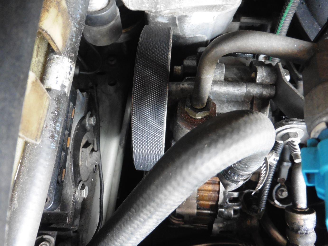

The replacement belt is fitted, nothing else looked too bad so we decided not to spend out on the idler and tensioner.
There is no play in any of the other pulleys.
It arrived two days early which was great, we can now drive to the boot sale on Wednesday instead of having to take the bus : )

The image below is the shiny new belt : )

I'd keep a careful eye on that belt for a while to make sure it doesn't wander off centre again.
On the Xantia I've seen the bearings in the tensioner pulley fail which resulted in the pulley sitting slightly squint, causing the belt to be pushed off the correct line. Grinding, scraping, squeaking, rattling or hissing noises can also be a tell tale - though I've seen ones that are shot also still be silent! If there's any perceptible axial play I'd change it. Hopefully they're cheaper than the ones for the 1.9TD Xantias were when I bought mine!
If the belt was damaged though it will have tended to push itself off anyway - so let's hope it was just a dodgy belt, it does happen sometimes.

Good evening Zelandeth,
Thank you for your interest.
I remembered that in the past fan belts often broke with out there being a reason, other than that the belt was just worn out.
There is I realise a lot more to the path of this belt.
I shall check it regularly as you say, at least for awhile, the old belt could have done 159000 miles : )
The car is due a second cam belt as far as I can tell, but not quite such a simple job.
The belt was £11 inc postage with good feed back, so not too bad : )
God Bless Spiff
