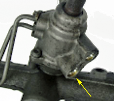

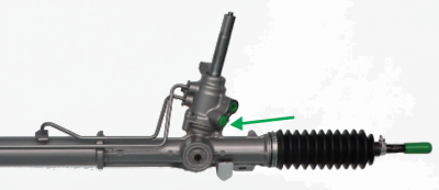

Yes, the number 2 LP pipe, apparently it corrodes. The guy reckons in almost every X7 steering rack he replaces the LP pipe corrodes where it enters the rack, if you don't replace it then it wont be long before it leaks from the pipe/seal area.
His re con racks are £295 + V & he says he can do a brand new one for £500 + V. On the recon ones the pinion shafts are totally re plated ?
In my case even though the pinion valve is extremely rusted the pinion valve seal is definitely not leaking, It's only me who has inspected it & its completely dry. Ive had the big grommet out & inspected it all round with a mirror & camera.
I will however replace the rack & pipe together as its only a matter of time before the pinon does start to leak.

So after the initial cardiac, and just back from the garage - we couldn't see anything from the pinion itself after cleaning up the area. So started her up and only then did we see a very small bubble of fluid emerging from the LP pipe seal (as far as we could see) - as it was forming from the left of the seal and then running down - so the lower of the green seals in the picture, arrowed:
So I'm going to get both a set of the older C5 seals as Robin liinked to and also a box of green Chinese specials (HNBR I hope) and they'll try and replace the seal first - as the LP pipe itself looks in good nick and no rust from the outside at all.
So in for a penny, in for a pound, I've decided to get the
- LP Pipe seal replaced and see how we go with that - (pending a replacement LP Pipe / Rack later if it doesn't work)
