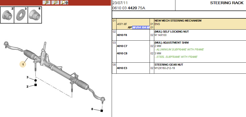

So it was the dreaded Steering Rack then after all! Don't forget to add it to the X7 Poll!
This is the replacement Part for your X7
Click to Zoom
Replacement Part 9801415480
Not sure what they mean regarding 'sensors' - there isn't one on the X7 that I am aware of - I think this is probably relating to vehicles with incorporated Electric Power Steering pumps on the rack.

I think that is in relation to the Variable Steering system on some of the V6 models. It won't be relevant to your car Pete and the rack I have pictured above is for your VIN specifically - from Citroen Service today.
