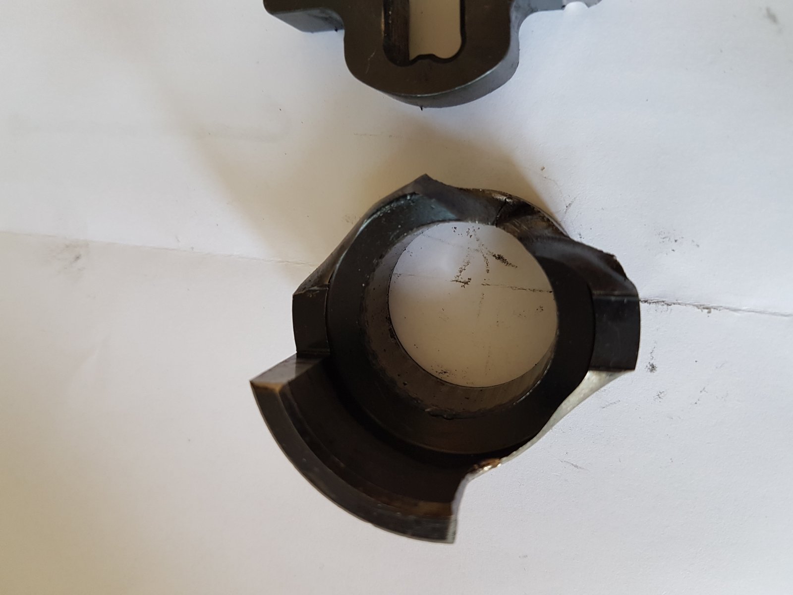

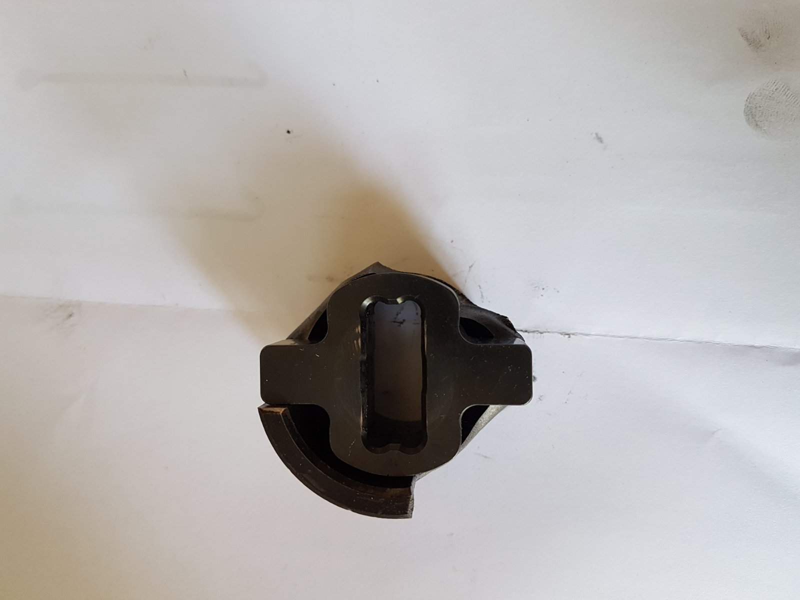

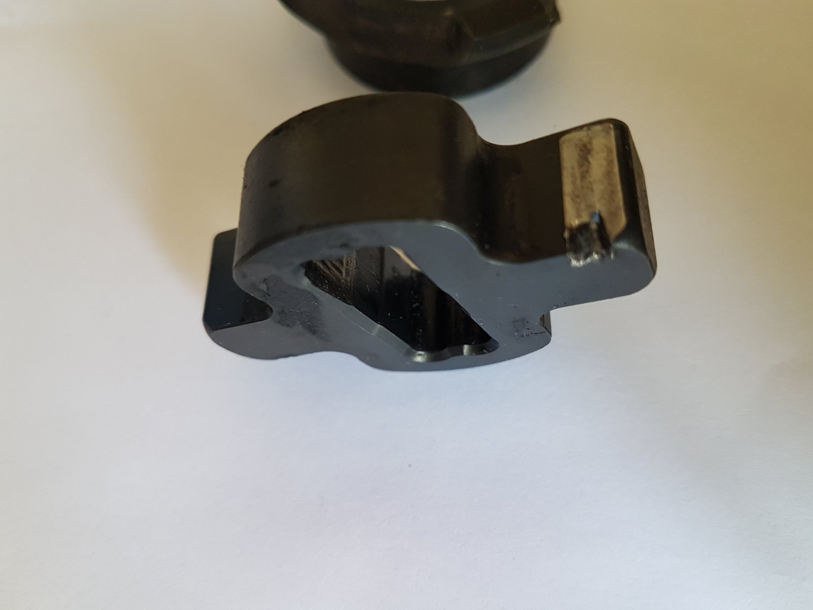

Looks like the yoke on the end of the camshaft broke quite a long time ago. It's been driving on just one side of the cross piece for long enough to mark it heavily.
Only reason it stopped now is that the yoke has cracked across the area that is shrunk onto the camshaft so it simply lost drive.
I'm worried that I can't find any of the broken off pieces of the yoke. I know I haven't got the top off the head yet, but I expected to be able to fish some pieces out with a magnet. I guess the pocket under the drive area is open right down through the head so the pieces may have dropped down to the sump.

This is a very concerning development re. the broken camshaft yoke. I'm interested to find out where the other pieces of it ended up and how they didn't cause instant destruction of the engine after thrashing around in the rocker cover for a bit!
