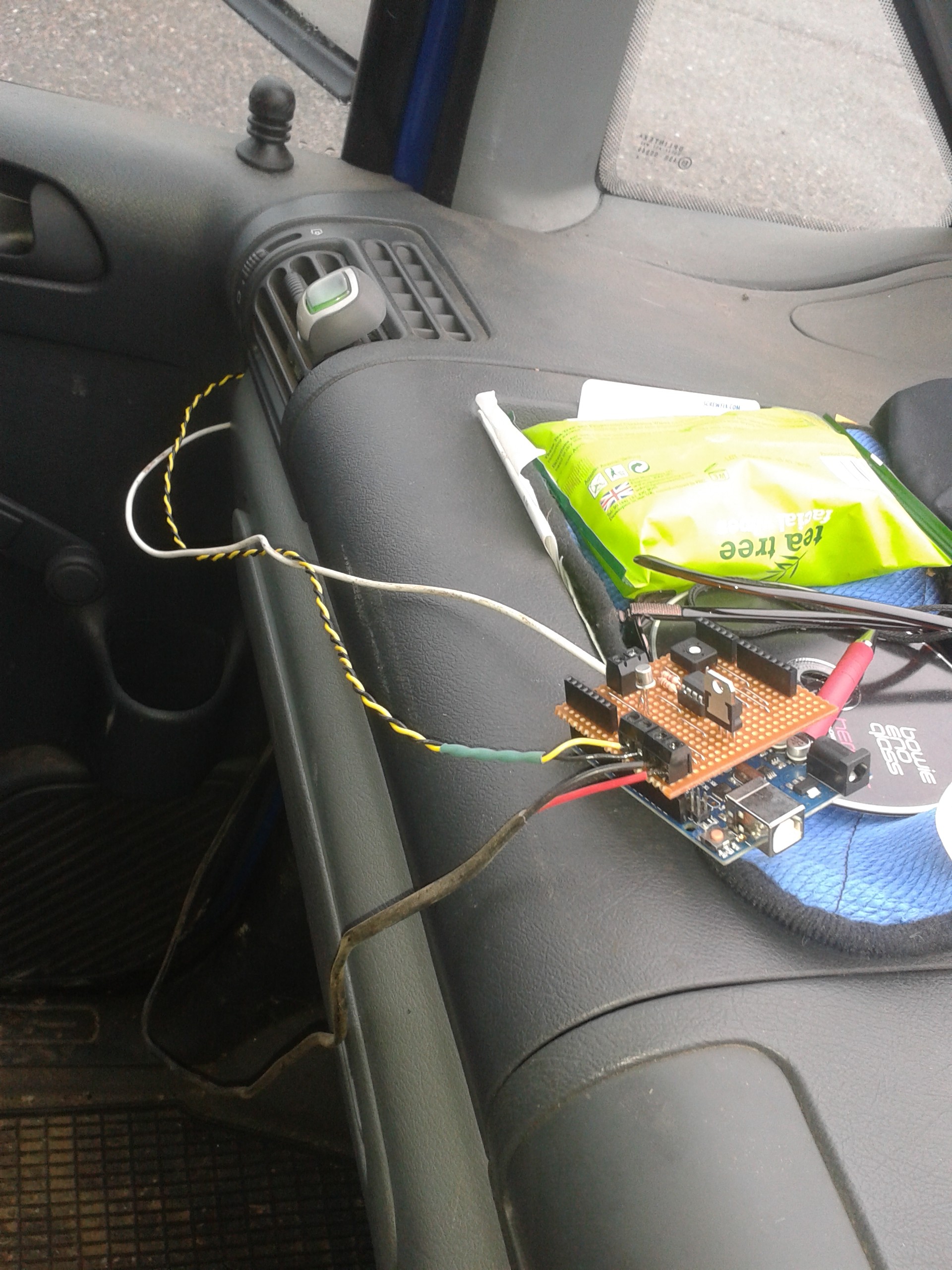

However...I've got my speedo working again and this is how I did it: I traced the wires from the O/S ABS sensor back to a point in the loom behind the air filter box and spliced in a new pair of wires to take a feed off it. Driving around with an oscilloscope on the passengers seat showed that the ABS sensor (which is a variable reluctance type on my van, basically a tiny AC generator) gave off an AC voltage with a frequency about 12x the vehicle speed in MPH.

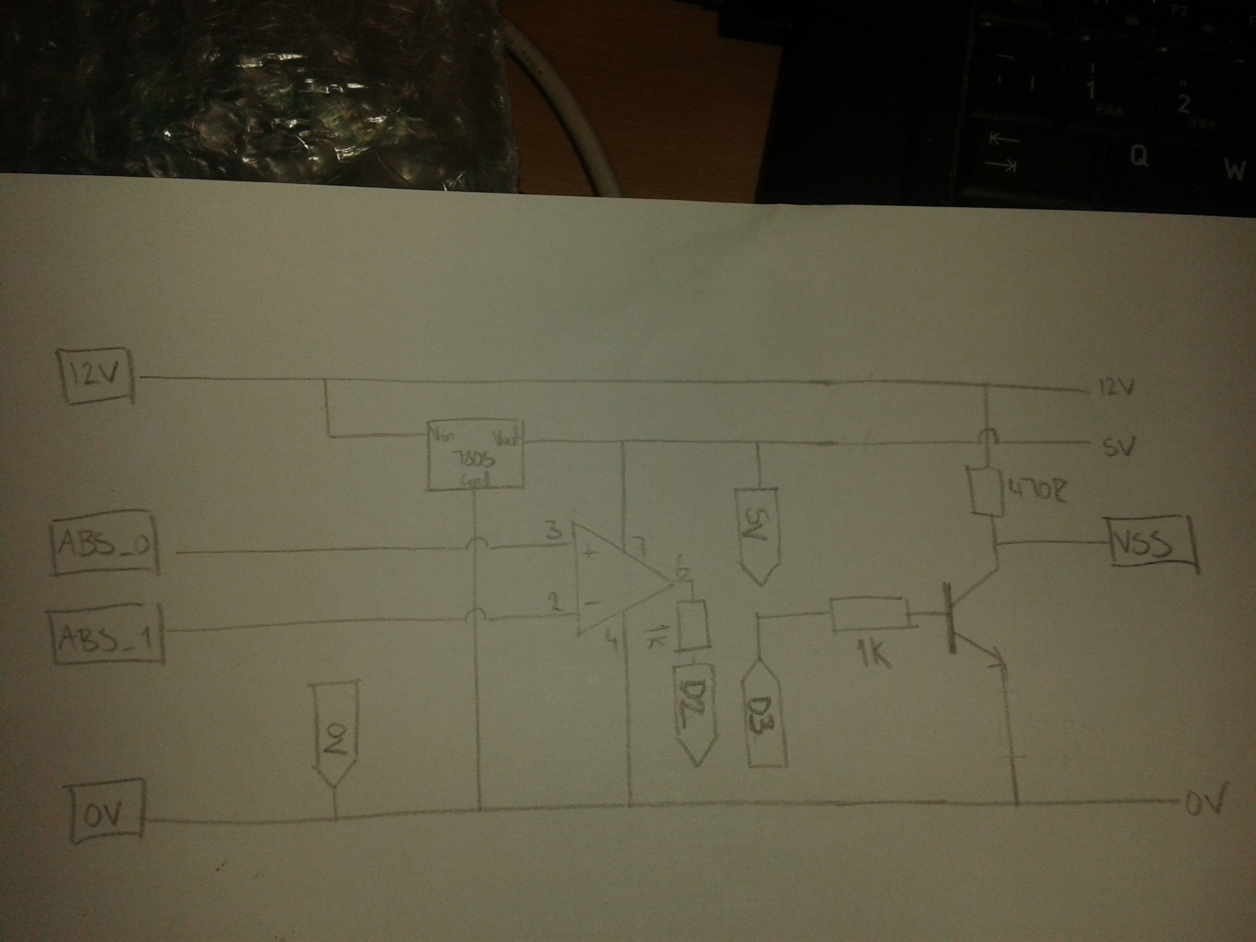

The VSS (I'd found out the same way) gives off a 12V square-wave with a frequency about 2x the vehicle speed in MPH, so what I needed to do was convert the AC ABS signal to a 12V square-wave and divide the frequency by 6:
This circuit takes the ABS signal, puts it through a comparator to convert it to a square-wave and passes that into a microcontroller to do the frequency conversion - this part all runs at 0V to 5V, supplied by a 7805 regulator. The output from the microcontroller is then passed through a transistor (a 2N2222) to bring it up to 12V and passed onto the VSS feed (to the ECU and the speedo). The comparator input impedance is high enough that it has no effect on the ABS circuit, so that all appears to be working normally.
Here's the complete system; the black and red wires are the 12V feed that originally went to the VSS, the twisted yellow and black are the feed from the ABS sensor and the white wire is the VSS signal to the speedo and ECU. At the moment, it's just perched on the dashboard - I've added a potentiometer in to the circuit to adjust the output frequency, so once I've calibrated the speedo against my satnav, I'll put it in the engine-bay fuse box, as there's plenty of spare space in there...
So far, the speedo's behaved itself with no more dropping off to zero, so it's definitely looking like a gearbox fault rather than a wiring fault - this may not be the "proper" way to fix it, but it certainly does the job
