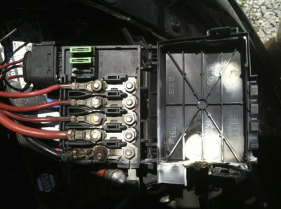

Well thermal fuses can be dodgy for a start - just look at the all the Vauxhall Zafira fires if you're not convinced. I just hope with the new acquisition of GM Europe that they don't use any of those blower resistors in PSA vehciles:
https://publications.parliament.uk/pa/c ... 62/962.pdf
As I mentioned earlier somewhere, if there is corrosion entering the fuse box / relays and power connectors then the corrosion can cause a higher resistance and that will generate additional heat.
Just look at this picture of a VW - the lower 30A fuse to the fans (under the 2 remaining green ones) is shot, but the lower connector is to the alternator. You can see how it has started to melt the casing, which could account for the smoke.

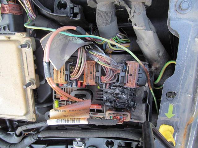

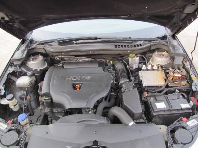

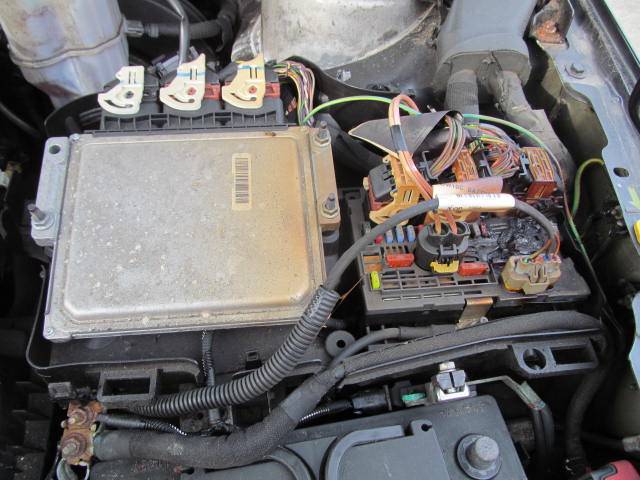

Give the dealer their due, within 15 minutes of me phoning them this morning they have sent some picutres ...
The whole engine bay:-
... and a couple of close-ups of the actual charred remains
This can't be the beginning of the end for my lovely car .....
Sarah

Looks cheaply fixable to me, breaker's yard for parts and a bit of time.

Thanks for those pictures Sarah, I'll have a look and see what area that charred mess was related to - I really hope a new fuse box and a check of the associated components will result in resurrection!

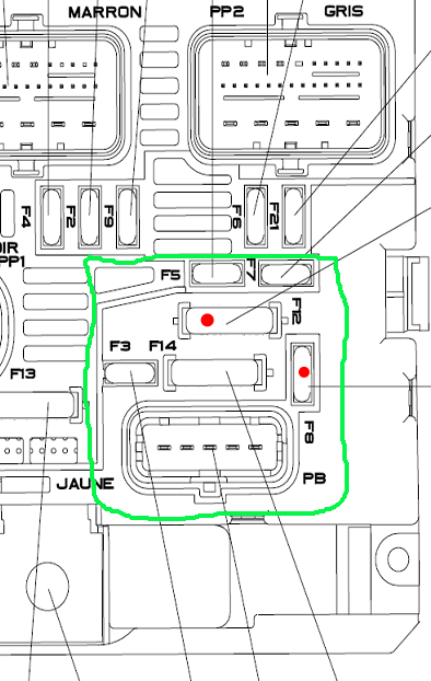

Ok, so here is the diagram of the affected area, highlighted in green, with the suspect fuses marked with red blobs.
Recalling Sarah's account below, it would seem that there was an issue with the wipers initially - and then as you can see, the fuse relating to the starter motor (F8) is right next to the Wiper Motor (F12). So it's possible that the damage from the wiper motor circuit could have affected the starter circuit causing that to operate as Sarah says... Anyway at least we have some idea of the components now - it's just down to the cause.
F5: 15A Batt + Multifunction Motor Control
F7: 10A Ignition Controlled +ve, Gear lever blocking actuator control relay automatic gearbox - ECU and electrohydraulic block automatic gearbox - electrohydraulic power steering
F8: 20A / 25A Batt +Starter Motor Control
F12: 30A Batt + Windscreen Wiper
F14: Not used - but can't confirm until I know all the options / VIN
it suddenly popped up with a warning about the Automatic Wiping (didn't see if it said 'activated' or Deactivated' - but I wasn't using or touching the wipers! This closely followed by the Service light ....I tried operating the wipers and nothing happened although the wiper blade was 'fluttering' a bit. I decided not to worry and hoped the issue would re-set after car stopped / re-started.
F3: 10A Batt + Front/rear screen wash pump...Then the car tried to start itself!

Re: Citroen C5 VTR 160 HDi fuse box spontanously melted
Hello,
Thank you so much for looking. Still awaiting a call from garage or Citroen UK.
it's a manual gear box. Car is a 2012 build / 2013 registered HDi 160 bhp VTR + Technopack tourer. All else standard as far as I am aware.
Order of errors (as I saw them):
1: Defo the w/wipers - although I *think* just a standard activation message - although I hadn't touched the wipers, followed by the wipers 'fluttering', then quickly followed by the yellow SERVICE light (but didn't notice any other symbols).
Next thing within seconds was the car lost power - or at least when I went to accelerate away from a roundabout the car was sluggish - like it is when in 'Safe' mode ...
The next thing I was aware of was red warnings about Power steering failing, and the red STOP now messages. (May well have been other stuff too, but those are the ones I read).
Steering was sluggish and I quickly came to a stop.
Turned ignition off (I *think* the engine was still running).
Noticed smoke from Passenger side bonnet and got out to have a look. A few minutes (?) later the starter motor began to turn over although ignition off and me not in the car!
Rushed back and removed ignition keys.
Smoke continued to increase.
A short time later the starter again turned over a few times sluggishly, and some audible alarms from the car.
That was the last I saw / heard from the electrics!
Smoke continued for about 20-30 minutes before ceasing.
I think that is about it. LOL
