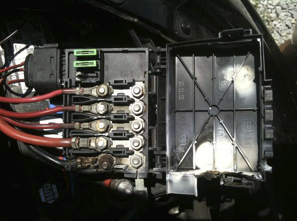

Just look at this picture of a VW - the lower 30A fuse to the fans (under the 2 remaining green ones) is shot, but the lower connector is to the alternator. You can see how it has started to melt the casing, which could account for the smoke.
https://publications.parliament.uk/pa/c ... 62/962.pdf
As I mentioned earlier somewhere, if there is corrosion entering the fuse box / relays and power connectors then the corrosion can cause a higher resistance and that will generate additional heat.

That was the last I saw / heard from the electrics!
Smoke continued for about 20-30 minutes before ceasing.
I think that is about it. LOL
