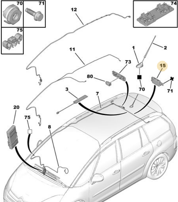

Right, you don't have the SMEG digital receiver, you have a dual band RD45 unit.
So I would suggest getting a diagnosis with Lexia / Diagbox to see if the fault can be pinned down - but here is the aerial routing - but note you do not have all the options shown!
You only the following:
(1) AM / FM1 Aerial Base, (2) Aerial Wire, (7), Aerial Cable (8) Aerial Cable, (15) Aerial Adapter, (70) Fixing Nut, (71) Bolt & (75) Fastening Clip on your vehicle.
Usual suspects are a short - water ingress around the aerial base causing corroding of the aerial base components. Sometimes you can see water stains from the rear interior ceiling light near where the aerial base is located and accessed under the headlining.
