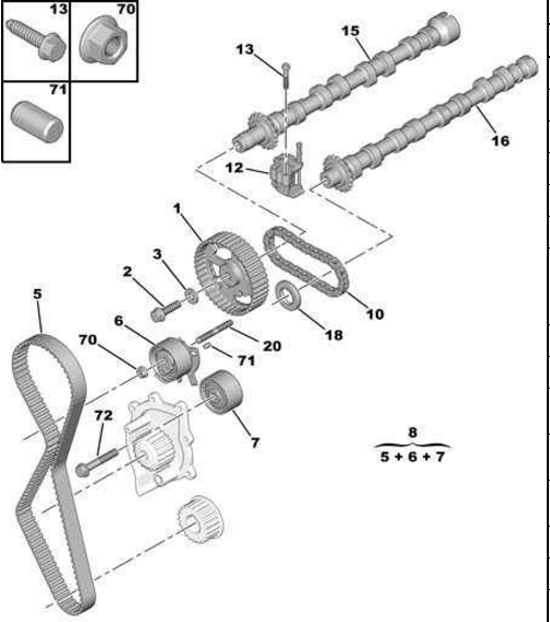

Does it have the chain on the other cam like the earlier models? Chains can stretch and you lose timing too.
Thought originally you had the very early 2.2 donkey...........hence my swirl valve comment on rough idle.

Am I missing something - surely this is nonsense? You would know all about it if the cam and crank were not synchronised, I understand the majority of the HDi engines will not even run, or at very least will knock like hell, if the timing belt is even one tooth out.Titch64 wrote: 05 Jan 2018, 10:34 the cam and crank were not syncronised which indicates cam belt change.
Most of the HDi engines have crank and cam sensors, and so in theory I guess the ECU could detect a lack of synchronisation, but as noted above my understanding is that such a lack of synchronisation would render the car undriveable.
I think that in most set-ups of that arrangement the cam sensor is usually on the camshaft driven directly by the belt from the crank, rather than on the camshaft driven indirectly by the chain from the first cam, and so (assuming this is the set-up of the 2.2 in question) the ECU would not detect any lack of synchronisation even if the chain had stretched.lexi wrote: 05 Jan 2018, 12:42 Does it have the chain on the other cam like the earlier models? Chains can stretch and you lose timing too.
Unless I have misunderstood the situation, I would disregard the garage's advice. Being cynical I wonder if they are merely attempting to drum-up some cambelt change work. In this regard, you are correct that the Citroen specified interval for the cambelt (assuming it is the later 2.2) is 150k miles. Whilst it may be prudent to change a bit earlier, I would be very surprised if there is anything wrong with the belt at 80k. I have done belts on a number of the earlier HDi engines (for which the specificed interval is 100k) at around 80k, and they have always looked almost brand new.

If a belt or chain were to stretch (and they CAN stretch) the performance of the affected engine would suffer, but as the differences are a lot smaller than if they were a tooth out there would not necessarily be far enough out for moving parts to impact each other.

Perhaps, but I would be surprised if either of the belt or chain have stretched given the mileage, I doubt such stretch could be detected by the Lexia, and I can't imagine how such stretch would produce the reported symptoms which appear to be of an intermittent/transient issue.Hell Razor5543 wrote: 05 Jan 2018, 14:09 If a belt or chain were to stretch (and they CAN stretch) the performance of the affected engine would suffer, but as the differences are a lot smaller than if they were a tooth out there would not necessarily be far enough out for moving parts to impact each other.

This is the setup on Titch's X7 2.2:

Thanks for your input Sam. I will change the belt anyway as the 10 years is not that far away which is a recomendation in the book and would rather be safe than have to replace an engine, if it sorts the problem time will tell. All the other checks, fuel pressure, injectors, sensors, air flow etc were good and they ruled out clutch as well. The garage I had the inspection done phoned a specialist about the lack of readings and he confirmed strait away about timing out. He knew he wasn't going to get the job as he was doing the diagnostic for another garage so he had no self interest.
