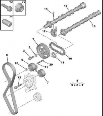

Titch64 wrote: 05 Jan 2018, 10:34 the cam and crank were not syncronised which indicates cam belt change.
Am I missing something - surely this is nonsense? You would know all about it if the cam and crank were not synchronised, I understand the majority of the HDi engines will not even run, or at very least will knock like hell, if the timing belt is even one tooth out.
Most of the HDi engines have crank and cam sensors, and so in theory I guess the ECU could detect a lack of synchronisation, but as noted above my understanding is that such a lack of synchronisation would render the car undriveable.
lexi wrote: 05 Jan 2018, 12:42 Does it have the chain on the other cam like the earlier models? Chains can stretch and you lose timing too.
I think that in most set-ups of that arrangement the cam sensor is usually on the camshaft driven directly by the belt from the crank, rather than on the camshaft driven indirectly by the chain from the first cam, and so (assuming this is the set-up of the 2.2 in question) the ECU would not detect any lack of synchronisation even if the chain had stretched.
Unless I have misunderstood the situation, I would disregard the garage's advice. Being cynical I wonder if they are merely attempting to drum-up some cambelt change work. In this regard, you are correct that the Citroen specified interval for the cambelt (assuming it is the later 2.2) is 150k miles. Whilst it may be prudent to change a bit earlier, I would be very surprised if there is anything wrong with the belt at 80k. I have done belts on a number of the earlier HDi engines (for which the specificed interval is 100k) at around 80k, and they have always looked almost brand new.
FWIW, referring to the original issue reported, as well as the clutch/DMF, I might regard the injectors (or at least one) with suspicion. The issue could be with the injectors, under the specified conditions, not providing the correct fuel dosage for the (albeit relatively small) load of the redundant gearbox, that being remedied by depressing the clutch and de-coupling the gearbox.
If the problem does not manifest at cold, and if the clutch does not slip, and if it is remedied by the pumping of the clutch that you describe, in my mind that would tend to clear the clutch/flywheel of blame.

If a belt or chain were to stretch (and they CAN stretch) the performance of the affected engine would suffer, but as the differences are a lot smaller than if they were a tooth out there would not necessarily be far enough out for moving parts to impact each other.

Re: Rough idle with clutch up.
This is the setup on Titch's X7 2.2:
