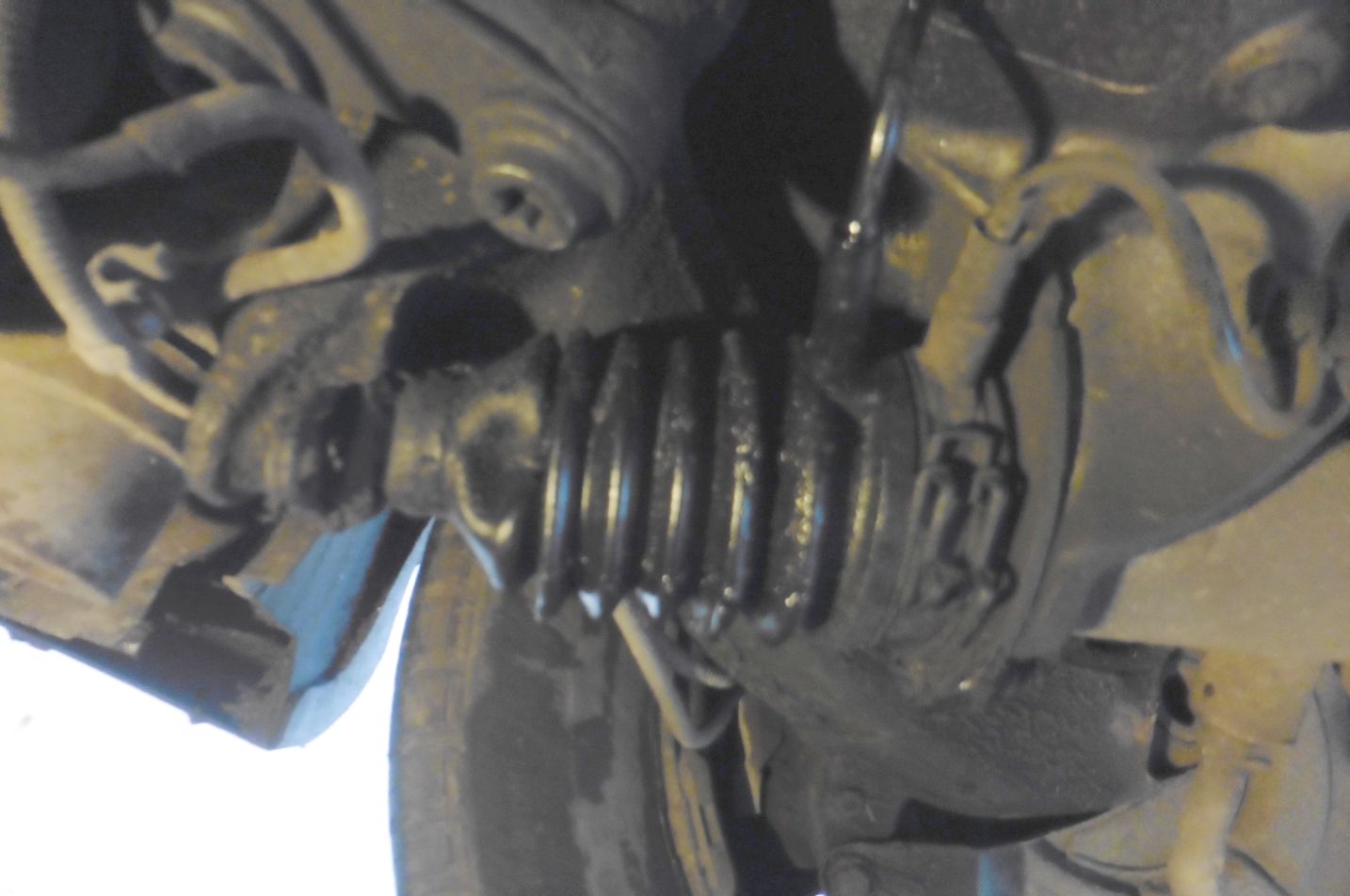

Looked under to see driver side suspension rear boot dripping, put bowl under.
Ordered new boot.

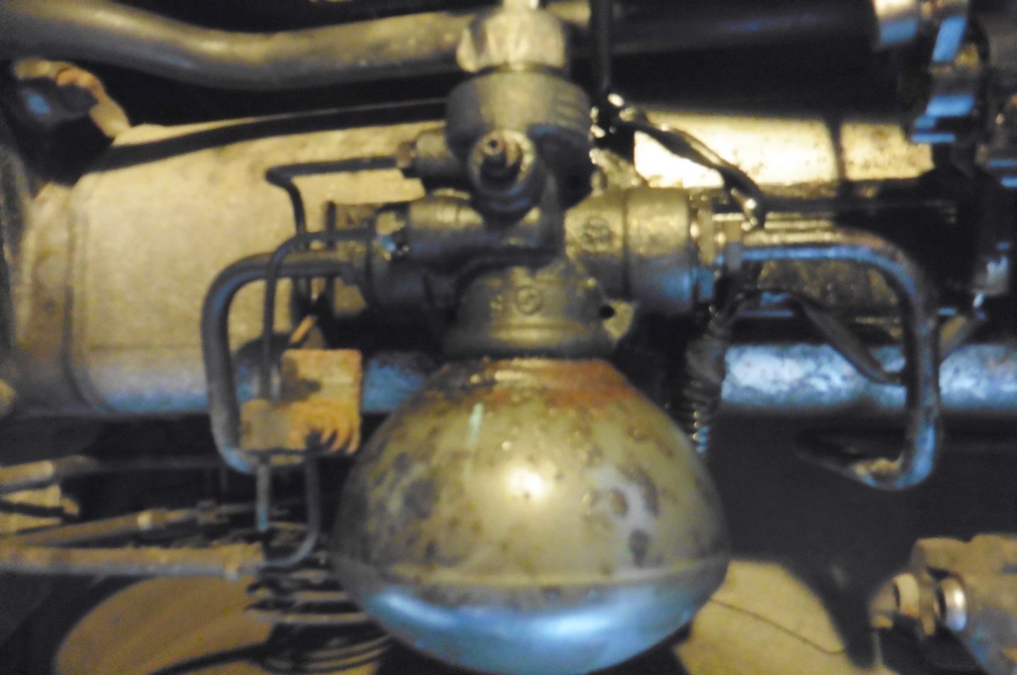

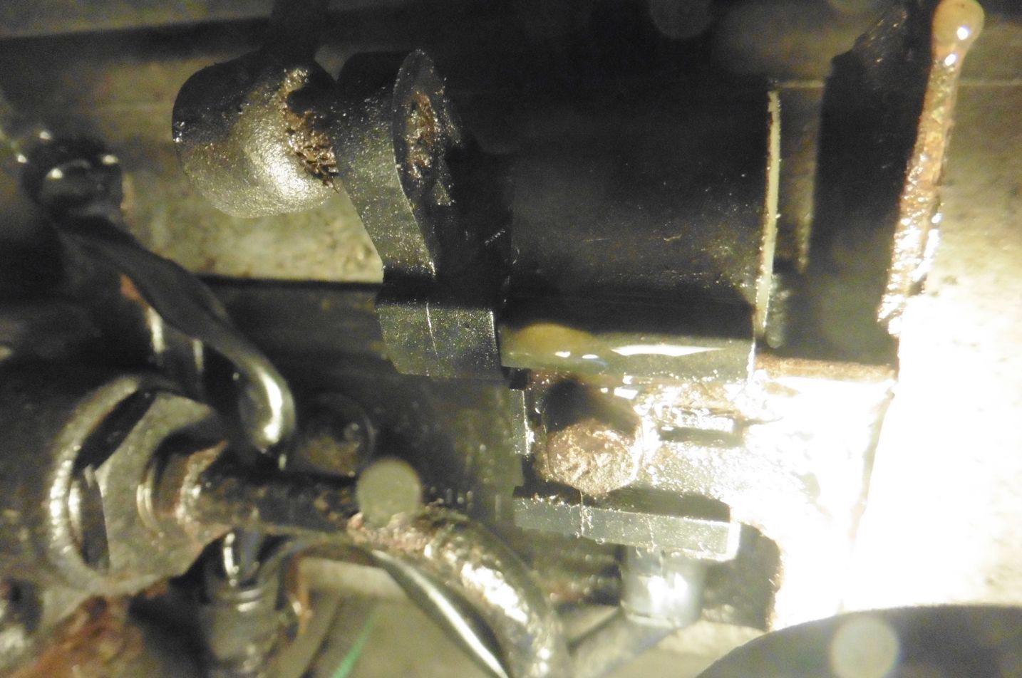

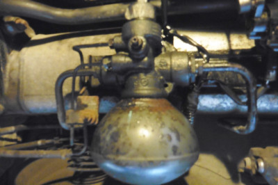

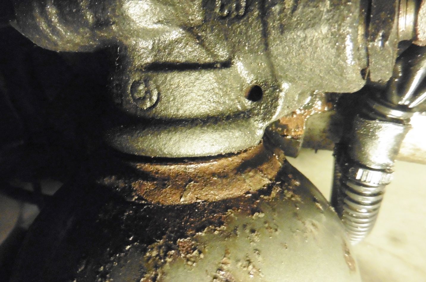

Noticed than now the area round the centre sphere was soaked in fluid, sorry that image is out of focus it was wet and cold and the light was fading.
It had even spread to the height sensor, see images.
I tried all the junctions round it including the sphere, but all are tight.
I had cleaned a lot of the fluid off before taking the picture, but could not see where the fluid is coming from.
Any Idea's : )

It is possible that your root problem is a leaking ram. The leakage is being contained within the boot, but (particularly when going over bumps) the leakage rate is great enough that it is pressurising the low pressure return line, causing fluid to escape wherever it can.

Where is the fluid round the sphere coming from ?
As far as I know there is not a low pressure return round there ?
It looks as if the breather pipe from the ram boot goes into the same casing that is above the sphere.
Is it possible and are you saying that the original Serious Suspension Fault warning is tied up with the ram leaking, pressurising the return system which has just got worse ?
This is forcing fluid via the breather pipe into the void above the sphere which is then leaking over the sphere ?
God Bless Spiff

The breather pipes from the cylinder boot, vents into the subframe cross member (the pipe litteraly just pokes through a grommet in the cross member and then stops).
Is it possible that the split in the boot is causing fluid to be sprayed onto the centre sphere, when the suspension moves???
I would certainly start with what you already know is faulty (the gaitors) and give all the gubbins around the centre a good wife over clean/dry, then keep a close eye on the car to see what happens. That will eliminate one possible cause of the leak and if the fluid reappears, it should allow you to see exactly where it's coming from.
You really, really, MUST get the car into a lexia to read the fault codes in order to diagnose the "serious suspension fault". Anything else (changing random bits) instead of doing that, is just wasting time and money and potentially causing more problems (changing height sensors could just result in throwing out the height settings).

IME, it's quite normal for a little misting from the breather to gradually accumulate inside the crossmember, which has a drain hole directly above the centre sphere block.
Mine gets a degrease just before the MOT each year to avoid difficult questions, but I've never had to top up the fluid.
