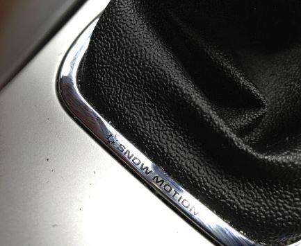

EDC5 wrote: 17 Dec 2017, 14:07 Is snow motion the snowflake button near the gear stick? Or is it a special optional extra or something?
as Bobins said, ‘Snow Motion’ is an automatic feature and separate from the snowflake on the gear selector.
It wasn’t introduced until about 2010 onwards and if installed will have the words ‘Snow Motion’ written in the gear surround.

GiveMeABreak wrote: 17 Dec 2017, 20:44
That's a shame, no snow motion for me then :cry: :cry:
Posts: 14308
x 3296
Re: Cold weather cars.
At least it does not say "Slow Motion" on your gear surround!

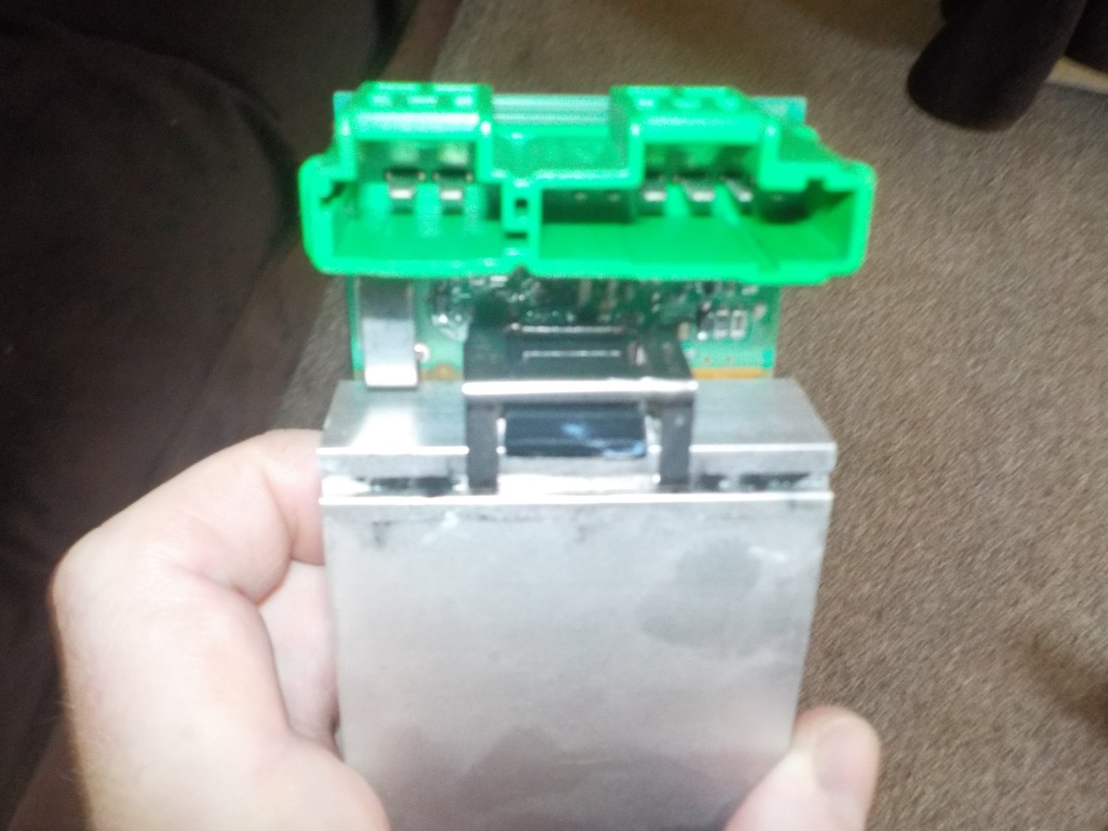

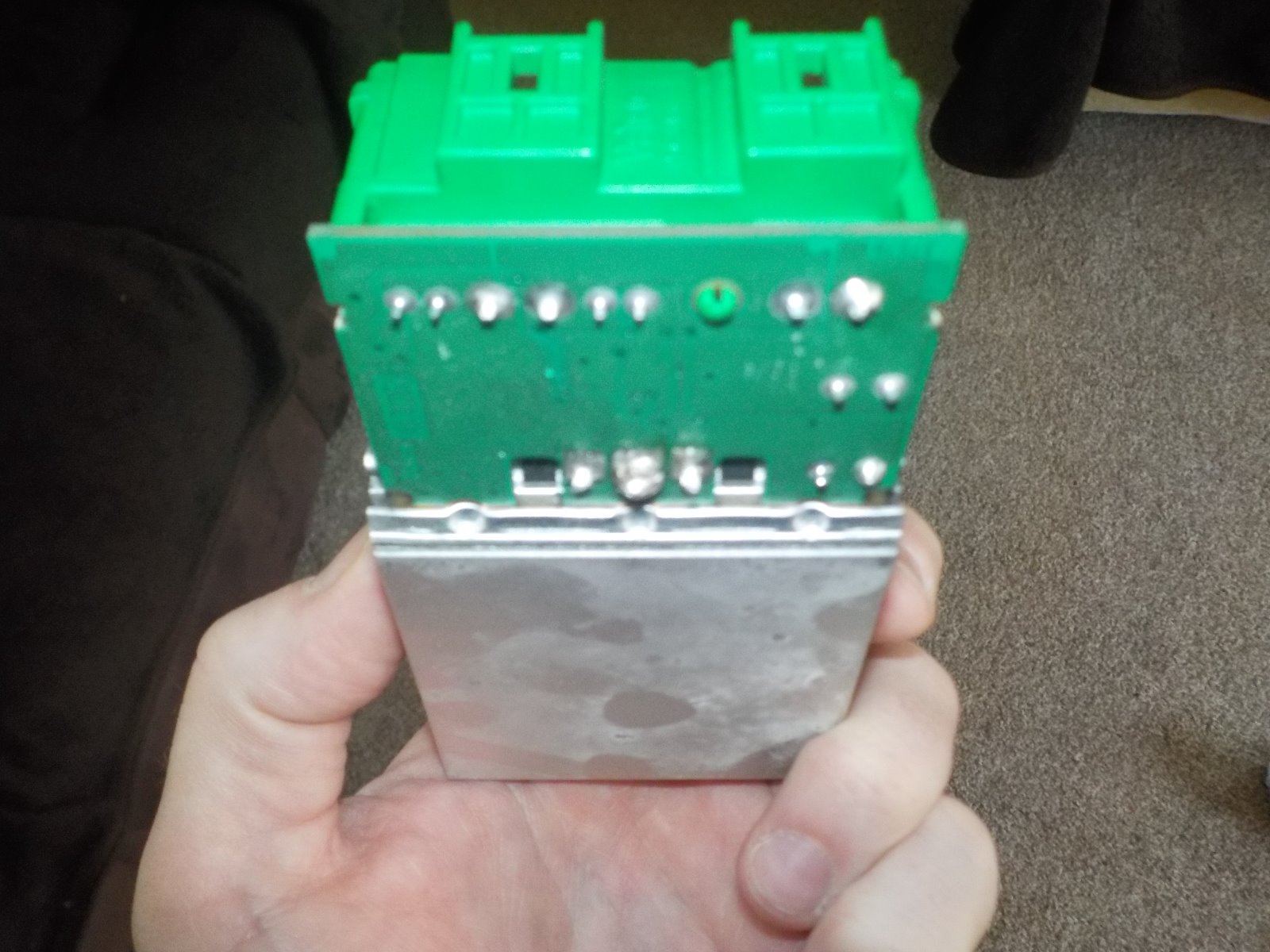

Hell Razor5543 wrote: 17 Dec 2017, 15:05 Gibbo2286 has sent me a module (I also, before he made the offer, had ordered one), and I will fit it as soon as it arrives. I will sent the old one off to CitroJim for investigation as to whether they are amenable to repair.
If its the same as this one (black covers have been removed removed) then yes easy to repair, I just changed the little black bit with 3 legs, think its a transistor ?? sorry not really an electronics person. The board just unclips off the heatsink, desolder the old one off & re solder the new one on. I just punched in the numbers off the transistor? into ebay & found a replacement.

Unread post by Paul-R »
They can certainly be repaired as this firm offers the service.
http://www.heaterblowerresistor.co.uk/
I've posted their details before although I haven't personally dealt with them and so can't give any feedback.
