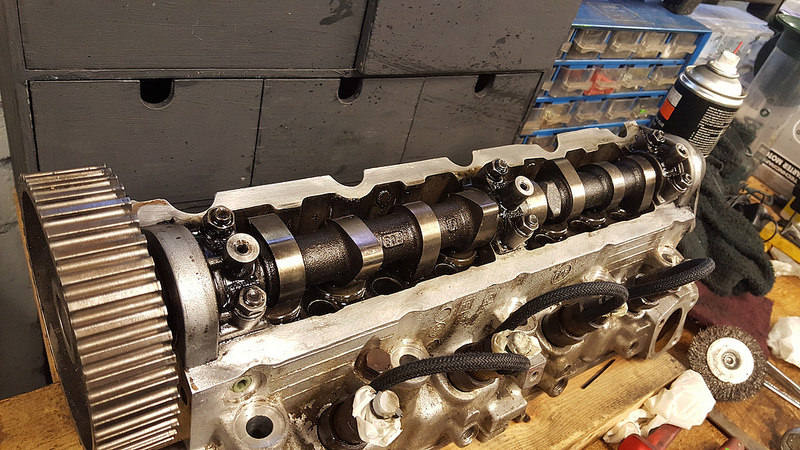

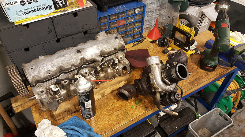

I strted to clean the 'head
Image20171125_155904 by Graeme McNulty, on Flickr

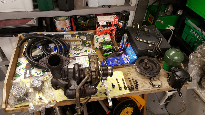

And the turbo/ manifold
Image20171125_161917 by Graeme McNulty, on Flickr

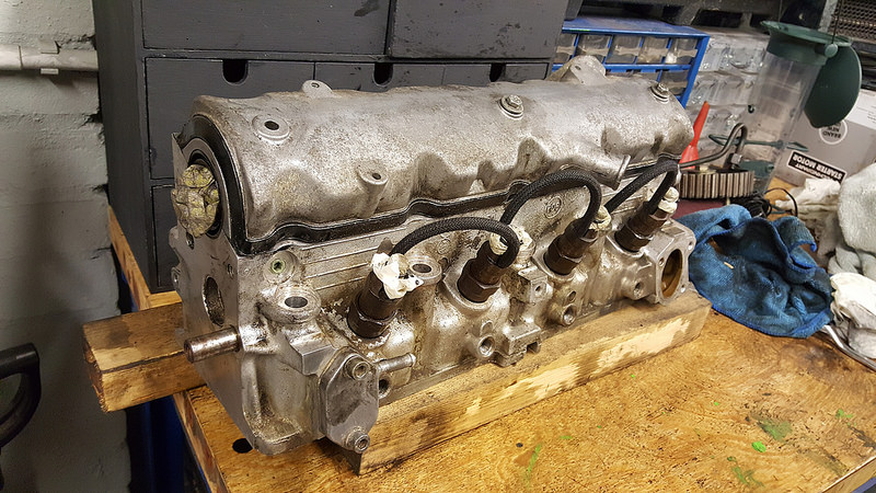

Camshaft out and refitted the rocker cover and packed with cloths to hold the tappets in place (decided to leave all the valves etc in situ) just cleaned the exterior and it's ready to go to the machinists to have a skim.

Lots on new bits to go on such as new fuel pipes, filter and TB rollers.

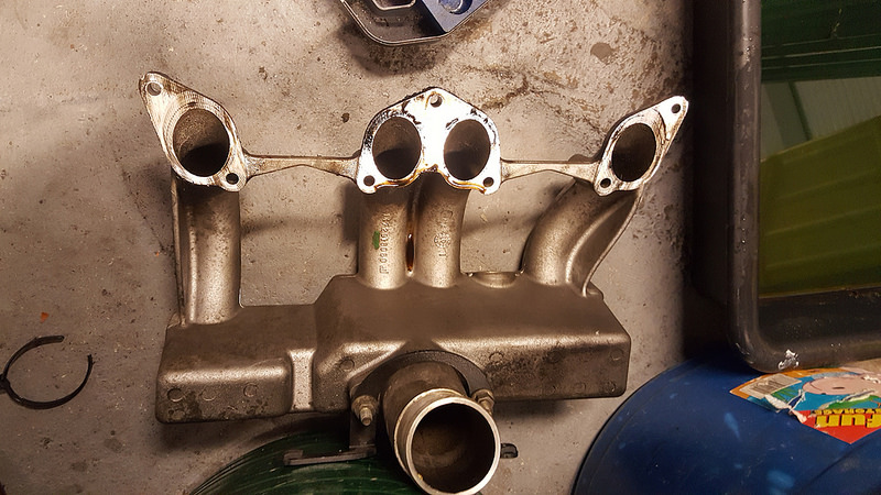

And I always felt the name 'Haynes Book of Lies' was a bit unfair because so far I've found the 'book to have been totally helpful for CX, GSA, BX etc. I never did have a Haynes for the XM. But the instruction for the inlet manifold middle bolt (that is totally invisible!) to be "only loosened because the manifold is slotted.."
I spent over 45 minutes trying to just loosen that impossible hex bolt (the only hex out of a set of cap screws....) to find that.... the manifold is not slotted there!!
Image20171123_201044 by Graeme McNulty, on Flickr
Not slotted! (top hole in the center)
So... yes, BOL indeed :)
