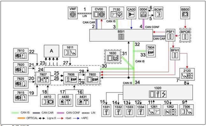

x 6945
Re: Xantia front rises on full lock
I thought about that too and checked in depth the function of the roadholding system including the flow charts and components and nothing is mentioned anywhere about the height correctors Mike, but a good point.
