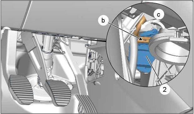

- Disconnect Battery
- Disconnect the connector for the blower control module at (b)
- Rotate and detach the blower control module in direction shown at (c)
- Remove the module (2)

Gary, that is just the parts diagram - here is the location (note this again is shown on a left hand drive, but the location will be identical - just on the passenger side well.

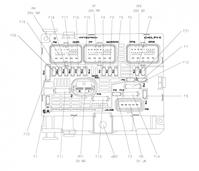

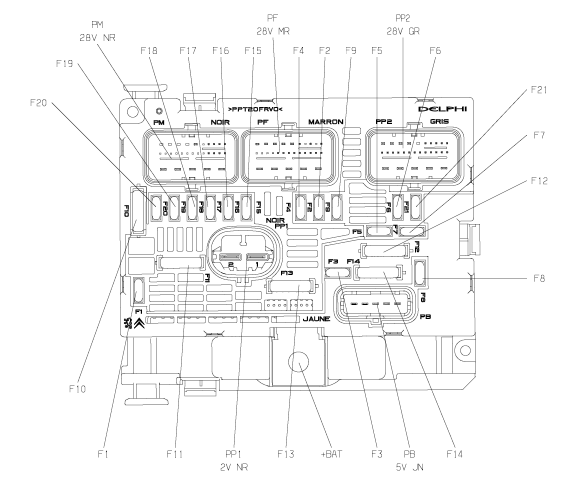

No problems. I just hope this is the culprit. I should of said also to check the fuses - and when I say check the fuse - I don't mean a quick look to see if there is a break in the middle. These blade fuses can suffer from galvanic corrosion - if any of the metal legs covered by the plastic of the fuse look 'milky', change the fuse.
The following are located in the engine Fuse box located as shown (click to zoom).
F11 40 Amp - Front A/C Blower
F10 30 Amp - Multi Function Motor Control
