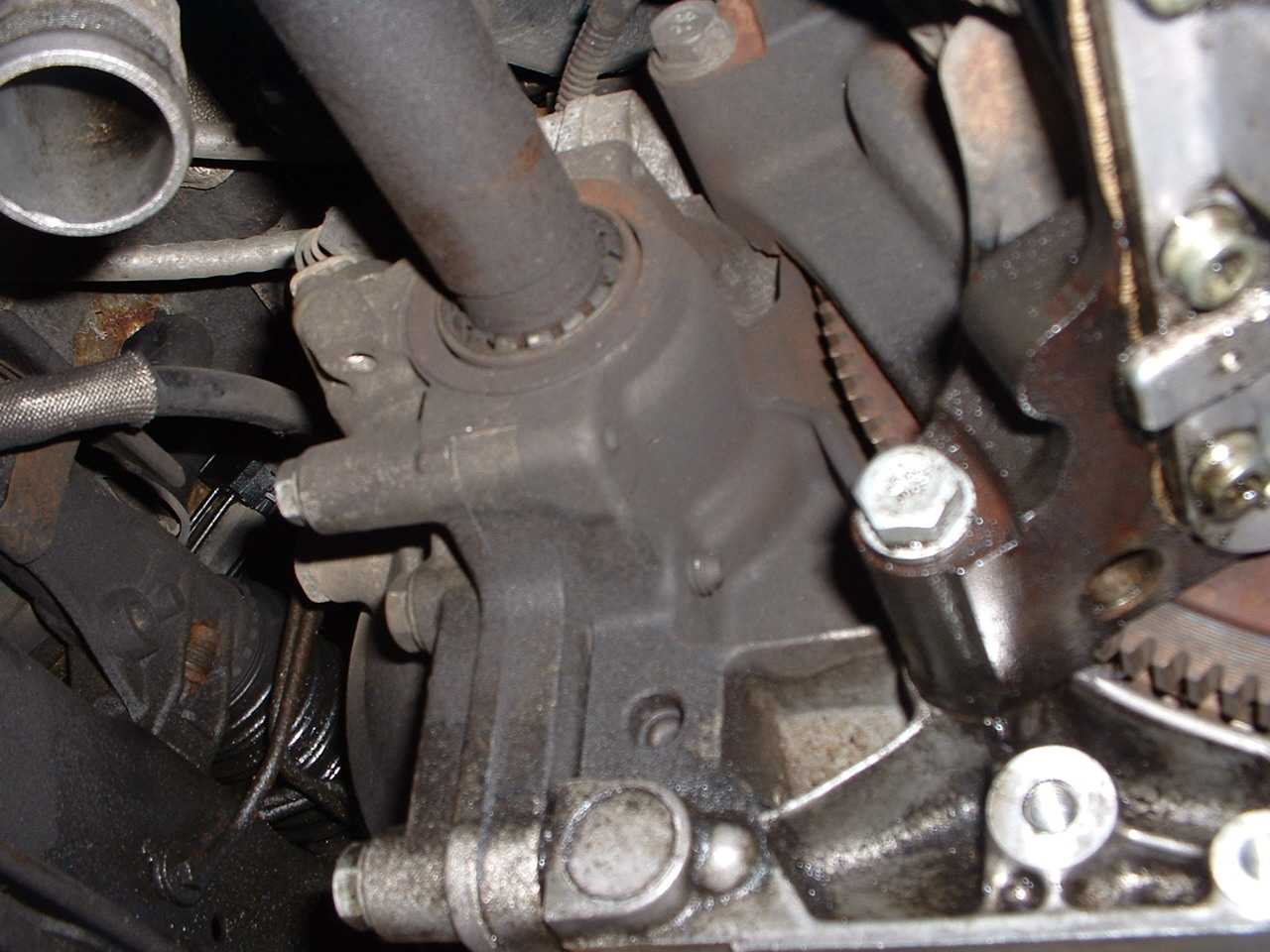

CitroJim I've made a start and got near-side driveshaft out OK.
Both driveshafts came out of the hubs without any of the bother you had ... however the off-side doesn't seem so keen. I had a re-read of your helpful thread and see that you left the off-side driveshaft in the hub and still managed to get the inner shaft detached. The intermediate bearing retaining bolts have been slackened and lugs turned 90 degrees so the driveshaft should pull out from the gearbox. There also doesn't appear to be a dust seal on the gearbox end of the shaft as mentioned in the BOL ...
[Cheers Myglaren]
Could I re-attach the hub and nut and try to free the inner shaft by using it like a 'slide hammer' or will that knacker the CV joints and possible separate the outer joint
[Cheers Myglaren]

Skull wrote: 05 Nov 2017, 15:27 Could I re-attach the hub and nut and try to free the inner shaft by using it like a 'slide hammer' or will that knacker the CV joints and possible separate the outer joint![]()
No, that will pull the inner tri-ax joint apart so don't do that... The best and only way to drive out the centre bearing from its housing is to wallop it from the gearbox side with a blunt-ended cold chisel (like a bolster you'd use on brick and stone) and a mighty club hammer.
You'll find a nice step/lip on the shaft you can drive against but do keep rotating the shaft as you go to even out the effect...
I've never yet failed using this method but you do need to be quite persuasive about it

Cheers Jim/Kenny I tried that earlier but only hit it once as it felt 'wrong' I will get angrier tomorrow .... cheers hope you had a good weekend ....

Skull wrote: 05 Nov 2017, 16:02 I will get angrier tomorrow .... cheers hope you had a good weekend ....
Yes, you do need to get very angry
I got so angry with one once, on a scrapper, that I smashed the bearing all to pieces in freeing it... That was an extreme case though...

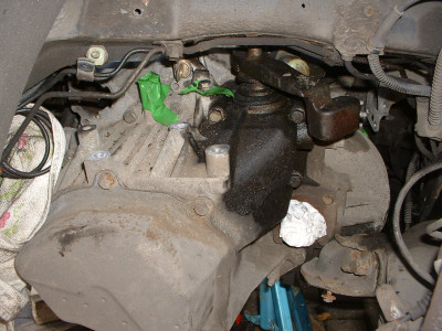

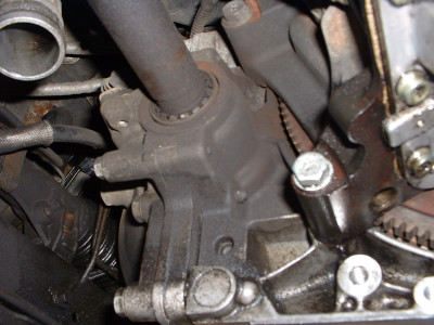

Driveshafts out
side of chisel worked .... I was worried about being too brutal as I thought that I was hitting the actual bearing rather than that 'shoulder'.
Most of the numerous other cables/pipes/air intake/LMH reservoir/regulator/abs bracket and other stuff including a headlight
just the gearbox connectors/mount and gear selector cables to sort before taking a deep breath and splitting the engine / gearbox ... I will shout if I get stuck / squashed .....

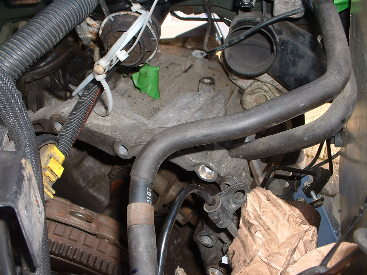

Progress ....but no what you'd call rapid CitroJim
Note regulator and pipework still attached but suspended and hidden in cardboard.
Split engine / gearbox replaced clutch kit and re-joined bell-housing.
Somehow during the process that went into the dark hours yesterday I've also managed to split a pipe
Haven't discovered which one yet but I think it will be in the differential area which I struggled with clearance issues on removal and especially replacement...
I couldn't find the corner that some of you mention to 'tuck' the gearbox into
I've managed to carry out this clutch change without disconnecting any hydraulic pipework (barring the leaking one!)
[Edit - The rubber pipework to the LHM reservoir was disconnected and plugged]
It occurred to me this morning (5.00 AM
for some bizarre reason) that if you were to place the suspension in high mode BEFORE dismantling and then support thoroughly on the chassis main body it would probably give greater clearance for the gearbox to be manoeuvred like this but with a bigger opening ....
Note broken brake pad wear cable (top) gear selector horseshoe would have cleared easier if stripped in high setting.
Still plenty to re-fit and still need to engage my home-made tool for engaging the clutch release bearing but there's no rush until I source a replacement pipe .....
