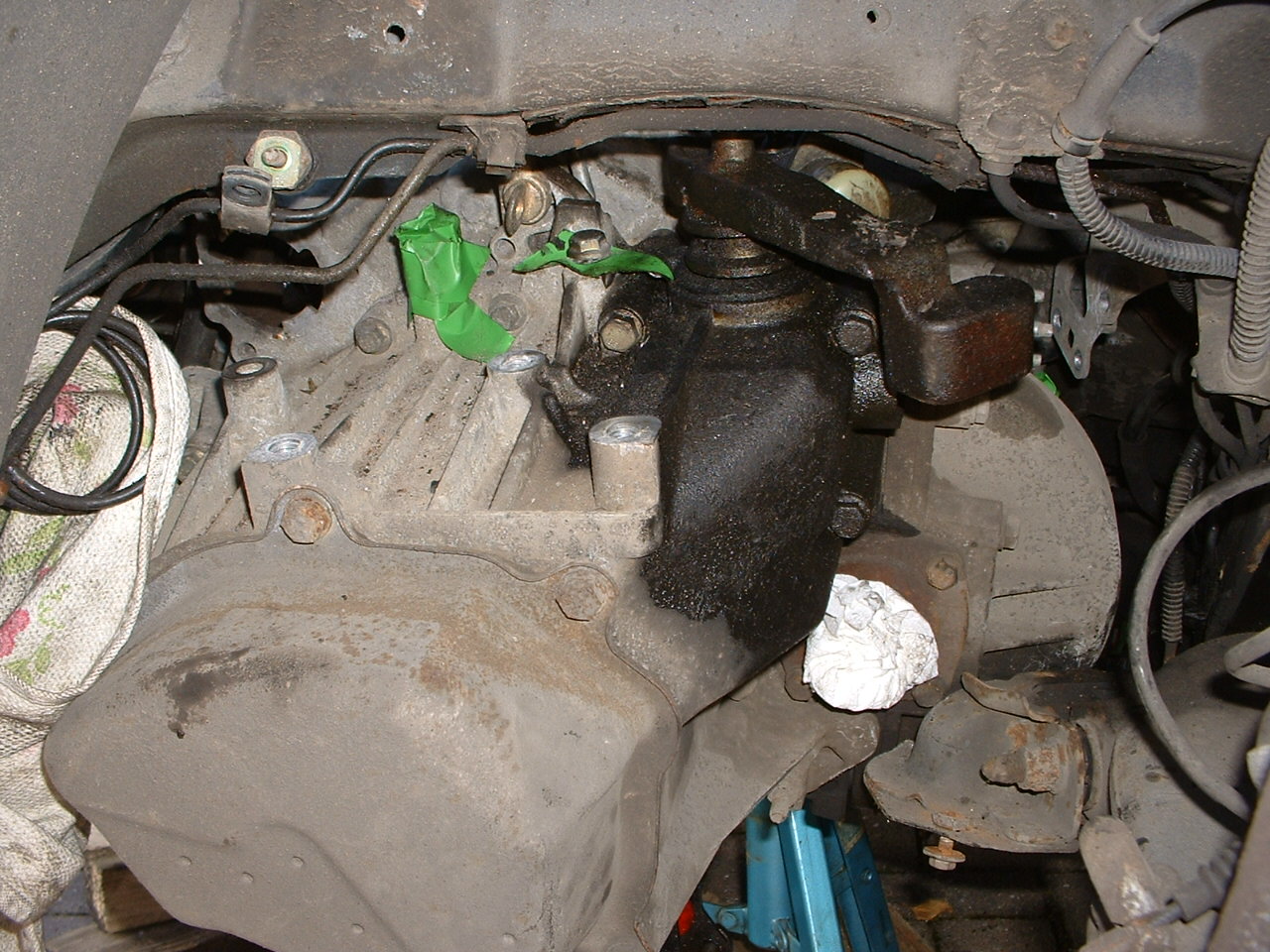

Progress ....but no what you'd call rapid CitroJim
Skull
Skull
Note regulator and pipework still attached but suspended and hidden in cardboard.
Split engine / gearbox replaced clutch kit and re-joined bell-housing. :-D
Somehow during the process that went into the dark hours yesterday I've also managed to split a pipe :oops:
Haven't discovered which one yet but I think it will be in the differential area which I struggled with clearance issues on removal and especially replacement...
I couldn't find the corner that some of you mention to 'tuck' the gearbox into :lol:
I've managed to carry out this clutch change without disconnecting any hydraulic pipework (barring the leaking one!)
[Edit - The rubber pipework to the LHM reservoir was disconnected and plugged]
It occurred to me this morning (5.00 AM :shock: for some bizarre reason) that if you were to place the suspension in high mode BEFORE dismantling and then support thoroughly on the chassis main body it would probably give greater clearance for the gearbox to be manoeuvred like this but with a bigger opening ....
Skull
Skull
Note broken brake pad wear cable (top) gear selector horseshoe would have cleared easier if stripped in high setting.
Still plenty to re-fit and still need to engage my home-made tool for engaging the clutch release bearing but there's no rush until I source a replacement pipe .....
