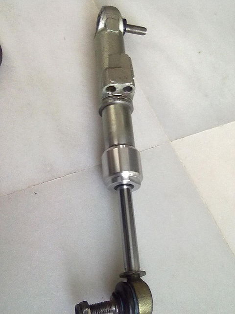

Xantia steering rack seal

I doubt it will hold up under the pressure to be honest.

Yes, the ram is scrap as it is so why not have a go. Nothing to loose
It'll be most interesting to hear the result...

Could a thread be cut on the ram body and a collar fitted to hold the seal in place ?

Stickyfinger wrote: 31 Oct 2017, 07:54 Could a thread be cut on the ram body and a collar fitted to hold the seal in place ?
Now that's a cracking idea Alasdair... No problem to cut a suitable thread on a lathe and make up a suitable threaded collar...

Re: Xantia steering rack seal
Will give it a go, nevertheless. Just out of curiosity to see how it's made inside if it will not work.
Was thinking about a thread also as I've seen it done before. So that should work and it would also work for activa rams...
EDIT: There must be also room for the return collar, so the threaded collar should be smaller than this on the picture...

xantos wrote: 31 Oct 2017, 08:30
Was thinking about a thread also as I've seen it done before. So that should work and it would also work for activa rams...![]()
That is an Activa front ram... Good mod...
Yes, the collar must be quite slim but that should not present a problem...
So all of you who threw away any of the activa rams be aware! They can be repaired!
If they are not to bad damaged on the inside it should be simple job. Cut it open, make a collar, thread cut to the body, change o-rings inside, assemble, job done! Wait, wait, wait... That simple? Can't be. There is a cath somewhere... I bet there is!
I've only ever thrown away one Activa ram and that was an irrepairable one because it had a scored piston..
I've been repairing them for years...
I'm quite aware of you page Sir Jim
It's the problem if it has too much internal leak, and that you must change the inside o-rings. Not possible without cutting it open (IIRC)...

xantos wrote: 31 Oct 2017, 09:34 It's the problem if it has too much internal leak, and that you must change the inside o-rings. Not possible without cutting it open (IIRC)...
If the piston is good then it's worth doing, given they're now NFP and as rare as hen's teeth... I still have a few that are repairable should they ever be needed...
For the collar repair, you could save a bit of machining time by drilling an fitting a couple of tangential pins, rather than threading.
