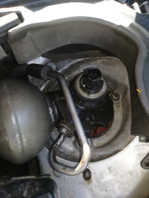

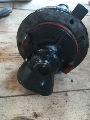

Here are pictures of the old and the new shock absorber. Is it possible to have air in the system? because there is no leak of hose
x 6945
Re: C5 X7 suspension strut fluid leak - Replacement mini guide page 2
You have the wrong one! - see my last post. The one in the top picture is for a C6 with AMVAR - not fitted to the C5.
