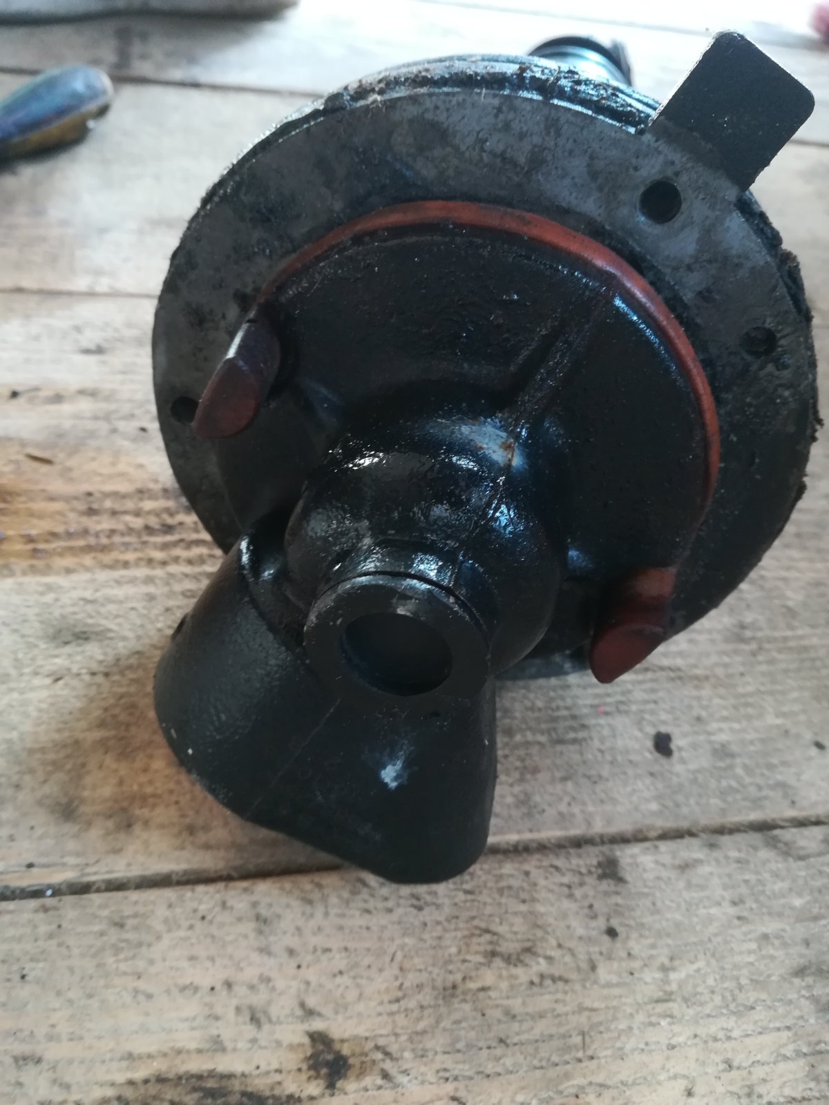

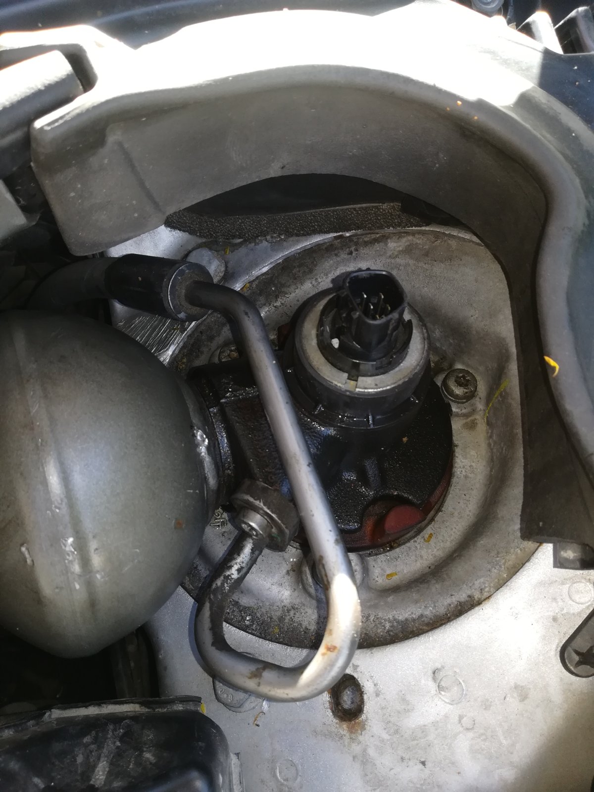

Here are pictures of the old and the new shock absorber. Is it possible to have air in the system? because there is no leak of hose

You have the wrong one! - see my last post. The one in the top picture is for a C6 with AMVAR - not fitted to the C5.
