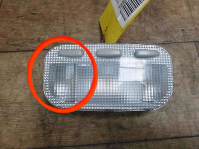

Re: Retrofit Electrochrome Mirror to C3 Picasso
GiveMeABreak wrote: 30 Sep 2017, 11:59 That would be a bit overkill IMO. The higher fuse rating for the cigar lighter would not be suitable for the electrochrome function and the wiring would be messy; the lighting function for the front interior lamp control unit and front courtesy light is handled directly by the BSI - so that might have unintended consequences mucking about with that.
Why in God's name would ceiling lights need to be wired through CANBUS.. is beyond me. Are the reading lights also needlessly complex to control? They seem to be mostly an on-off affair. (picture as example) Videos and pictures online reveal some pretty simple connectors; though I'm not sure whether or not they're just VDC and ground.
- x 6956
I was just using illustrating a point for example on the C5 X7, even the interior lights are monitored so that they will turn off after a maximum of 1 hour by the BSI. The courtesy lights are determined by the door module switches and BSI where before you had a simple on off whenever the door opened or shut. Now if the door is left open for a while it switches the lights off after a certain time.
Lets say that you find a permanent live in the reading lamp unit and wire it up. That would mean your electrochrome mirror would be powered up all the time, so draining your battery over time......

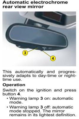

Of course Richard, you could of just switched it off using the small almost hidden button!
I suppose there has to be something said for reading the manual
Seriously though, I find it extremely useful, I also have the rear blind up permanently, which provides another layer of anti-dazzle. Living in the country, we have more than our fair share of 4x4 've-hicles' and with the newer ones with the LED lights, they are a dazzle disaster - so find this combo a great counter move.
Nope - there are 2 versions of the actual mirror, presumably from different suppliers. mine was switch free! Absolutely, certainly switch free. I would have loved a switch, I envied switch owners in the same way I envy Bentley Continental GT owners as they swish past on the autoroutes.
2009 versions had switch, mine was 2010 one. Maybe the change from 138 to 163 bhp was concurrent. Manual read several times and forensically examined. After initial blu tac success, I got the blue tac good and dirty so it was patent blac-tac and all but invisible.
Richard_C
- x 6956

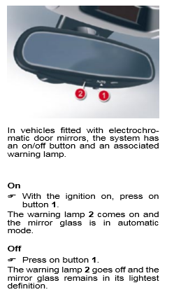

Ok, my bad Richard
- it seems that only the models with the Electrochrome DOOR mirrors have the switch: So yet another quirky variation in the specs - this is getting an art in deciphering PSA options! I think this one below is from C5 X7 handbook version 50!

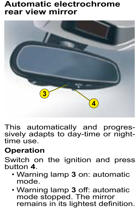

GiveMeABreak wrote: 02 Oct 2017, 12:49 Ok, my bad Richard- it seems that only the models with the Electrochrome DOOR mirrors have the switch: So yet another quirky variation in the specs - this is getting an art in deciphering PSA options! I think this one below is from C5 X7 handbook version 50!
Nope, I had that switch on mine -08 that was without dimming door mirrors.
- x 6956
Unless they weren't working!
