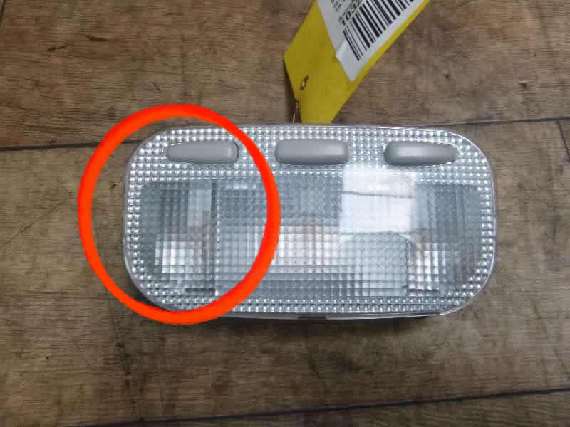

GiveMeABreak wrote: 30 Sep 2017, 11:59 That would be a bit overkill IMO. The higher fuse rating for the cigar lighter would not be suitable for the electrochrome function and the wiring would be messy; the lighting function for the front interior lamp control unit and front courtesy light is handled directly by the BSI - so that might have unintended consequences mucking about with that.
Why in God's name would ceiling lights need to be wired through CANBUS.. is beyond me. Are the reading lights also needlessly complex to control? They seem to be mostly an on-off affair. (picture as example)
Videos and pictures online reveal some pretty simple connectors; though I'm not sure whether or not they're just VDC and ground.
x 6955
Re: Retrofit Electrochrome Mirror to C3 Picasso
I was just using illustrating a point for example on the C5 X7, even the interior lights are monitored so that they will turn off after a maximum of 1 hour by the BSI. The courtesy lights are determined by the door module switches and BSI where before you had a simple on off whenever the door opened or shut. Now if the door is left open for a while it switches the lights off after a certain time.
Lets say that you find a permanent live in the reading lamp unit and wire it up. That would mean your electrochrome mirror would be powered up all the time, so draining your battery over time......
