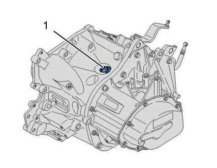

Reverse switch at number 1.

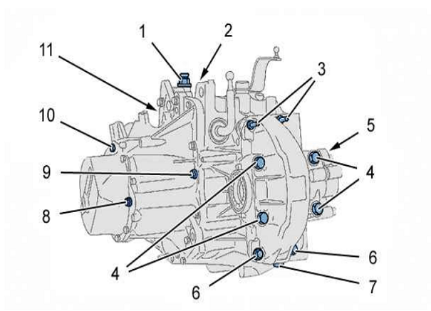

Could someone pleas get me the correct torque for each of these three nuts?
- x 6945
Re: Manual Gearbox Oil - Change, or Not to Change? That is the question.
Here:
| Reference | Designation | Tightening torque |
| (1) | Vent hole | 1,5 daNm |
| (2) | Reverse gear rocker shaft fixing nut | 4,5 daNm |
| (3) | Differential housing fixing nut | 1,5 daNm |
| (4) | Securing bolt (Ø M10) (Differential housing ) | 4 daNm |
| (5) | Speedometer drive support | 1,5 daNm |
| (6) | Securing bolt (Ø M7) (Differential housing ) | 1,5 daNm |
| (7) | drain plug | 3,5 daNm |
| (8) | Level plug | 2,2 daNm |
| (9) | bolts - gearbox casing - clutch housing | 1,5 daNm |
| (10) | Fixing nut for 5th gear housing | 1,5 daNm |
| (11) | Reverse lamp switch | 2,5 daNm |
