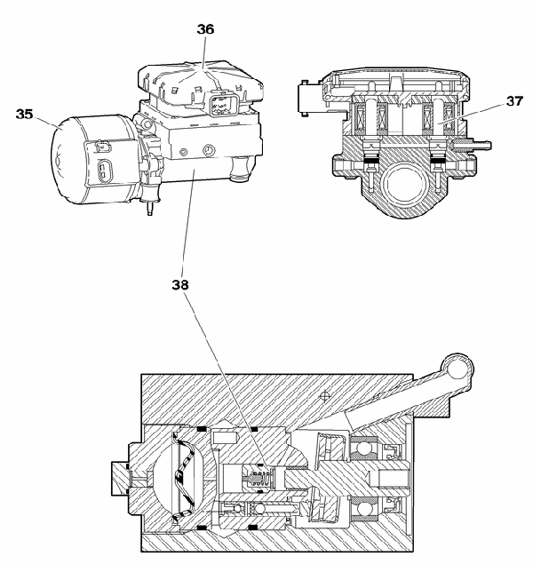

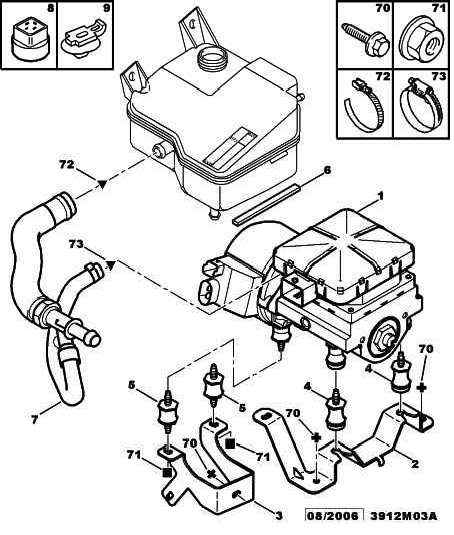

This diagram is the parts diagram for a 2001 Mark I Diesel (I've already said I'll need your VIN if you want the specific diagram for your car)
The LDS reservoir is the tank at the top.
In the following diagram (Part 1 in the diagram above) is the hydraulic suspension unit or the BHI and this consists of the following primary parts:
35 = Electric Motor
36 = Suspension ECU
38 = Hydraulic Unit (exploded underneath)
37 = Electrovalves

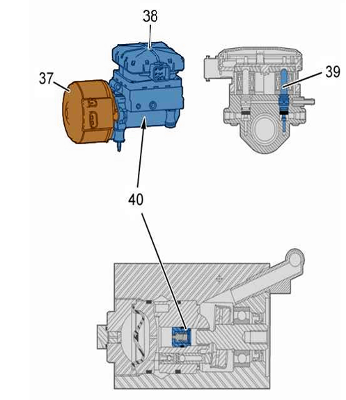

37 - Electric Motor (2350 +/- 150 rpm
38 - Suspension ECU
39 - Electrovalves
40 - Hydraulic Unit - Flow:- 0.7 litres per minute at 2300 rpm
Pump with 5 axial pistons:- Piston diameter: 6.35 mm
Anti Pulse hydropneumatic accumulator:- relief valve setting: 180 bars
Safety valve

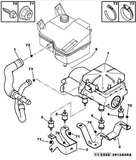

For future reference, the complete replacement BHI is part 5277 28, but these are now being replaced with 5277 A1 (No 1 BHI / Pump) + 5280 T7 (No 4 Centring Stud) + 6981 K7(No 73 Hose Clip) as original stock is no longer available on the following parts diagram:

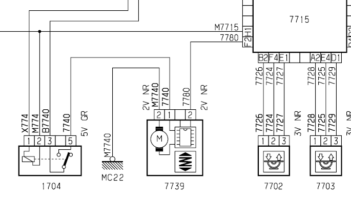

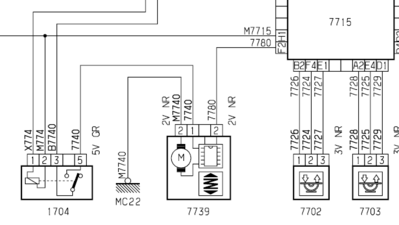

Ok, from what I can see, the central electronic block motor (7739), should have two, 2-pin black plugs. One of these has 2 wires, the other a single wire.
The 2-wire plug contains the earth (M7740) - the cables are marked if there is enough sheath showing. The other wire is 7740. 7740 is the Left-hand rear body height sensor + power supply, which goes to the relay (1704) - or I should say comes FROM the relay.
The other plug with the single wire, (7780) is the Electric pump unit motor command. This goes to the Suspension control unit.

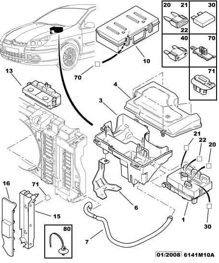

Does that relay live in the black box on top of the pump or is it in the box on the opposite wing.
Darren
x 6950
Re: Sus pumps. Diesel for petrol.
Maxifuse 8 in the Engine compartment fuse box (40A), but the relay box is number 10 on the diagram:
