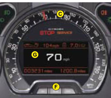

GiveMeABreak wrote: 28 Aug 2017, 17:01 Did you also put the original harness back in and reset the BSI before trying?
Re the brightness control - that's not on the steering wheel controls, it's on the speedo here at 'F' - you hold it until the desired brightness is reached, then it goes the other way.:

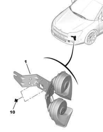

Here's the location of the Horn:
Got it thanks, No I didn't do a BSI reset but will do tomorrow. I mistakenly meant the steering control no 10 LHS to dim but I remember it reverses the centre console small display if you want.
