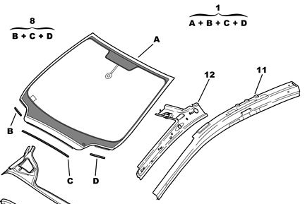

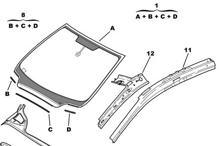

Ok, so you have the 307 5 Door Saloon 1.4 HDi 70 Manual 5 Speed
This is the windscreen that has the markings for the multifunction sensor, but does not contain the sensor itself.
The Multi Function Sensor itself (15), the Rain Detection Sensor Cover (16) and the Rain Sensor Support Cover (17) are separate parts, so the replacement windscreen will have nothing to do with the sensors - possibly just the pre-marking for mounting them.
So regardless of the windscreen, you should just fit the sensors back in place and deactivate the function if you do not want to use it. If you want to turn the function on or off (without PP2000) just follow this to deactivate auto lights:

GiveMeABreak wrote: 03 Aug 2017, 11:46 Ok, so you have the 307 5 Door Saloon 1.4 HDi 70 Manual 5 Speed

So does the sensor mirror fit the non sensor windscreen? I have an argument ongoing with axa insurance, the company "policy" which isn't in the insurance policy, is to have windows examined unless you have the car for an unspecified period of time. Seems they usually say it's an old crack and refuse payment. They use autoglass for the inspections and they commence the hard sell almost immediately, grrr. I'm going to have to bite the bullet and pay for it myself and the non sensor glass is considerably cheaper. BTW new bulbs and the fogs started to work, old bulbs works off a battery I got confused and left it at that!
