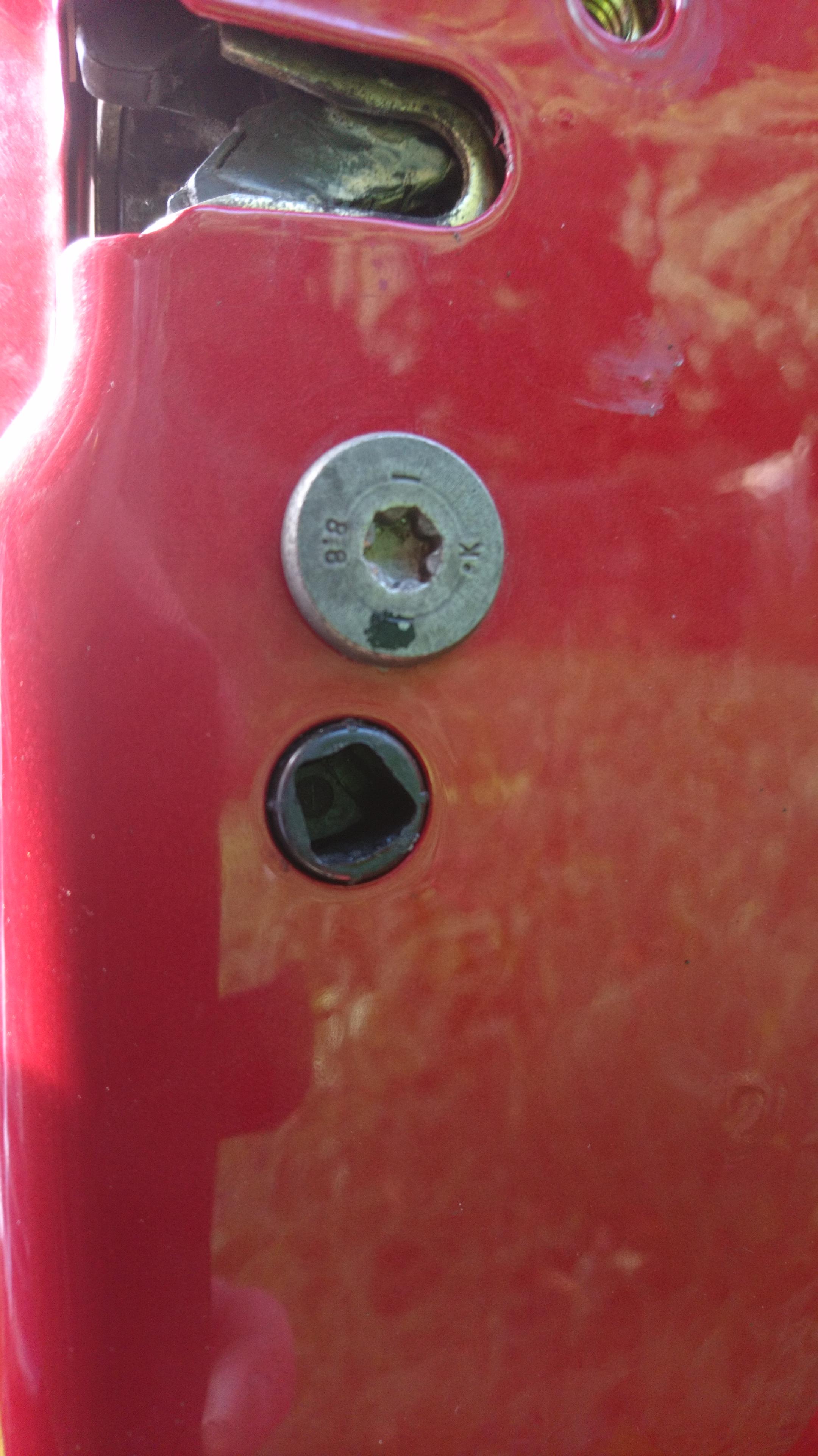

Have had a closer look at the lock and i can get it to do what it should ie disable the handle from opening when locked but only by manually tweaking the lock.
The black plastic insert in the door has a tab inside that when pushed with a prodding implement disables the outer handle, but can only be done with the door open. The door can still be opened from the inside, so guess this is also part of the anti hijack system.

this is a pic of the plug and wires that go to the lock.

Finally traced the fault to a broken wire, the blue one in the pic above.
It had rubbed through where the loom runs behind the window channel guides behind the speaker.
