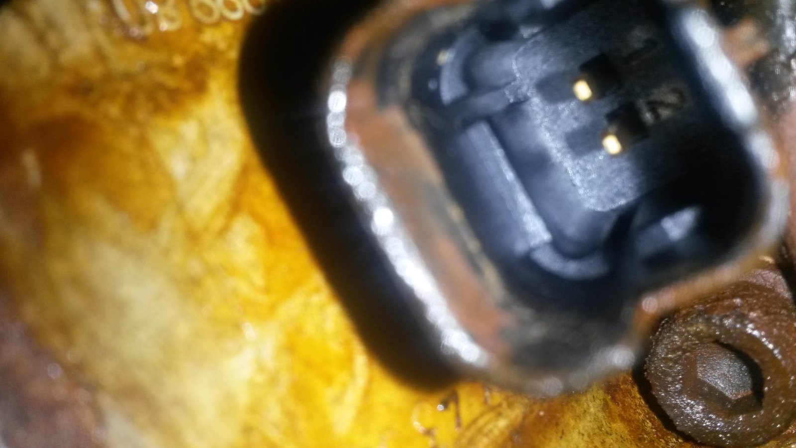

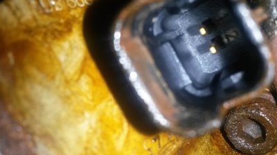

Looks like dried coolant to me, and likely not helping the connections in the plugs that are covered in it. First thing I'd do before spending money on parts is open up those plugs and clean up all contacts, noting any beyond a clean & either fitting new pins or bypassing the plugs for now. I'd suggest this might cure or at least help the starting issue.
Not sure where the coolant would have come from, but definitely needs to be checked/sorted too.

You'll notice that the crank sensor is just below the rad top hose and 'stat housing. Come to think of it, I seem to recall that ours died the day after I had bled the clutch slave cylinder (which is also just above the crank sensor) and I decided at the time that I must have spilt brake fluid on it. Maybe the crank sensor is particularly sensitive to contamination.ekjdm14 wrote: 26 Jul 2017, 12:35Not sure where the coolant would have come from, but definitely needs to be checked/sorted too.
I agree with the cleaning the connector suggestion now I have seen the residue on it.

Thanks guys for the good suggestions.
It's been raining today so can't do much, I'll also try to take better pictures from under it.
Yes it looks like leaked coolant it was before I got it and looks as though the fault has been repaired with new bracket to hose at the top and don't get any leaks now.

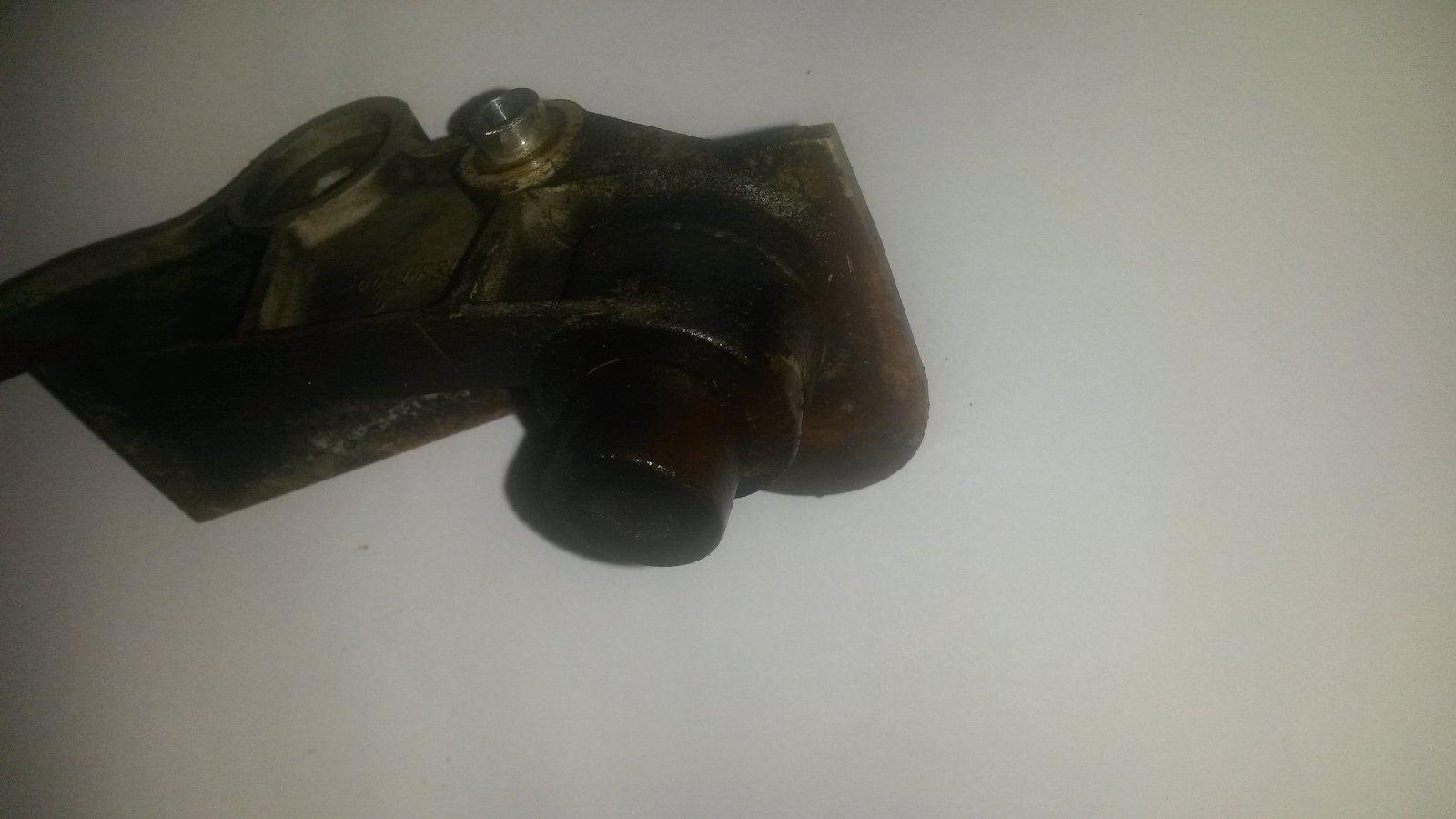

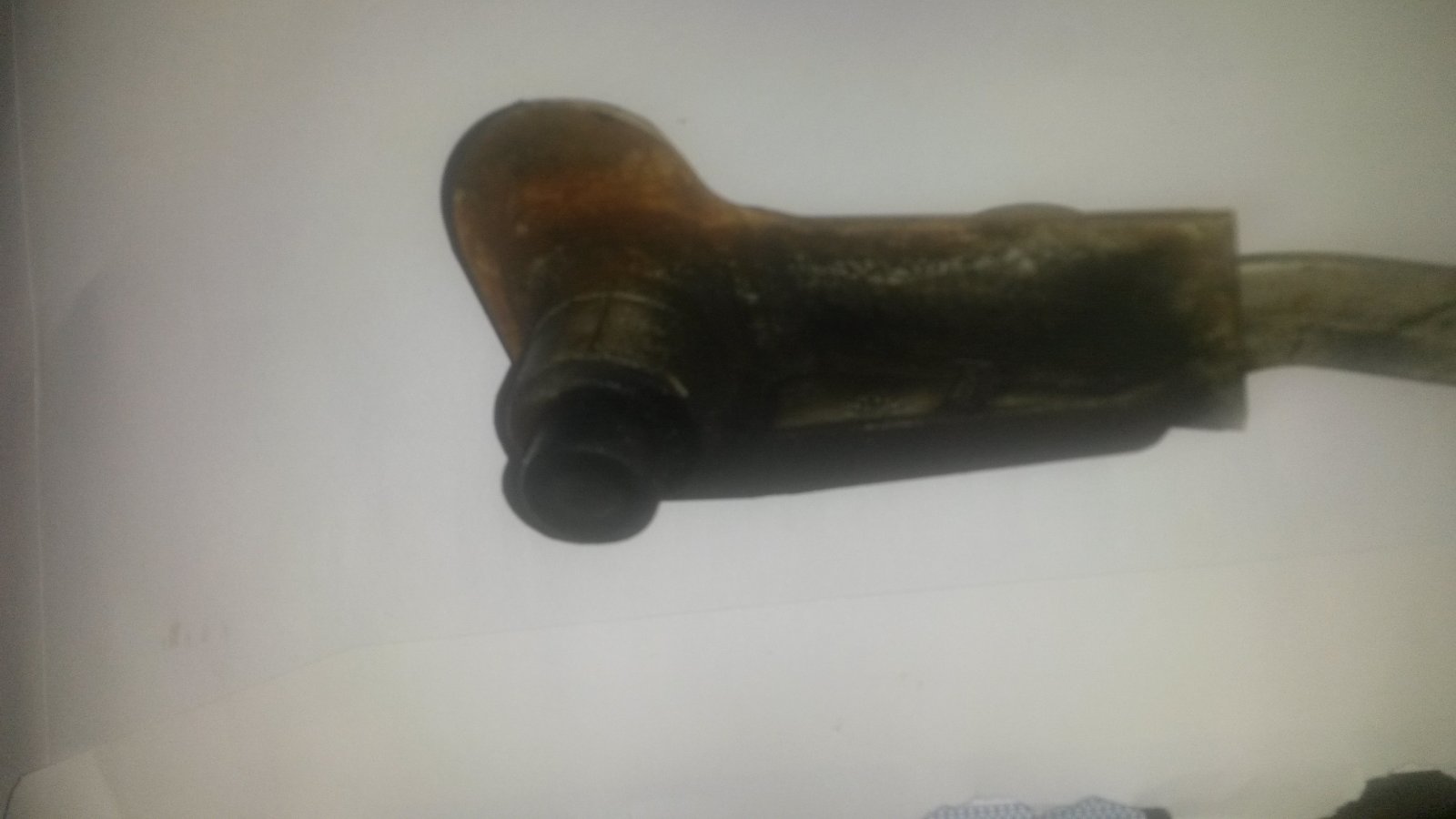

Just an update for you all I've taken the sensor out, easy if you know how. and some pictures.
The connectors all looked good and clean no residue on them or pins. But just on the wires and also some of residue had gotten in on the sensor itself.
Is it worth cleaning the sensor and trying or a new sensor is a must?

Re: Citroen C4 2005 Petrol, not starting.
Probably worth cleaning the sensor. But even if that doesn't work, I would still be minded to treat it with suspicion and replace with a new sensor before looking elsewhere.
