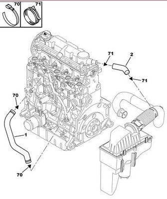

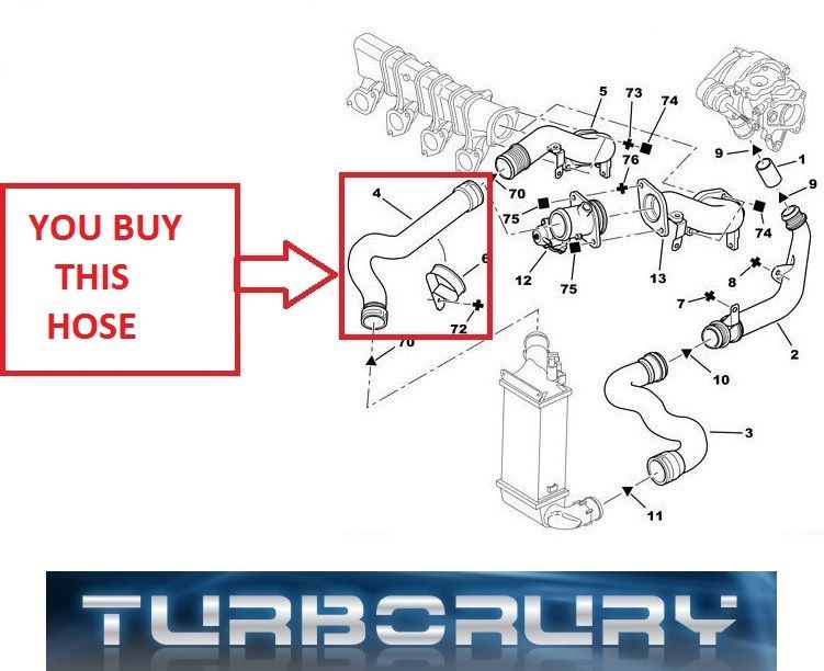

Re: just to confirm turbo failure
Oh OK I get what your saying, I will have to conjure a cunning plan to isolate the turbo and the breathers to see if I can see where it is coming from. i have attached a diagram of the breather system any input welcome. as you can see it is a simple enough setup.
Darren
MikeT
- Posts: 4808
- Joined: 11 Jun 2007, 16:17
- x 232
That looks like the air intake post-turbo. The engine breather (oil separator and pcv) system connects to the pre-turbo intake.

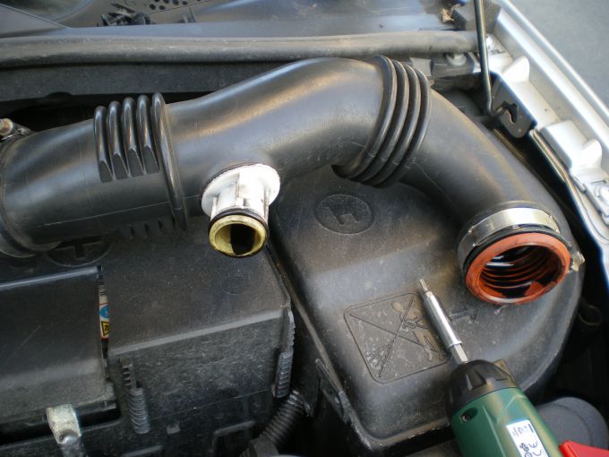

MikeT
- Posts: 4808
- x 232
This is my breather outlet circled in red (the cap at the other end of the camshaft cover is the oil filler cap), it connects to the air intake hose which connects the airbox/maf to the turbo intake.
Hi Mike, thanks for that mine is very similar and that pipe is clear there is no blockage or restrictions that i can see. Do you think i should pull the rocker cover is thhat what you did when yours was giving trouble?
Darren

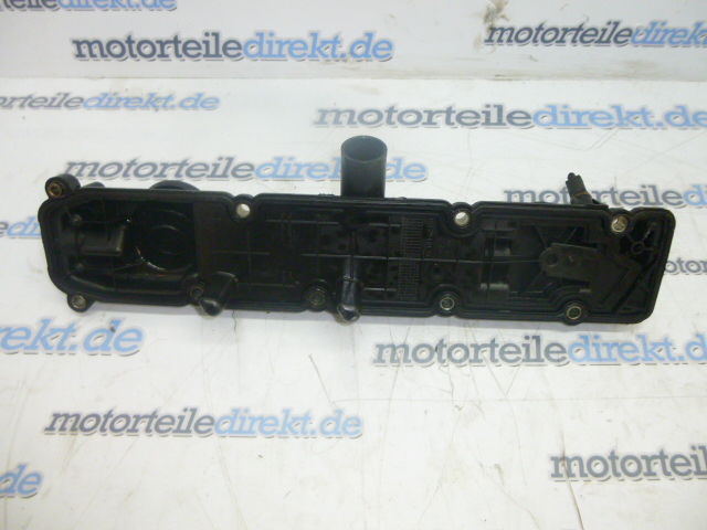

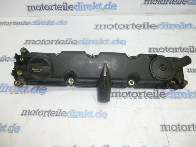

Hi Mike, I know the gaskets need to be replaced because they are leaking and one of the injectors has always been iffy so I am just fixing things that have been outstanding in that sense.but yes i am panicking a little bit I will try to be a bit more relaxed sorry Mike.I have attached photos of a rocker cover like mine
Darren

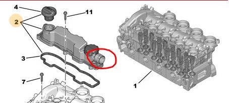

Ah, I did wonder why the injector, especially as you said it was running sweet.
From my point of view, you asked for confirmation the oil was coming from the turbo. If we can eliminate the oil coming from the breather system, I'd oblige. However, if you have the same push-fit connector that is on my engine then I can't, just yet
Pic courtesy of C4owners.org
If yours is like this, then no, it's not a push fit but uses proper clips.

Sorry Mike maybe we can help each other what is wrong with yours pipe apart from all the oil of course and what's with the drill. what should I be checking for on the rocker cover. mine is like that so yeah its clips rather than push fit
