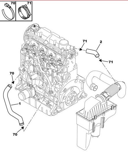

Oh OK I get what your saying, I will have to conjure a cunning plan to isolate the turbo and the breathers to see if I can see where it is coming from. i have attached a diagram of the breather system any input welcome. as you can see it is a simple enough setup.

Re: just to confirm turbo failure
That looks like the air intake post-turbo. The engine breather (oil separator and pcv) system connects to the pre-turbo intake.
This is my breather outlet circled in red (the cap at the other end of the camshaft cover is the oil filler cap), it connects to the air intake hose which connects the airbox/maf to the turbo intake.
