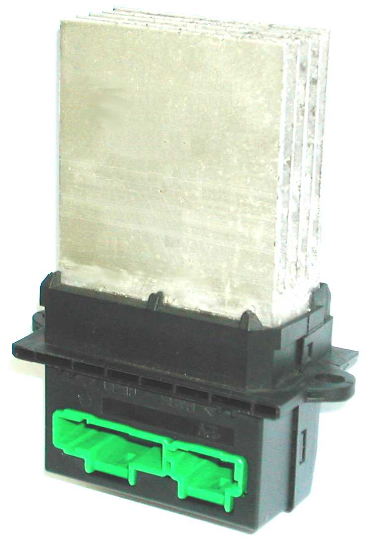

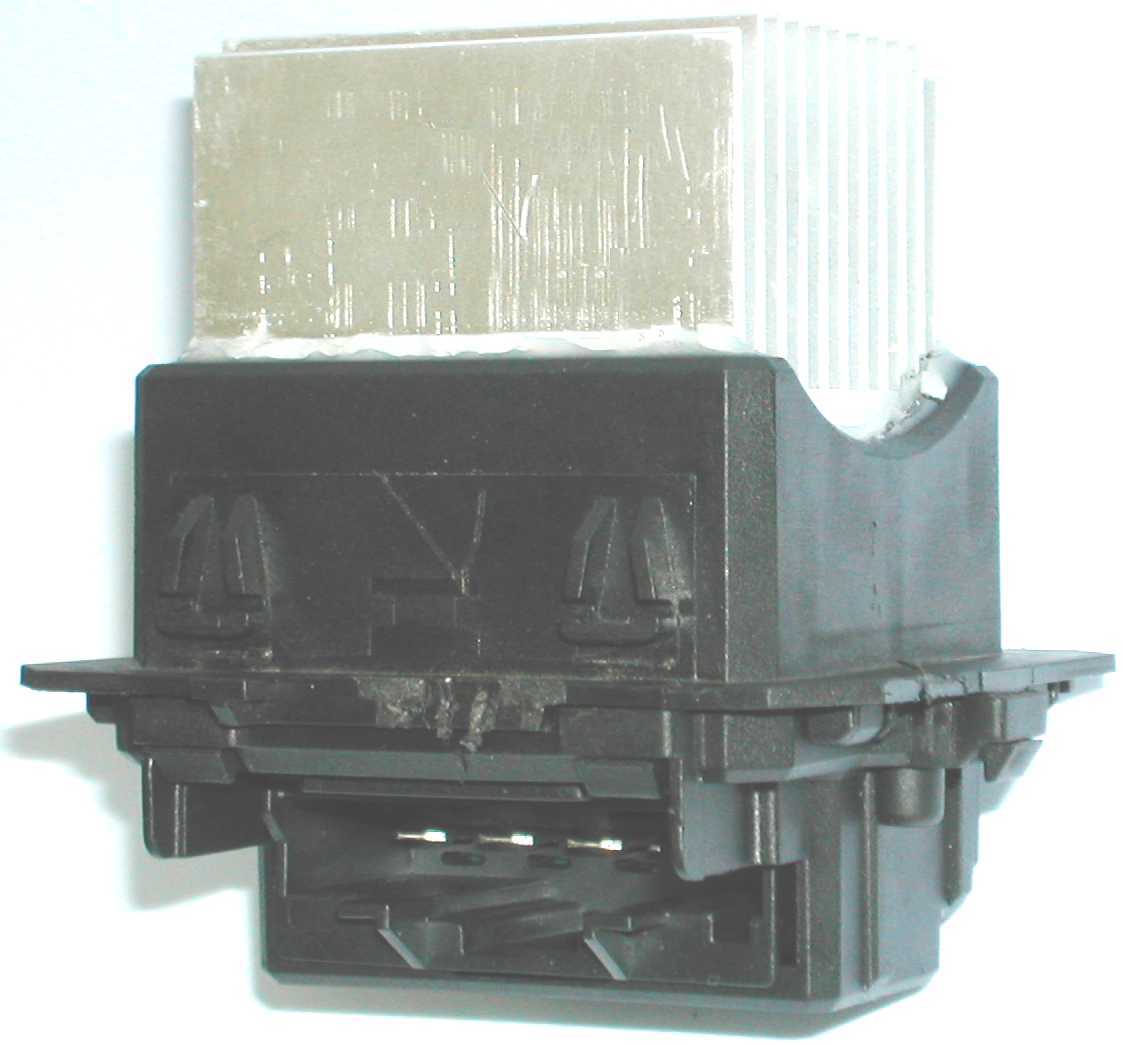

I must be missing something here. I thought your AC type is the climate control type. AFAIK that type doesn't have a simple resistor, it uses transistors.
Is your control pack like this
or like this
or like this

Paul-R wrote: 28 Jun 2017, 20:19 I must be missing something here. I thought your AC type is the climate control type. AFAIK that type doesn't have a simple resistor, it uses transistors.
or like this![]()
Neither of those Paul, see my photos back up this thread. The one supplied by the Ebay supplier is the first type pictured in your post.

OK, then it's the manual aircon type that you have. My bad.
Mine is automatic and the first type and I simply pinched the photos from the blower resistor site. I trusted that their second photo was correct. Maybe the big green resistor is inside that ally fin cover. Maybe it's the wrong photo. Or maybe that is the later type that needs the loom modification. I just don't know.
But if you're saying that it's just the thermal resistor on the end that's blown then they do a kit for £2.55 to fix that. Possibly worth a punt?
http://www.heaterblowerresistor.co.uk/c ... istor.html - ignore the fact that it says C3, it's only the shape of the mounting that differs.

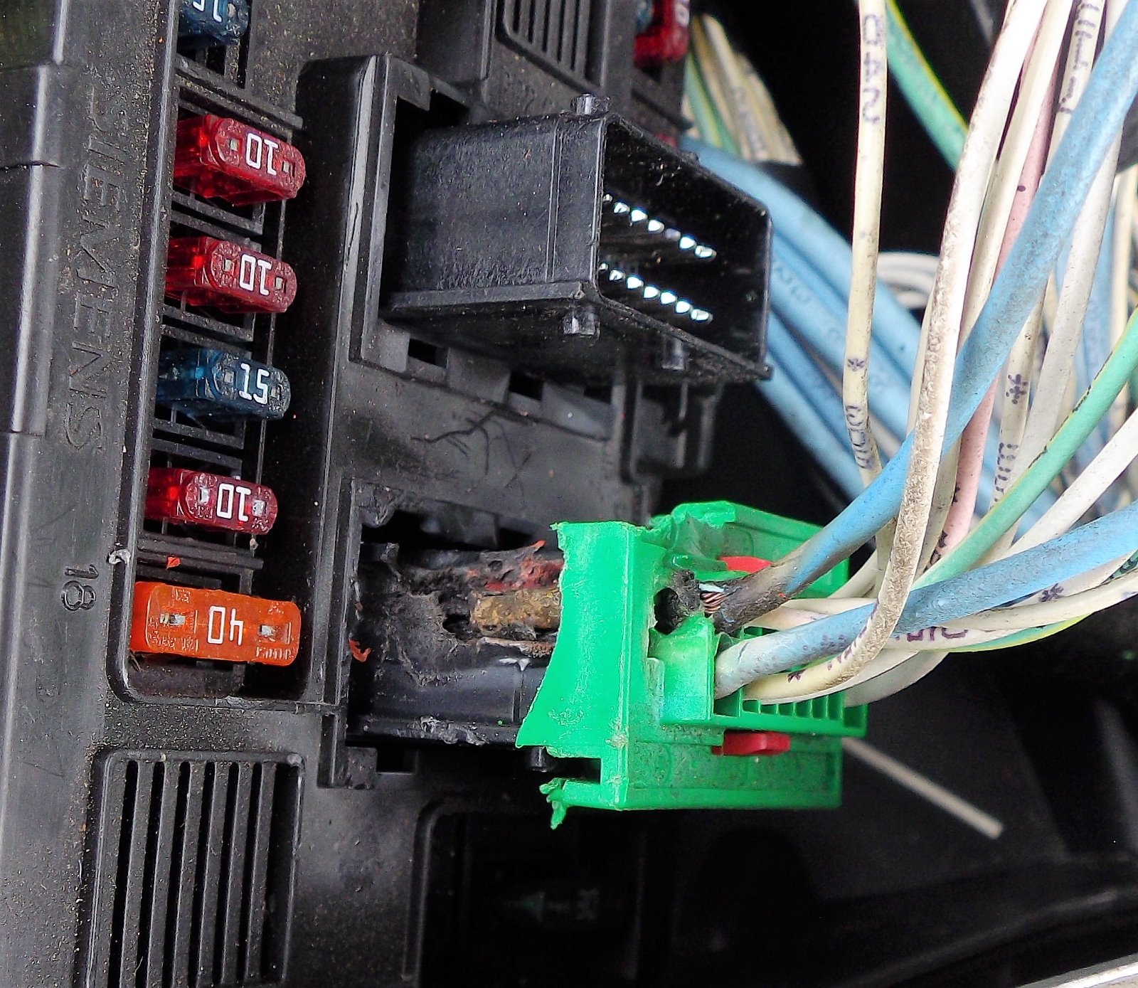

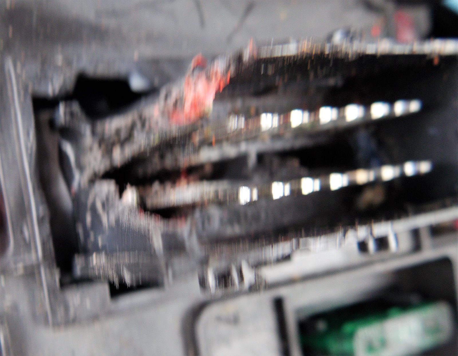

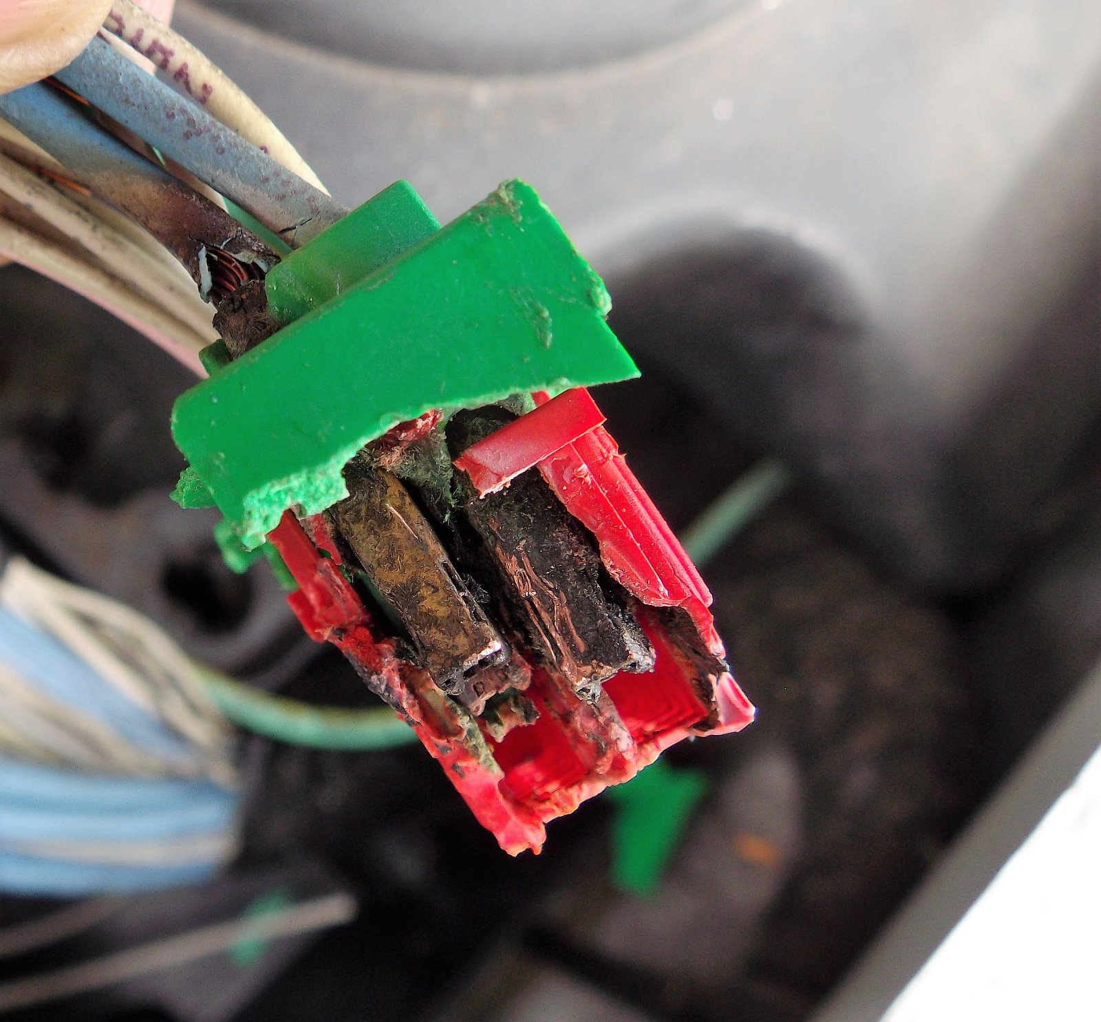

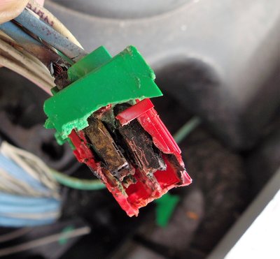

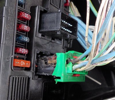

Re: Part number look up, please. Fixed it!
Those '99% it's the blower resistor' comments were wrong on this one.
Weather dried up so I went and had a proper go at it, this is what I found, had to butcher it badly to un-weld it:
So you're the 1%!
At least you've found out why. Well done and good luck on sorting the mess out.
Presume that's on the BSI? New plug off a scrapper will not be too hard, but fixing the socket end might be a bit more difficult... you may have to get a 2nd hand BSI and get it wiped, or get a set of BSI, ECU and keys from a scrapper.
- x 2941
Cleaned up the contacts and it's working for now, I will probably just by-pass the wires by snipping them off under the fuse box and soldering in permanent links if it stops working again.
Ah, the Gordian Knot principle. I like it.
