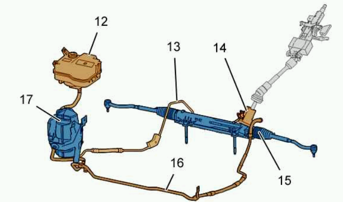

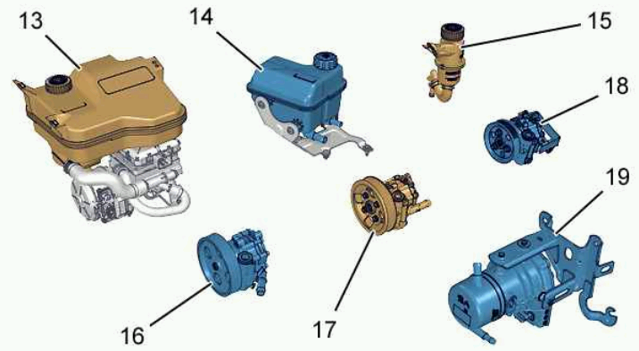

The LDS tank only supplies the fluid. On the X7 as an example, the power steering is operated via a separate electro pump (several models). On the X7 there are 3 types of tanks for the LDS depending on Metal / hydraulic suspension, and either coupled or electric pumps for the power steering depending on model.
On the X7, 13, 14 & 15 are the different tanks and 16-19 are the different pumps. On a MK II
The type is a Reducing flow power steering pump (engines EW7J4, DV6TED4 and DW12TED4), with the power steering pump being driven by the accessories drive belt. The EW10 and DE10BTED4 engines just have the Electropump type.
On the diagram below, 17 is the PS Electropump, 12 is just the LDS Fluid tank.

I was under the impression that on the early C5's the power steering was a standard belt driven mechanical steering pump, and the suspension was run by the electric pump, both sharing the same reservoir but otherwise separate systems ?
In which case no, the electric pump is not rated to continuously supply a power steering system. (Setting aside for the moment the fact that Diravi steering has totally different almost opposite pressure and flow demands to the conventional power steering found in a C5)

- x 6947
Re: Nissan Leaf powered Citroen
Mandrake wrote:I was under the impression that on the early C5's the power steering was a standard belt driven mechanical steering pump, and the suspension was run by the electric pump, both sharing the same reservoir but otherwise separate systems ?
Yes you are right Simon - that's what I was trying to say earlier - not designed for constant running.
