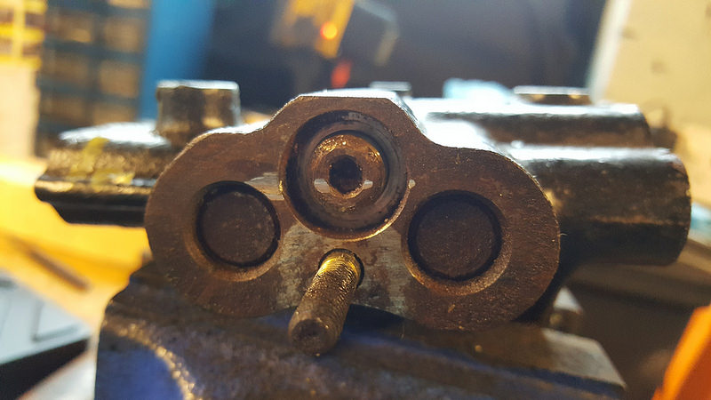

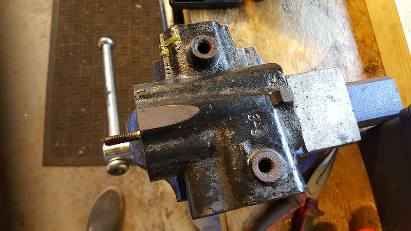

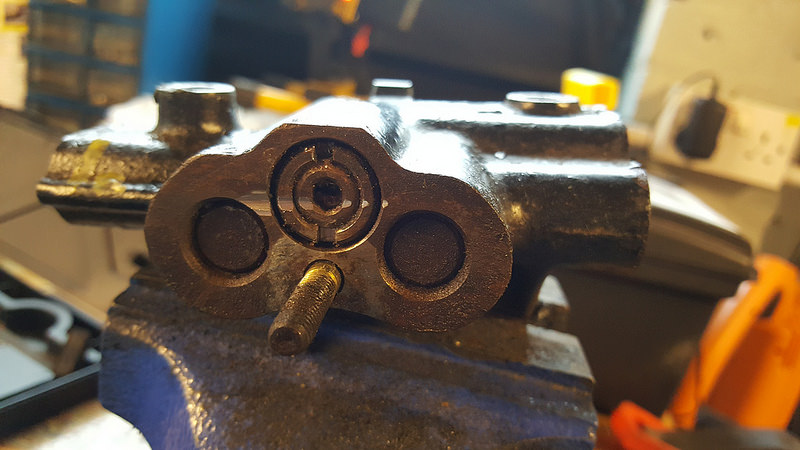

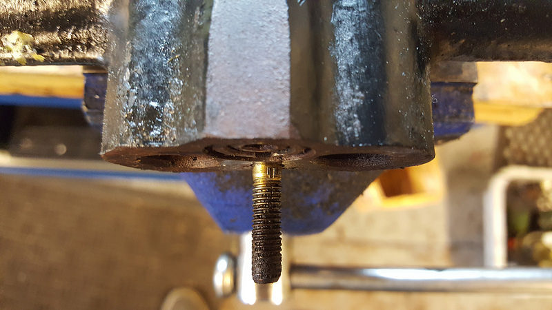

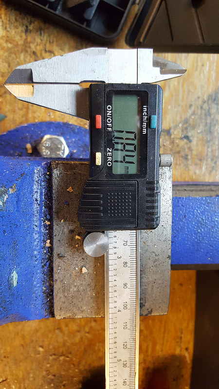

OK! I hope this info isn't too late for you but I have had a look at my spare FDV unit that came off my previous Xantia 1.9 TD SX 1993. It is an FDV that had no modification or any service work because I swapped the FDV for one I had serviced and shimmed etc.

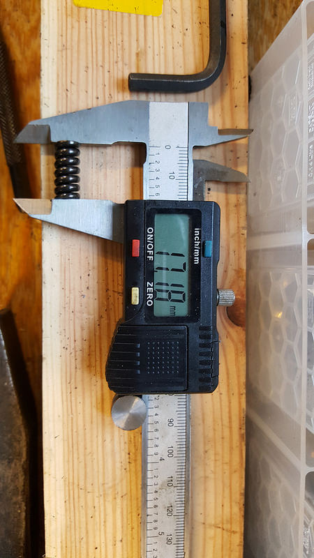

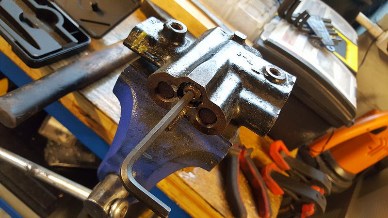

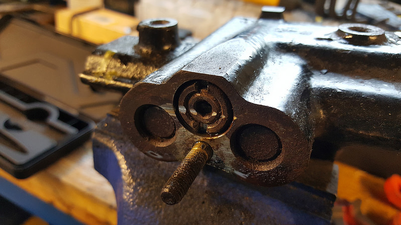

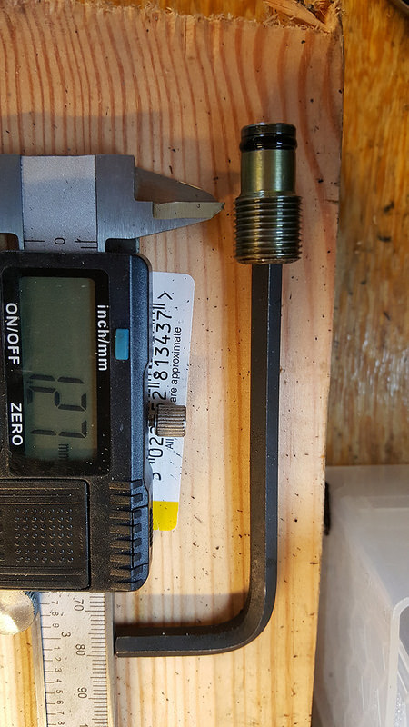

Anyway I measured the dimension of the screw/bolt to the outer surface of the FDV body (it was slightly recessed unlike what I said last week that it was level to the surface) The dimension is approximately 0.9mm. So, it is almose 1.0mm recessed on this FDV. I marked the position before loosening, I removed the lockring and counted the number of full turns until it removed (5 full turns). I measured the screw thread pitch to see what the distance between the threads is (measured at 1.27 on my caliper but obviously there's error as it is a manual measurement so it is probably 1.25mm). I measured the spring as well.

1. FDV ready to investigate

2. You can see the screw is recessed from the surface
Image20170416_191608 by Graeme McNulty, on Flickr

4. Measured dimension of the recess
Image20170416_191949 by Graeme McNulty, on Flickr
5. Lock ring removed, mark still visible.
Image20170416_192240 by Graeme McNulty, on Flickr
6. Screw thread pitch measured visually - about 1.25mm
Image20170416_192618 by Graeme McNulty, on Flickr
7. Internal spring measured - about 17.2mm
Image20170416_192940 by Graeme McNulty, on Flickr

So these are not exact measurements and it is possible your own FDV would differ in some way.. I don't know if this one differs from the FDV that is fitted in my Xantia because I didn't touch this screw on the FDV a few months ago, I only added a little 1.5mm shim to the first big spring of T1 valve like in the XM forum thread a few years back.
I hope this helps anyway since you lost the original place of the screw. If I was you I would wind the screw in to about 1.0mm less than the outer FDV surface to get the best likely result. :-D
