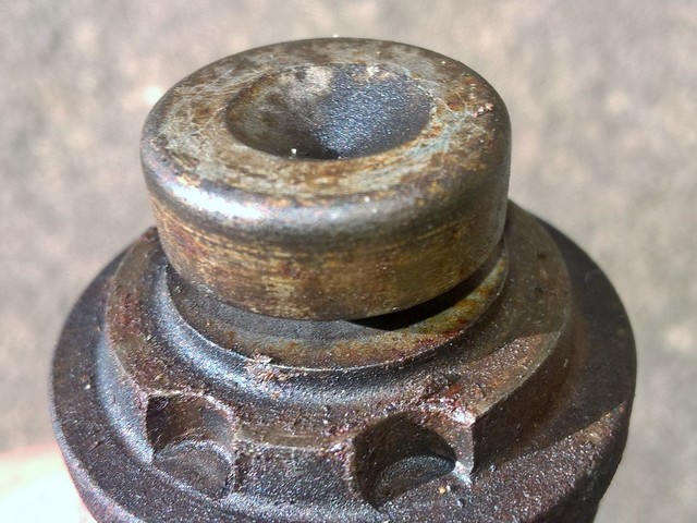

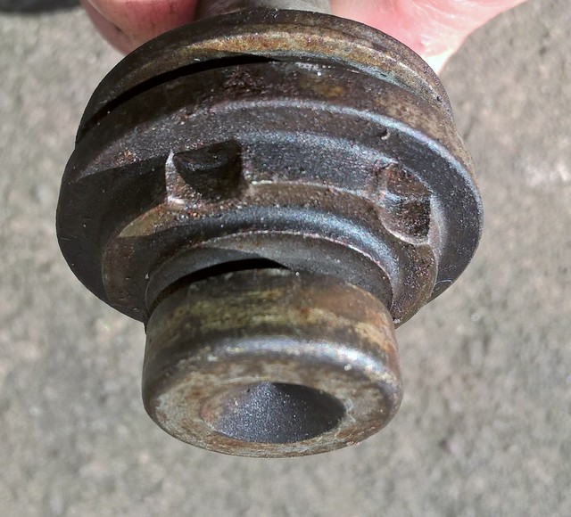

They don't look broken, they look the same as the ones on my C5, the "key" has four pins which latch the little cutouts. It should be in the car somewhere.Gibbo2286 wrote:I think that's broken, half of it has been ripped off.
- x 2941
Re: Alloy Wheelnut Adapter
I think the op has said he's already searched the car and been unable to find the tool, I still say the one in the op's photo looks broken, the round guide that the tool fits on has been broken off, it could of course be just the photo not being clear enough.Homer wrote:They don't look broken, they look the same as the ones on my C5, the "key" has four pins which latch the little cutouts. It should be in the car somewhere.Gibbo2286 wrote:I think that's broken, half of it has been ripped off.

I would agree they dont look broken too. These bolts have a weak point designed to shear if someone tries to force them. In they pic above the look in tact, you can even see them casting a shadow in the pic.Homer wrote:They don't look broken, they look the same as the ones on my C5, the "key" has four pins which latch the little cutouts. It should be in the car somewhere.Gibbo2286 wrote:I think that's broken, half of it has been ripped off.

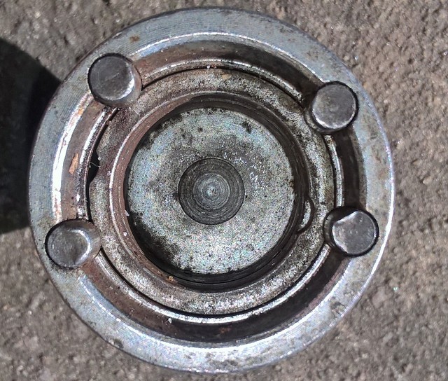

Like this oneHomer wrote: They don't look broken, they look the same as the ones on my C5, the "key" has four pins which latch the little cutouts.

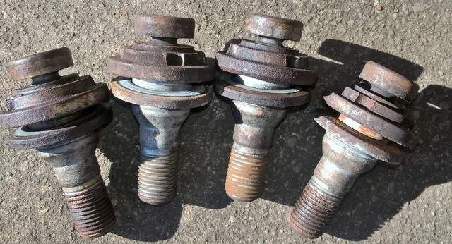

And no, it wasn't in the car. I was lucky, in a sense, in that I never got to use the bolt extractors as work took over my time. Inbetween I made a few phone calls, to Citroen and Peugeot, tyre places and motor factors but got nowhere. Yesterday, on my way home from work, I nipped into a back street garage I use for the heavy stuff I can't handle. After the usual insults about the s**t Citroens I take their I explain my predicament. "Blue plastic box over there. If you don't find one in there we ain't got one". Sure enough, amongst the huge amount there was, I found the above. The only comment I got on leaving was "Remember where it lives".
One hit with a cracking bar on each and all four came out with ease
