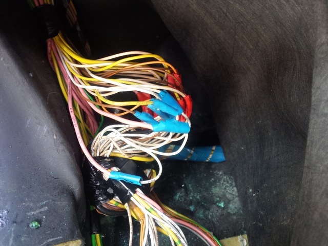

An update.. i left the interior lighting for now.. and moved on..
There was a non functioning fuel guage. After a bit of probing and proding i discovered the metal arm that holds the float was the wrong shape.. a bit of reshaping and its now roughly correct bearing in mind the orange light gives around 60 miles..

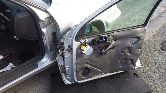

Happy with that the next was non functiong electric front windows.. posting else where i asked for wiring diagrams and location of relays. I got the wiring diagrams and armed removed the door card to check out the motors.. cable wires turrned out to be fine.. so it was door off
Throughly checking the harness showed wire insulation cracking up but only one small white wire broken... so that wasnt the issue

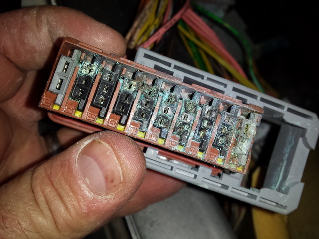

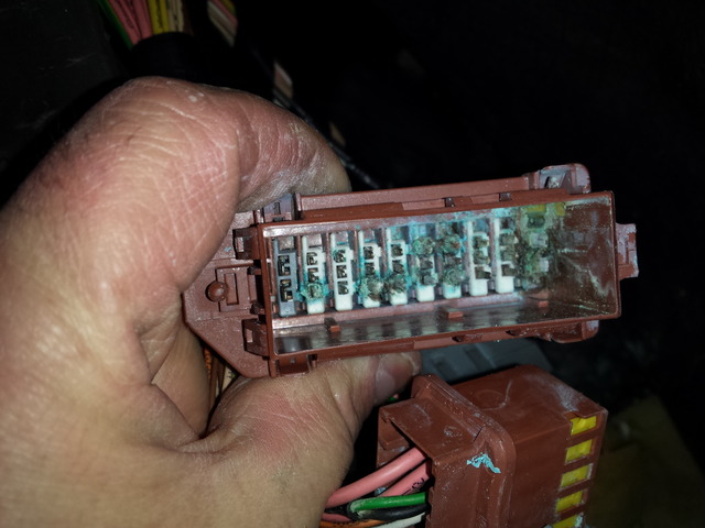

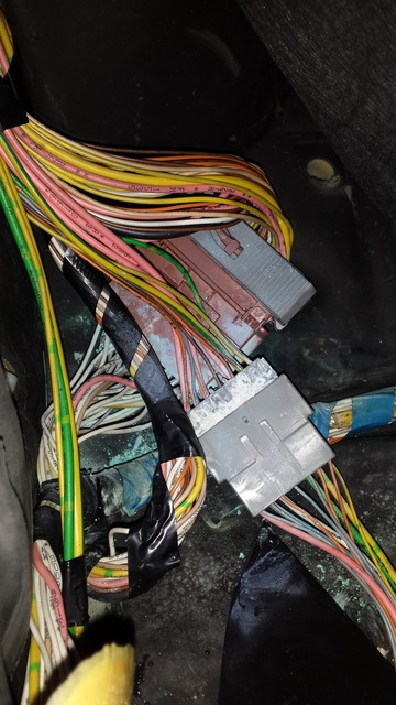

So centre console out i followed the door harness.. it comes out the drivers door down under the carpet across the drivers foot well.. up and over the centre .. and across to a plug on the passenger side.. this.. unfound untill after i took the centre console out to follow it.. so. I decided to lift the carpet on the passenger side and remove the plastic protector cover... and lo and behold all was revealed..
Yup.. water has been gettting into the plugs and has corroded the copper and a number of wires broke off.. including the feed to the windows.. a quick strip back and twist join temperary and hey presto working windows.. i now also beleve this plug is responsible for lack of B pillar illumination..

It's can be a nasty little surprise taking out that carpet. I did the same this weekend and had to bypass the other connector as I had similar issues. In my case I now have working remote locking which is very nice.

That's been wet for a while Paul...

See Jim, I told you that spray "Contact Cleaner & Protection Wax" was a good thing.
That look horrid !
Posts: 55032
x 8365
Re: Hi.......................... im back......
Stickyfinger wrote:See Jim, I told you that spray "Contact Cleaner & Protection Wax" was a good thing.
Absolutely, it would have saved that one...
I had the same problem with a connector in the passenger footwell in the original Rattiva... I had to cut it out and join the wires using butt crimps...
Main thing though is to check your floorpans for water ingress regularly and take prompt action if you find things a bit moist down below...

I think ill have to cut this one out too...

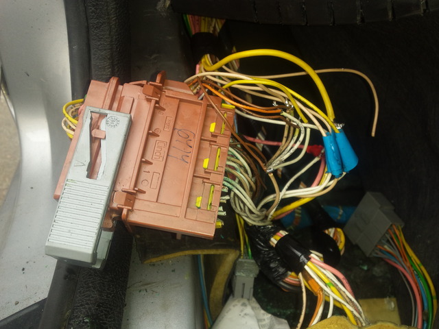

So.. i tackled the bull at the horns and decided to remove the plug from the harness...

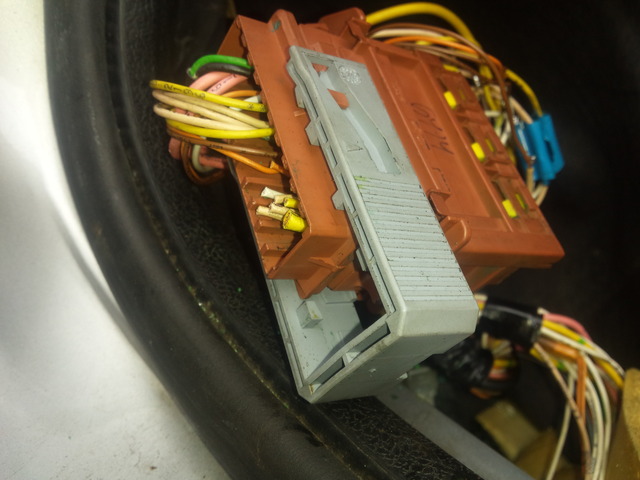

It took a good two and a half wires.. but i now swear by the paste flux for soldering!! Without it id have been stuffed as a few wires once cut away were copper corroded and all black and have never of soldered...
Half way break... lol
The finished resulting look...
All joints soldered nicely and strong useing flux paste and now to put back under the carpet.
The result . Well a couple of good results..
B Piller interior lights work again
The door open warning light from drivers door works now so i wont leave the lights on again
The alarm siren doesnt seem to have gone off after ten mins when locked with the plipper
Ao now to look at why the battery flattens after two days parked up..

Why did you solder rather than use butt crimps? Soldering can cause the joints to become very brittle and the wiring is brittle enough as it is :twisted:

I prefer soldered joints.. many a but connectors ive seen have been badly crimpped.. and there were quite a few very low current cables that would hardly hold.. then there were 4 very large higher current wires which i dont beleve butt connectors would carry for very long...
Bit of my harness working history showing through.. the cables themselfs were not suprisingly very brittle at all..
