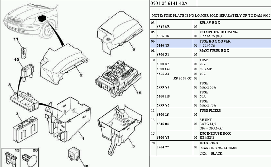

The relay box is located under the Engine Fuse Box Alex, as per this parts diagram, usually behind the battery. There will be a plastic cover to remove and then you will see the engine compartment fuses. The relay box (part 3) will be there somewhere and the relay in question should be a green 25 amp one with pins as per the picture below. The replacement relay part number is 6555 33. Click to zoom the pictures up.
