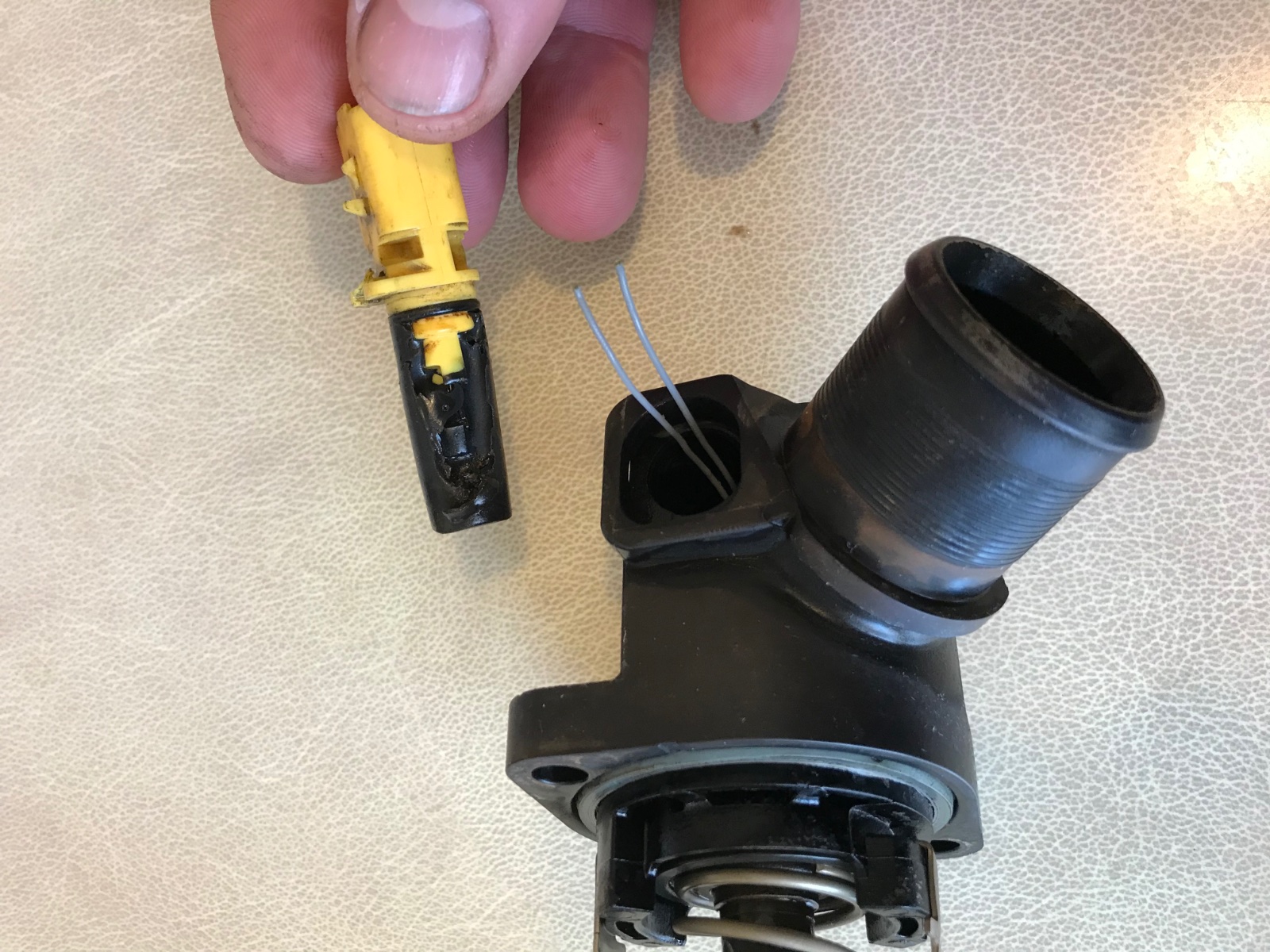

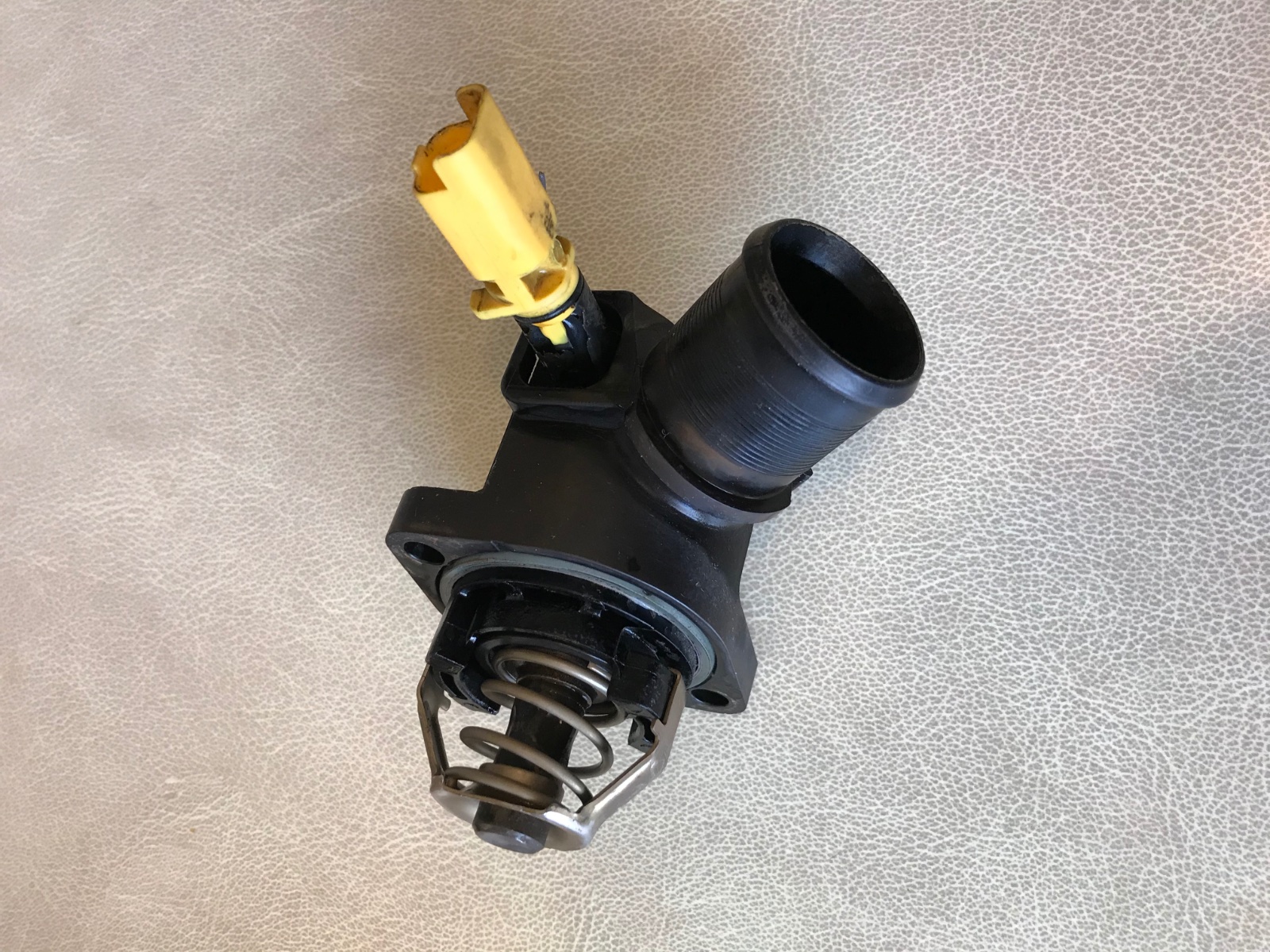

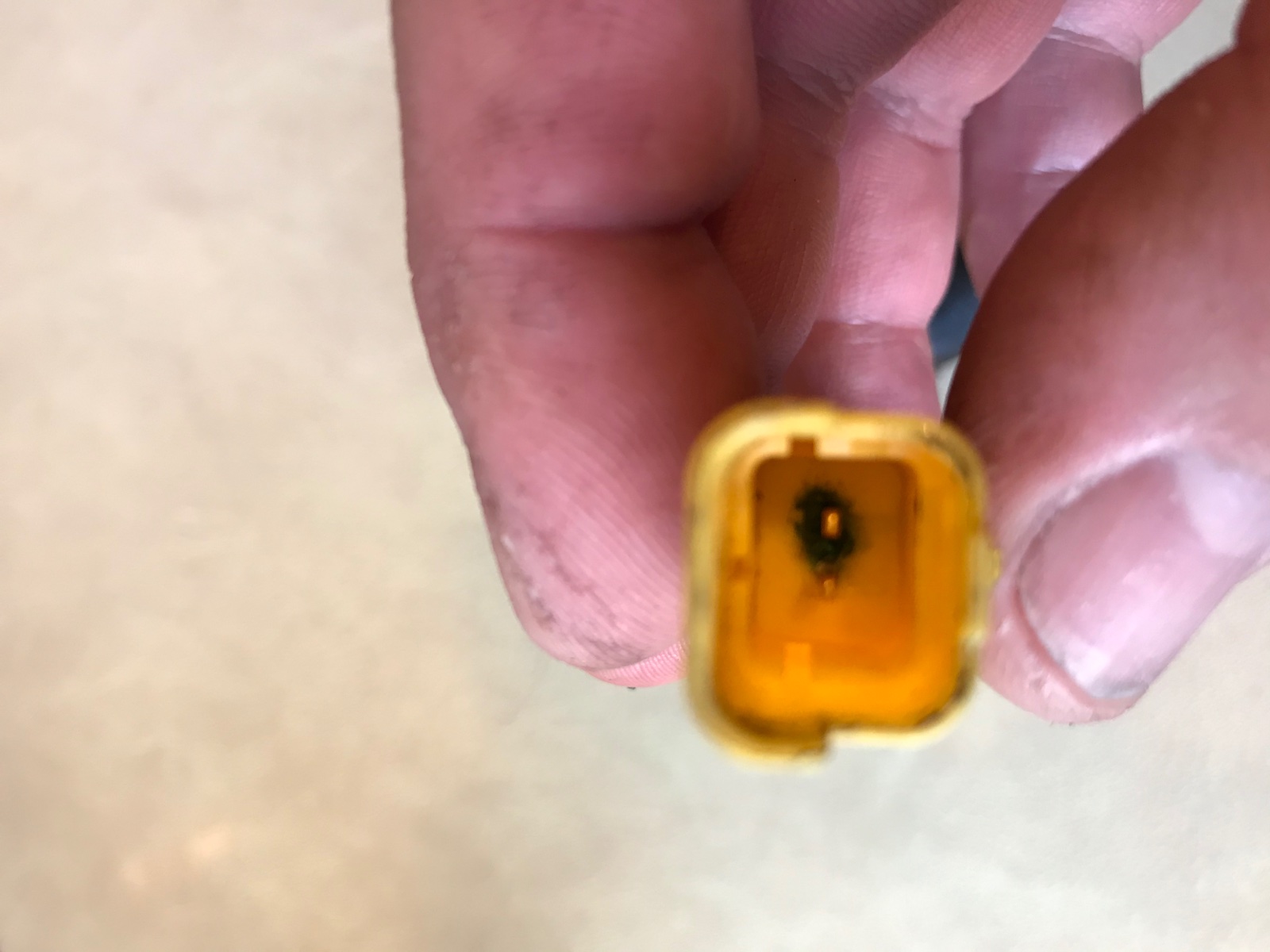

Re: Citroen C3 1.4 Fault Code P0598 What is the Cause?
Hi. First post on here. Had code P0598 on my daughters 2007 C2 and found corrosion on contacts of yellow thermostat temp sensor located under thermostat housing. In my ignorance, assumed sensor was a separate part and attempted to twist and remove only to discover its moulded in, so removal snapped the sensor wiring and is unrepairable. Not overly bothered, as think the corrosion was the cause of my fault code, so changing anyway.
