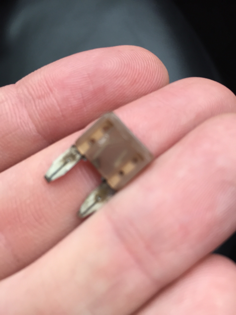

Hell Razor5543 wrote:I will suggest you put the fuse back, and then remove it (and repeat a few times). My rear wiper was not working. When I checked the fuse (with a multi meter) it was good. After I did what I suggested the wiper started working again. I think there was surface corrosion on the fuse and/or contacts.
Thanks will try that

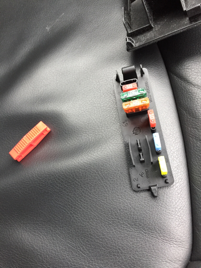

So switched the car on today and the an airbag fault came on. If left the fuse out from last night and realised I'd pulled out F3 instead of F7! [emoji85]which I found this morning had indeed blown
Found the spares and clip (thanks Marc)
And now the map lights and glove box lights work [emoji4]

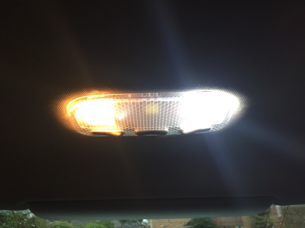

Re: Interior Lights
Unread post by hoggers »
Still missing one but gives you an idea of the difference
Sent from my iPhone using Tapatalk
x 6955
Re: Interior Lights
Tidy - I hate the yellow lights, so am deciding whether to go amber or ice blue like the rest of the interior. Don't want it to be too much like the dance floor in Saturday Night Fever though!

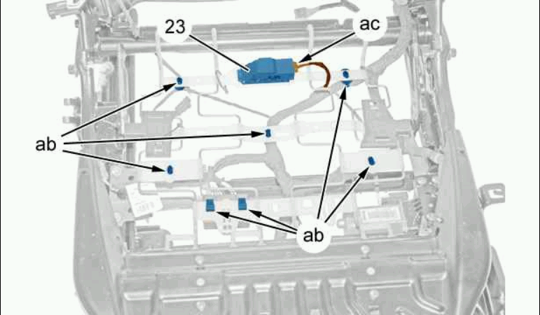

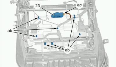

Regarding those underseat lights - they are not immediately visible - you'll need to raise the seat heights way up and forward towards the front to be able to get underneath to see what's there (don't forget if you switch engine on and hold the 'M' button down for 5 seconds, then let go and hold either button '1' or '2' down until you hear the bong, that will retain your current driver's seat positions, rear view mirror settings and air con temperature settings automatically. Just press the same button once to restore everything. Invaluable as it takes me ages to get my seat in a the perfect position and saves having to adjust it all again!
Here's the underside of the front seats - you can see (23) is the light - it is just protruding from the cable harness and cable tied to secure it! Accessible from the rear compartment as it is located nearer the rear of the front seat. Standard W5W like the rest of the interior lights.
Front Under Seat Lighting
I think I had to snip the cable tie to release the light unit, change the bulb, then replaced the cable ties to secure it, otherwise it will dangle and get caught - so if going for it make sure you have some cable ties.

GiveMeABreak wrote:Regarding those underseat lights - they are not immediately visible - you'll need to raise the seat heights way up and forward towards the front to be able to get underneath to see what's there (don't forget if you switch engine on and hold the 'M' button down for 5 seconds, then let go and hold either button '1' or '2' down until you hear the bong, that will retain your current driver's seat positions, rear view mirror settings and air con temperature settings automatically. Just press the same button once to restore everything. Invaluable as it takes me ages to get my seat in a the perfect position and saves having to adjust it all again!
How do you know all this???!!
