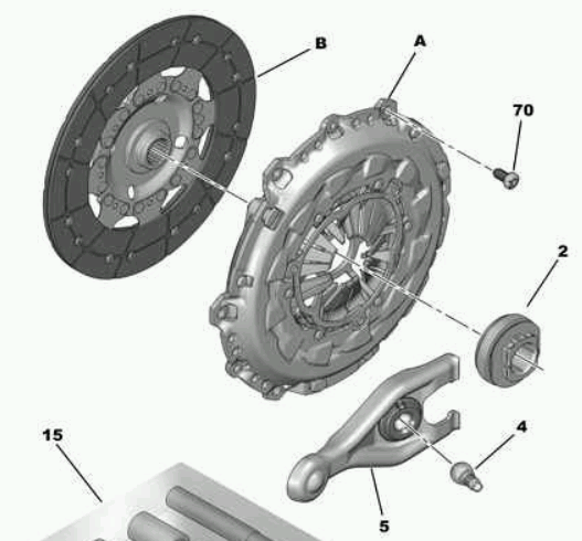

I don't think so - not on this specific model. As we are talking about the piloted system that part C is another £146, whereas the clutch release bearing buffer on the manual system is only £28 - and I think this is the part you are talking about Paul - shown in the diagram below - part 2 is always recommended to replace with the clutch.Paul-R wrote:But not recommended to replace it at the same time as the other two items?
