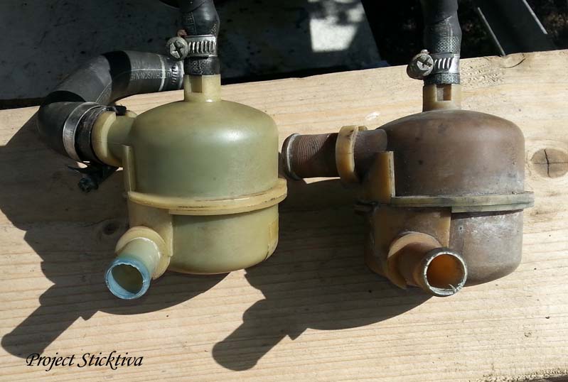

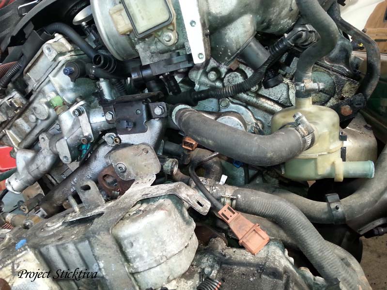

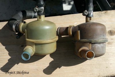

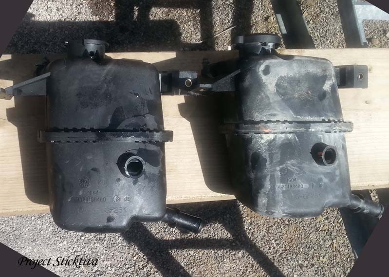

These are the hj coded parts, nearly new and old....the OP image is not for certain...fitted and the matching expansion tank (for the Xantia)
Do your rubber pipes match those shown ?

Stickyfinger wrote:These are the hj coded parts, nearly new and old....the OP image is not for certain...fitted and the matching expansion tank (for the Xantia)
The pipes on your bottom pics (of the white tanks) match mine on my XM. The black tanks on the top one are nothing like mine... which is all very confusing! :roll:

Sticky has posted pictures of the Xantia V6 parts. The degassing tank and 19mm hoses are similar to the XM, but the black expansion tank and hose to it are different.

I would think the header tanks will be different due to the engine bay layout and the lack of space in the Xanta v6, the swirl tanks should be (as shown in Cit Service and the code) will be the same as they fit to the engine.
