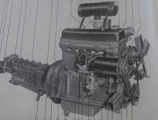

This is the engine that was in my first car. The cylinder mounted on the top of the engine is the air cleaner. It was similar to a silencer but the end was packed with very course wire wool. Periodically the end had to be washed out in a bowl of petrol and allowed to dry. Then the wire end was saturated in hypoid oil and allowed to drain before refitting.
