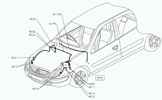

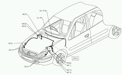

I've had a look Dean and apart from checking the fuses, (check F8 in passenger compartment), I would suggest checking the earthing points - there are 2 for the front lights - MC21 on the left and MC12 on the right - all the earths are marked with M, so might be worth checking all those in the vicinity. Check to make sure there is no corrosion and they are making good contact with the body. Check the wires for any breakages / kinks where possible.
This is the diagram for the earthing on your vehicle Dean: It's always worth looking at the simple inexpensive possibilities first.

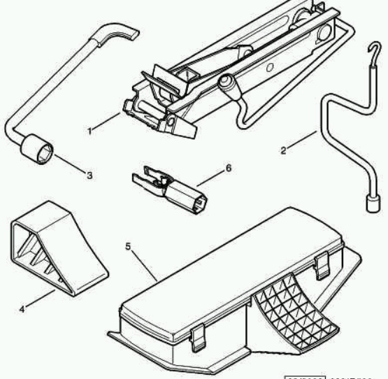

Ok thanks. In the xsara estates or vans there is a side storage locker where the wheel brace/ handle to release spare wheel cradle is kept. Theres another on the other side. There is a round plastic knob that turns to release the locker cover which has snapped the head off. think they are a similar knob in picasso's too.
- x 6960
Re: Xsara hdi indicator stalk problems
This is the only thing I can see...
